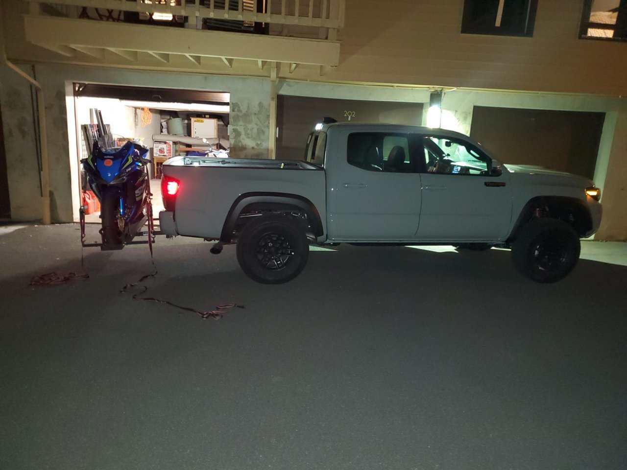

    Was about to post something but found this, unfortunately doesn't look like many people use these. I am probably going to try one out this weekend for a track day and will report back. My truck has the tow package already, carrier weight probably closer to 90 with a 400 pound gsxr 600 still way under the 640 tongue weight.
    with the camper shell you are definitely weighing those springs down quite a bit already. You could add an additional leaf or helper springs from EZ Helper to support that weight.

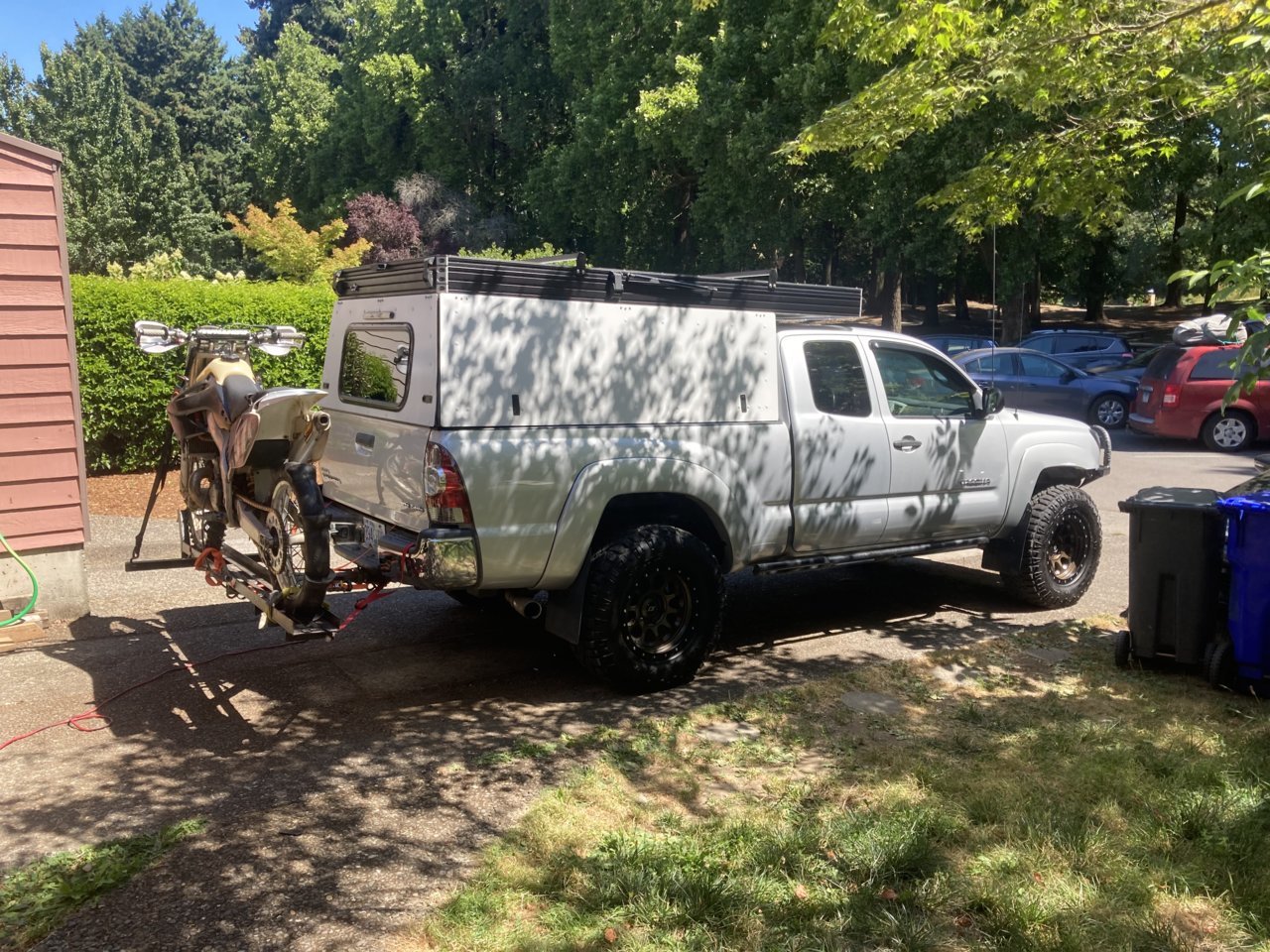

    I carry my Honda cr250 exclusively on a homemade hitch carrier I welded up. I have OME Dakar leaf springs and it rides fine. Would probably be a workout for stock leaf springs but those things are garbage and should be swapped out anyway.
    I’ve driven from North Carolina all the way to Oregon with the bike on the back with zero issues.

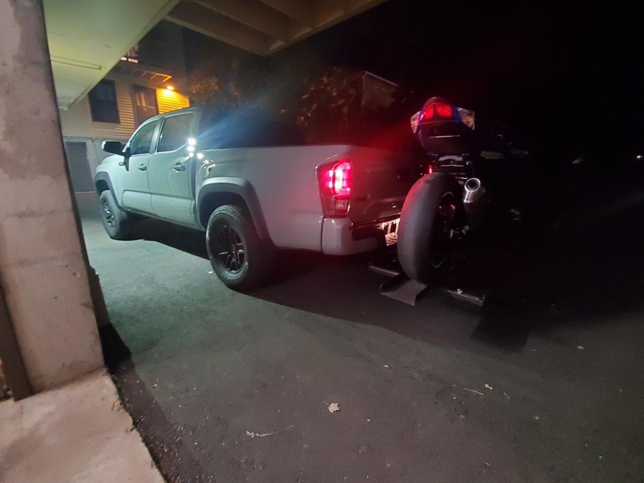

    Going to run this Sunday to Monday for a track day, will let you know how it performs with a 400 pound gsxr 600 on there. This carrier is heavy, almost 100 pounds, removing the loading ramp and putting in bed to save every possible pound lol. I don't think anything over 400 would be safe back there on stock leafs.
