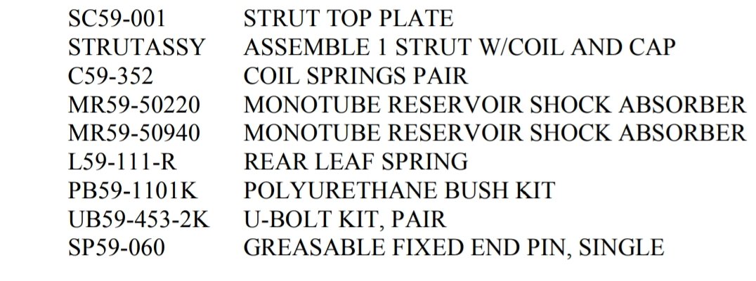

    Dobinsons Suspension 1 year and 18k mile review. I have never done this before so dont flame me to hard. This is my 100% honest review. This is what i have with part numbers
    Part 1: Front
    I have the MRR front adjustable coilovers with remote resi and 730lbs springs. I was very worried when i got them that they would ride hard without any weight on them. I was pleasently surprised that they were soft and smooth. Even now with all the weight i have on them they have a very pleasent and forgiving ride. The longer hose did pose a little trouble for me finding a way to route it and mount the resi where the tire wouldnt eat it, but i soon found a very good place. Ive found that offroad they recover very well after a hard hit or even a small one, they dont ever feel like your about to loose traction or control on any terrian. However one of my biggest problems with them is how hard they are to adjust. They adjust from the bottom of the spring and you have to compress the spring so the seat with move. I have yet to find a compressor that will fit between the coils while they are still on the truck.
    Over all i like them alot. Ive even thought about upgrading from them, but i really dont think it would be much of an upgrade no matter what i put on it. They are rebuildable, they use rubber bushing instead of heim joints for less maintence, and they perform on the same level as kings or icon.

    Part 2: Rear suspension. (Finally)
    So the rear, where to start? Leaf springs.
    There only one way to describe these leaf springs, STOUT! They are awesome. I have the middle of the road Heavy packs. When i was unloaded, before the bumper and extra weight, i had roughly 4 inches of lift in the back. And it road just as smooth as it does now with 550lbs of load in the back. And at 550lbs of constant load im still over 3in of lift. They are simply fantastic. And with their optional greasable bushing bolts i have little to no squeaks. Overall i cant say enough good things about them. Handle well on road and off, have plenty of flex as well.
    No the rear shocks are very good. They dampen well and recover well after a good hit. My only complaint about the rear shocks is I wish they would droop more. But there designed to be run with factory brake lines. So that is a good thing for those that dont want to screw around with brake lines. Overall the complete package is awesome and i see myself running it for some time to come. Hope you liked my quick 1 year review.

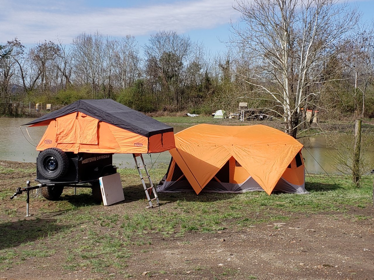

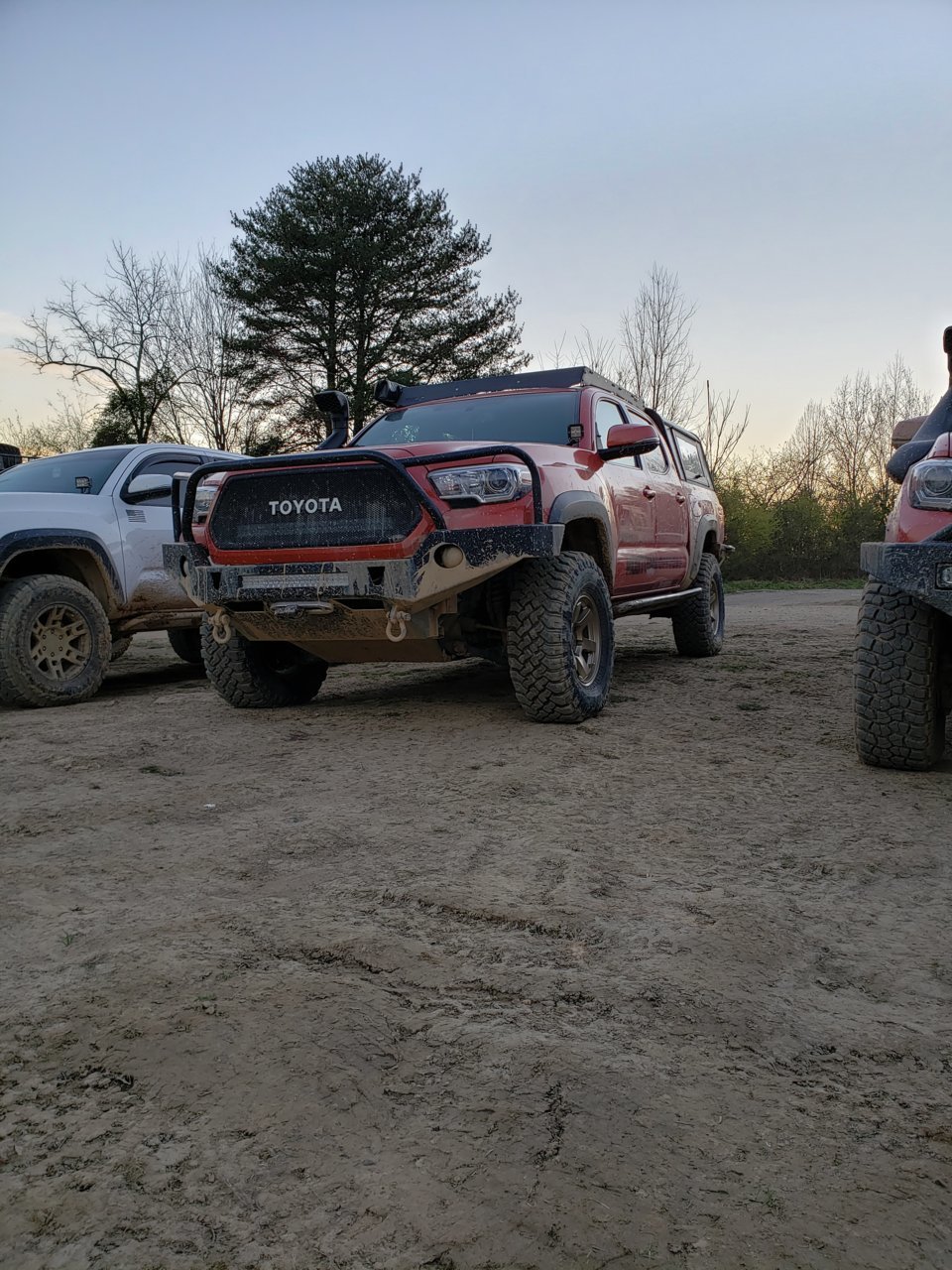

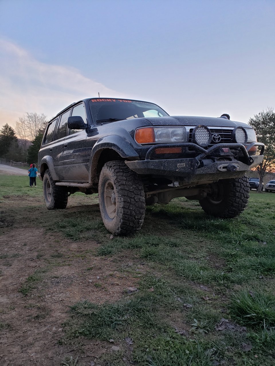

    Shamerock Shakedown 2019. Good times
    @mcharfauros @Mobtown Offroad
    I didnt get many pics but had a blast. Wish some of yall could of been there tho.

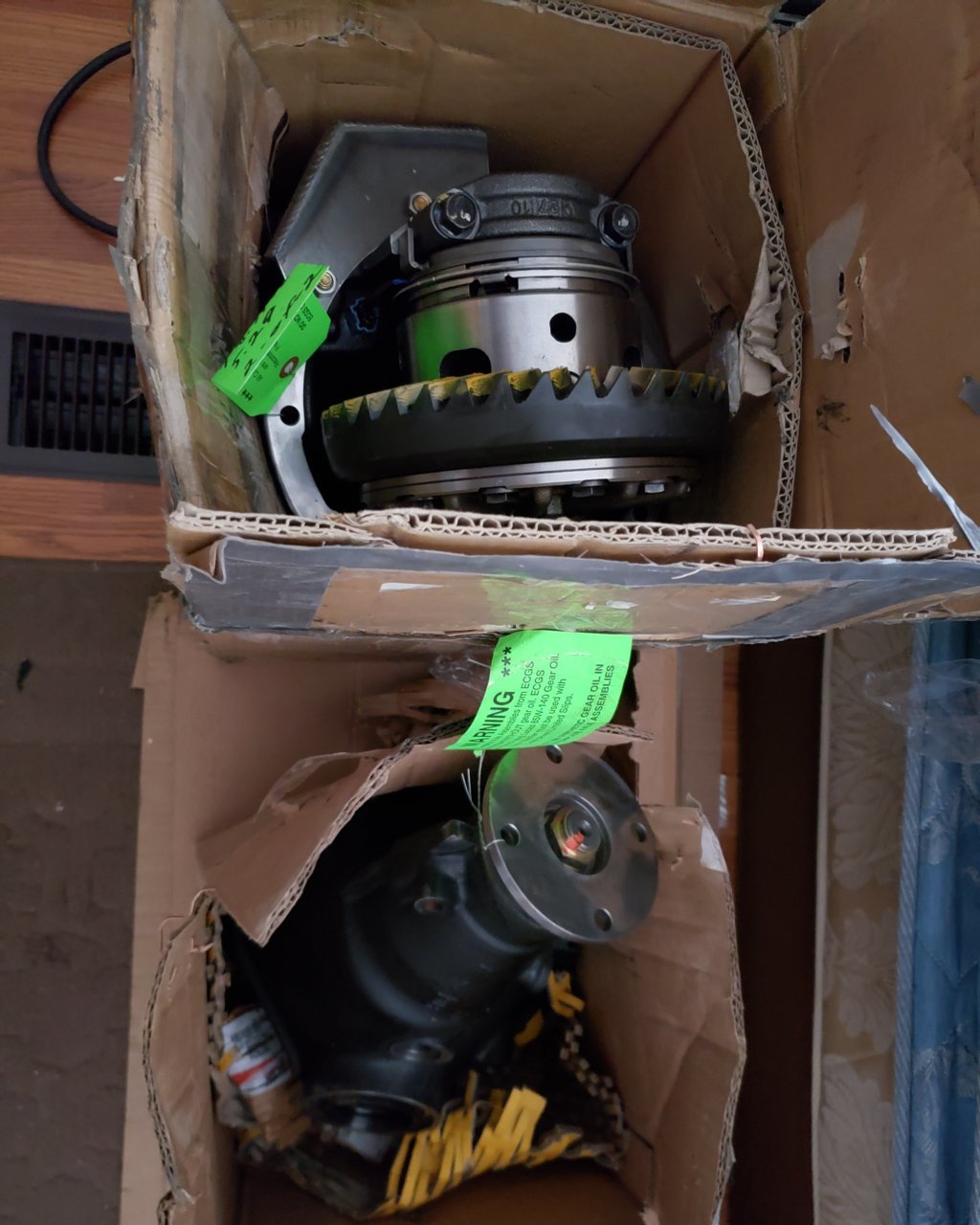

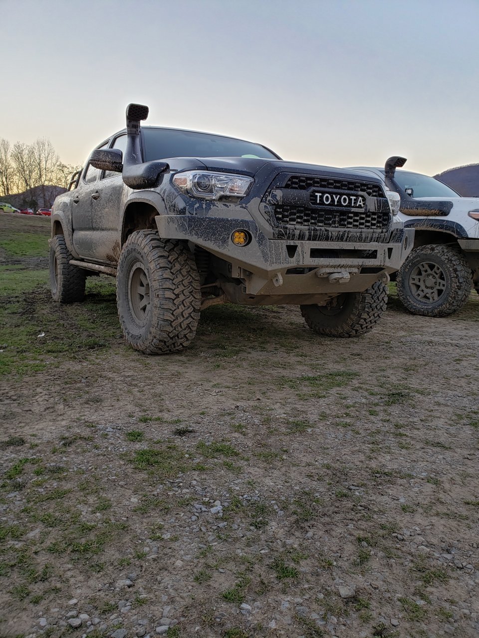

    Gears came in last week. Me, @JBTacoma, and my dad got them installed this weekend. So far i have about 25 miles on them. Major difference already

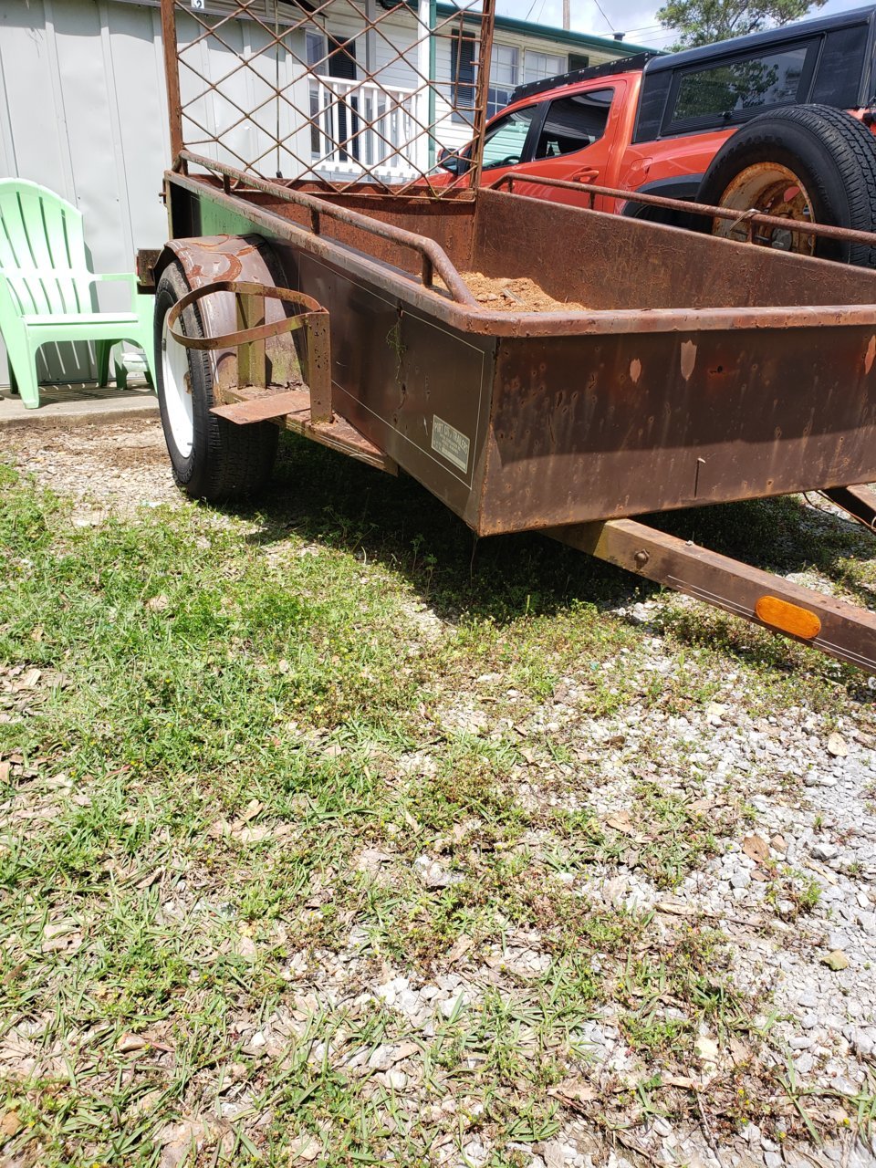

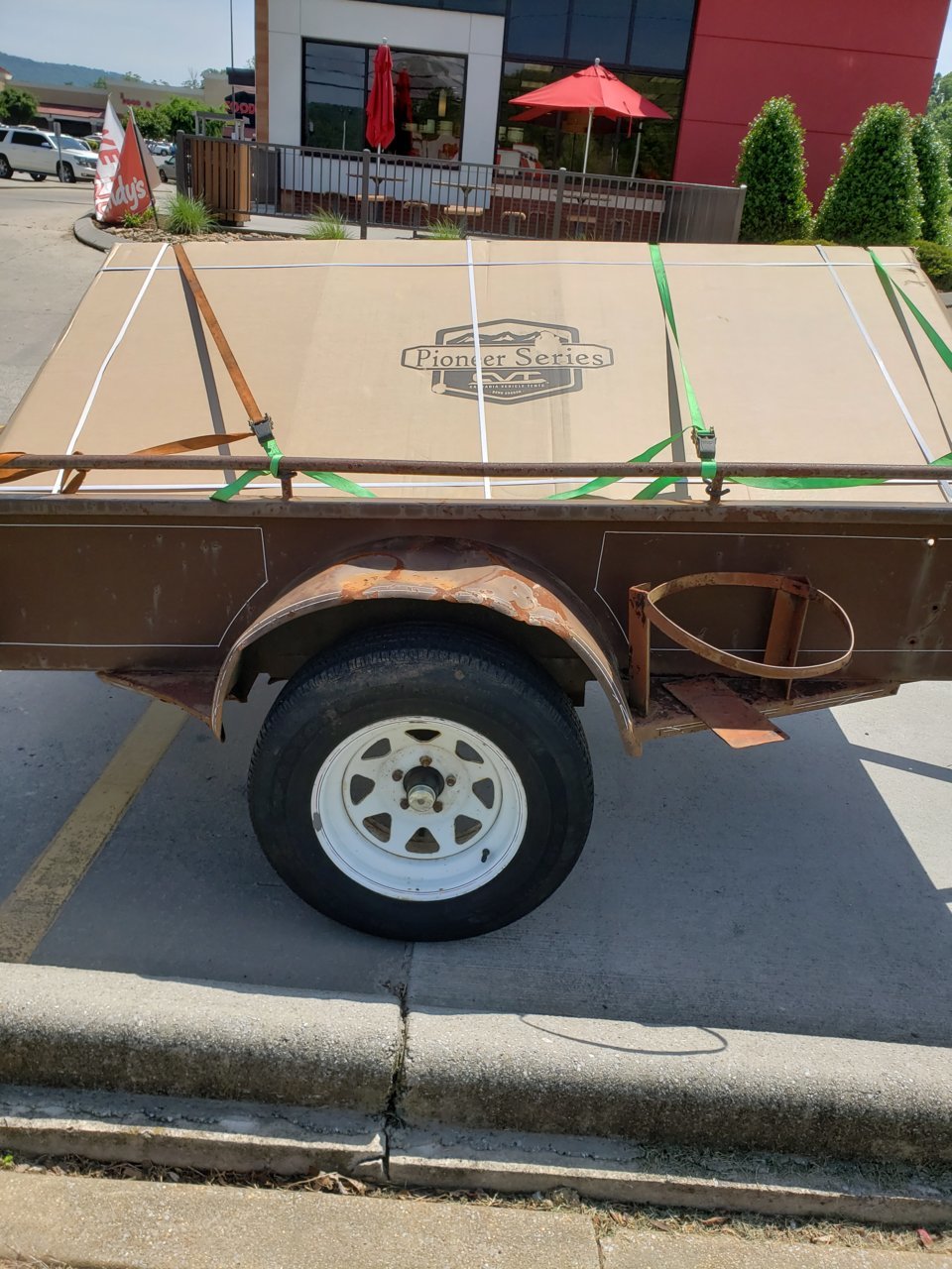

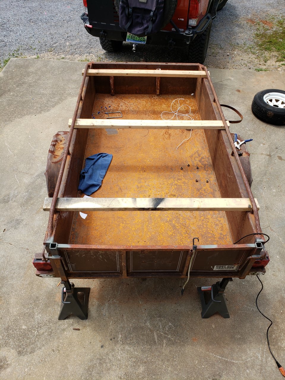

    Picked up a stout little 4x8 trailer today. She needs a little work but im gunna start converting it to an offroad trailer.

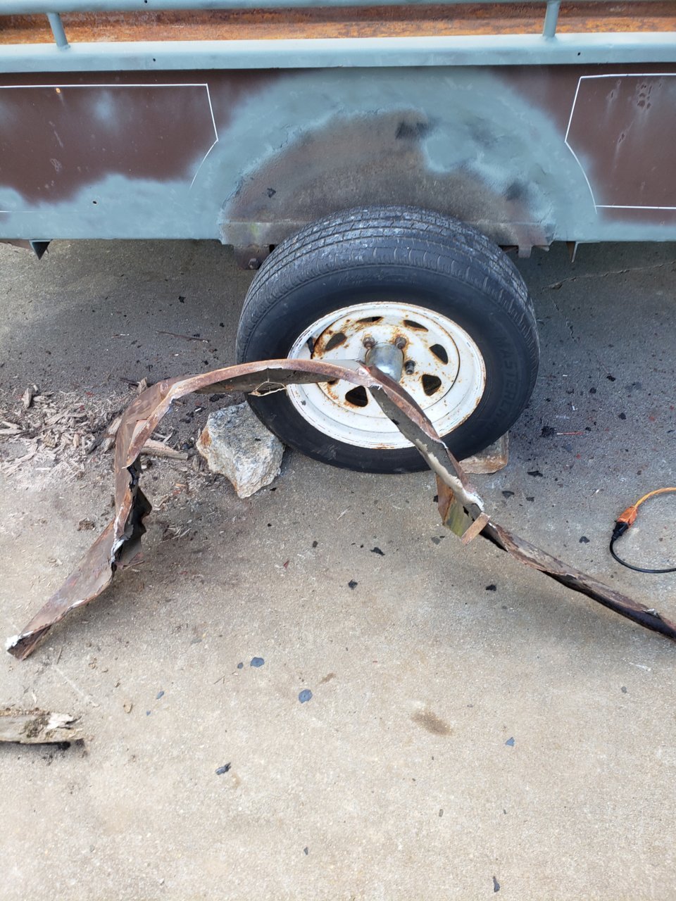

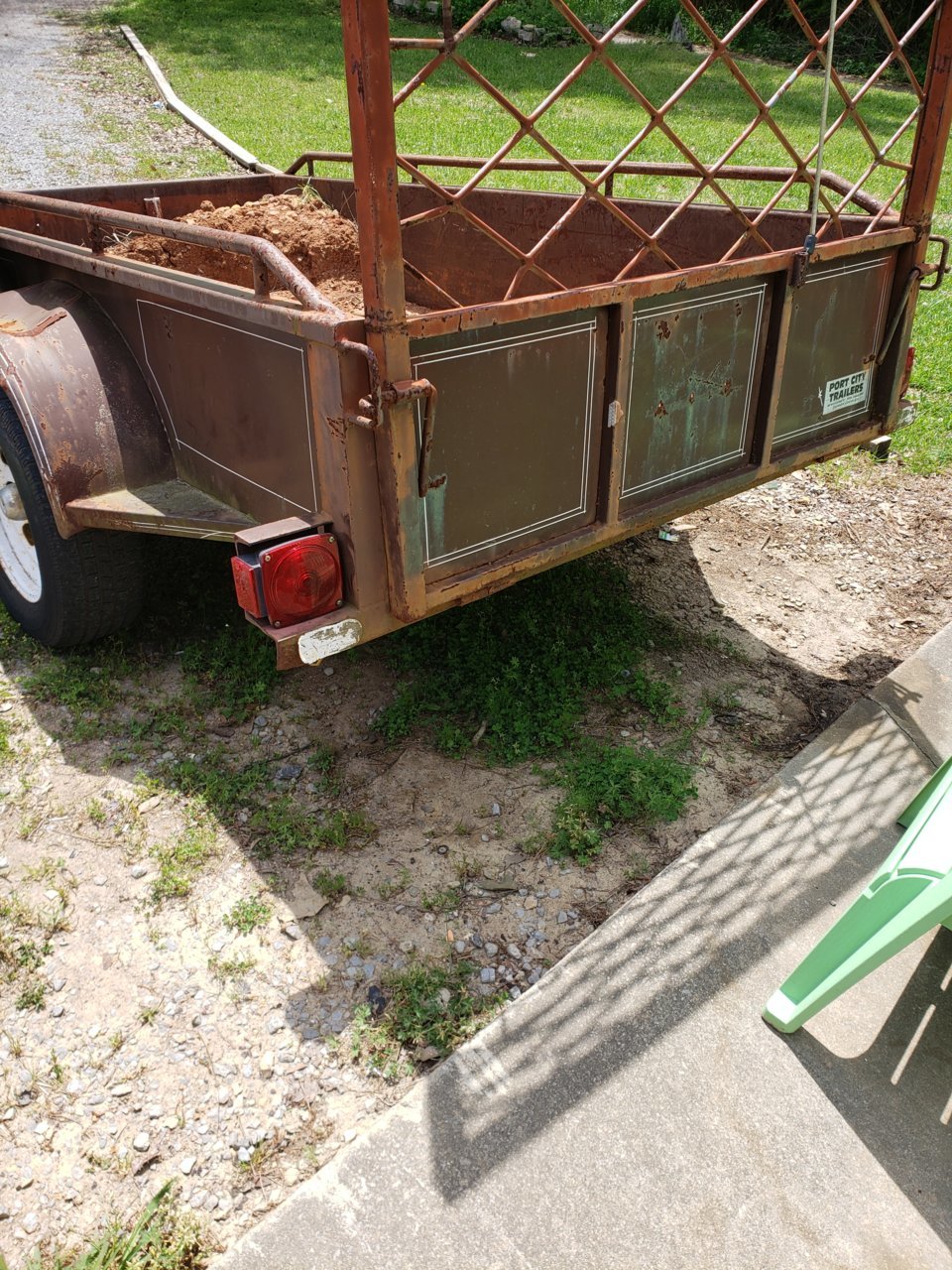

    Picked up a @Cascadia Tents MT Denali from the outlet section. Cant wait to get the trailer done and get it on there.
    Trailer update: gate cut down, lights rewired, axle and shackle kit ordered. Gunna start rust removal soon.

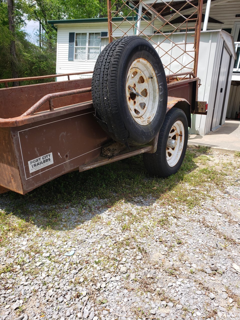

    Gunna get this rust gone soon.

    These fenders are not happy about coming off. Got one off now have to wait out the rain for a day or 2 to get the other. Started descaling the rust as well. Gunna flip it over soon and get it ready for the new suspension set up, and to descale the underside. Got alot of work to do before its ready for our tent.
