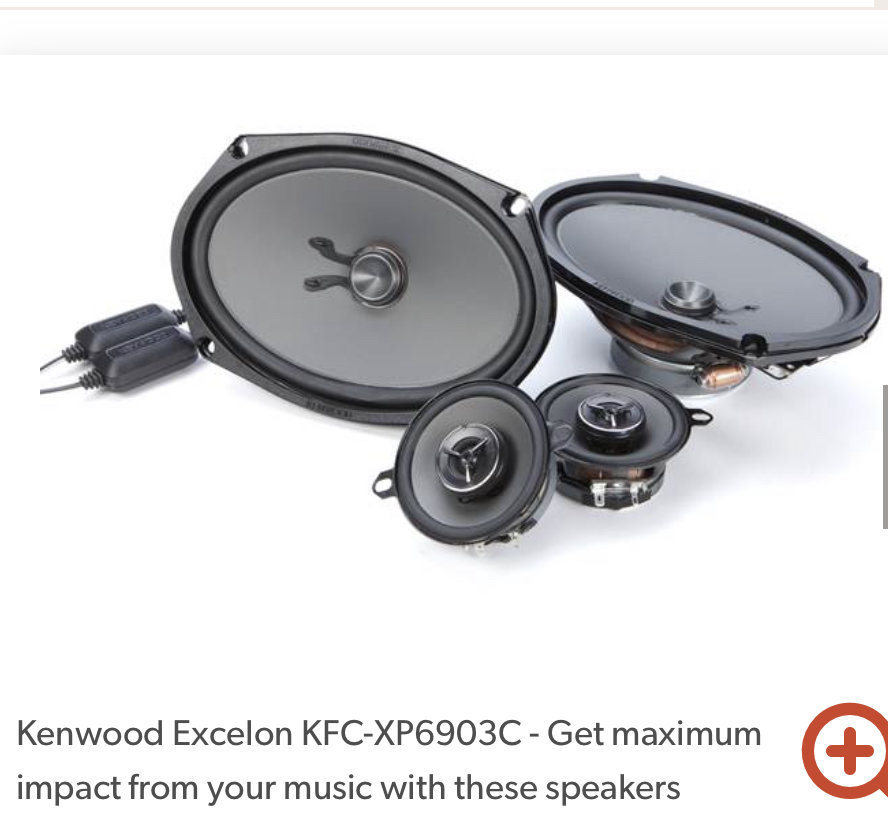

    Hey, y’all. Going to redo the sound stage in the front by pulling the kicker ks tweeters and Kicker CS 6x9s and try out the Kenwood Excelon 3 way components. I’m intrigued by the 3.5 mid and tweeter combo that will sit in the dash.

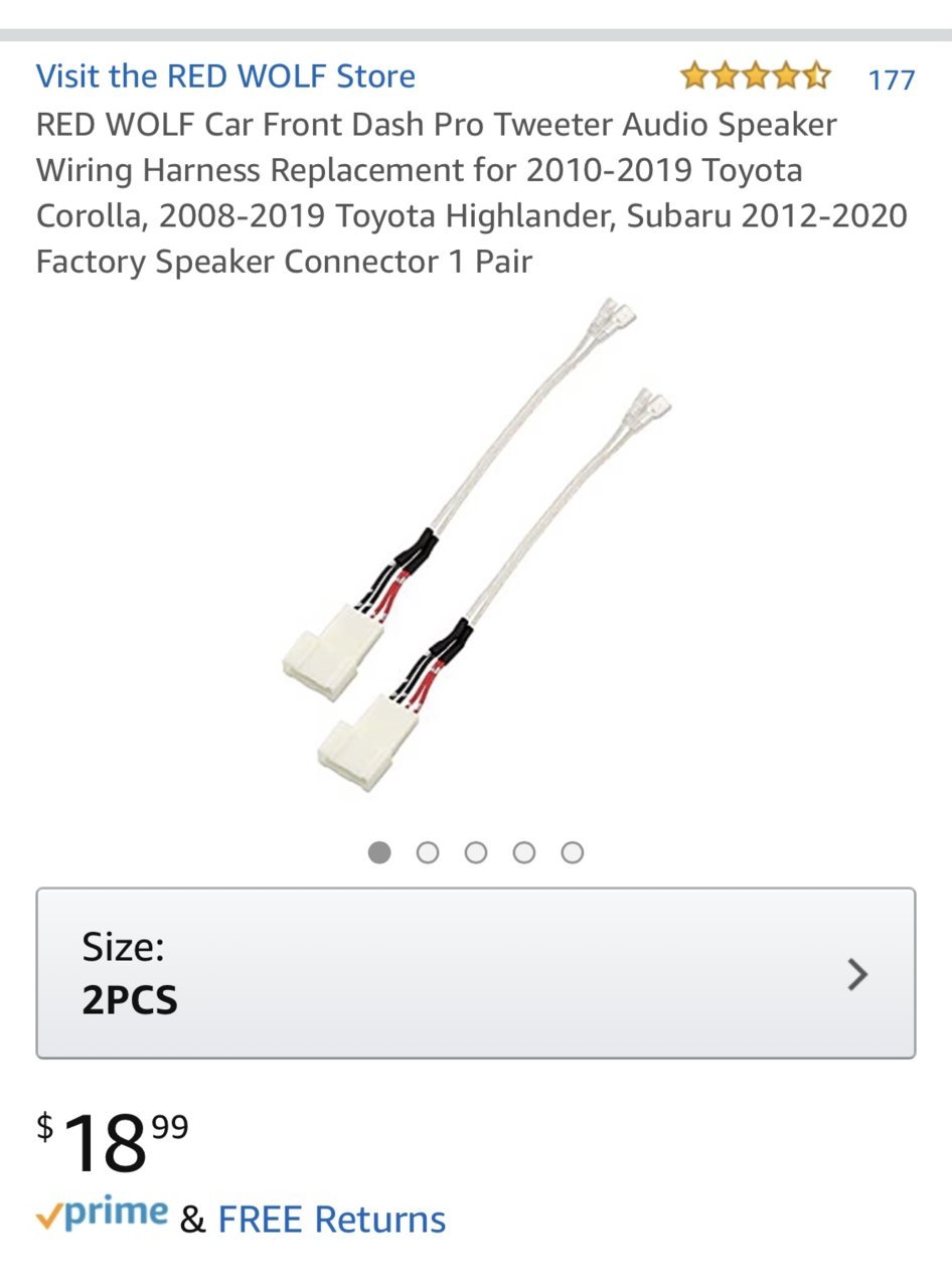

    The tweeters are not plug and play so I ordered these adapters off of Amazon.
    8C5C1F1D-D6EC-4EFB-A70F-01FDC5366743.jpg My goal is to not cut into the wires going into the tweeter harness. Since the tweeters and front door speakers are in line I’m assuming I could tie the two reds and two blacks from this harness into the crossover wires coming off of the mid tweeter combo and plug them into the factory female. Am I off base here?

    using that harness you pictured, you would connect your 3.5"/tweeter crossover to the leads, and then connect your woofer to the factory wiring in the door

    Thanks, @destin_meeks!What I also like is being able to splice everything going in the dash location outside of the truck instead of having to work in that tight corner.

    Everything is coming in Friday. So just want to make sure I have this right. Wire positive coming from crossover into two positive wires from Red Wolf harness. Negative from crossover into two negative wires from Red Wolf Harness. Use Metra harness that is plugged into factory plug in door to connect new woofer. Run key EQ settings again with mic and pink noise. Is that right?

    You wouldn’t really need to cut it down to the two red and two blacks because they’re already spliced to the silver wires. Just connect your tweeter crossover to those

    Gotcha. Maybe attach some connectors on the crossover wires to go into the spades on the Red Wolf then?

    I would cut the spade off and solder if that’s something you’re familiar with

    Ended up going with the kicker ks speakers for the front. Been really happ with them. I’m going to keep the tweeter harnesses in case I ever do decide to go components in the front.
