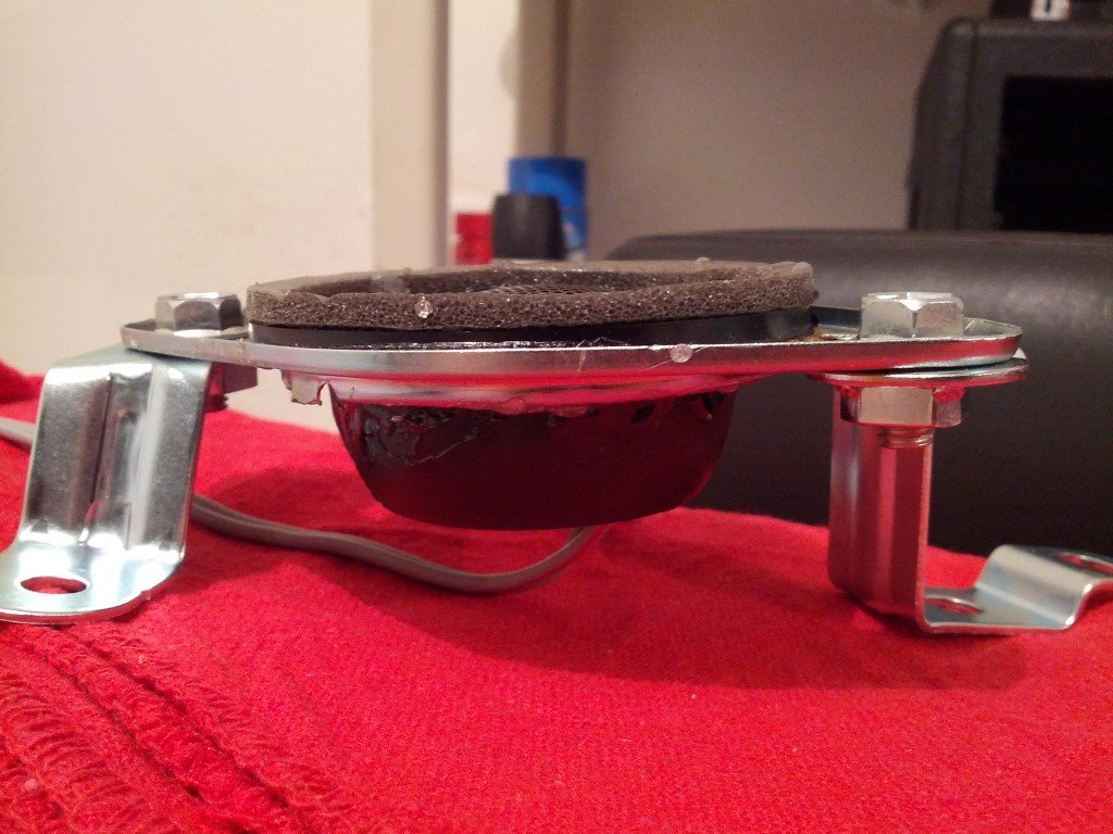

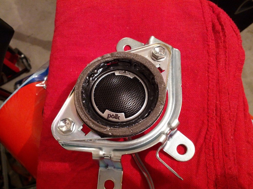

    I cut out the stock tweeter and re-used the stock bracket. Little epoxy to hold it all together, seemed to work and fit well. Maybe not the prettiest, but it's going to be hidden anyways.
    Hope this help.
