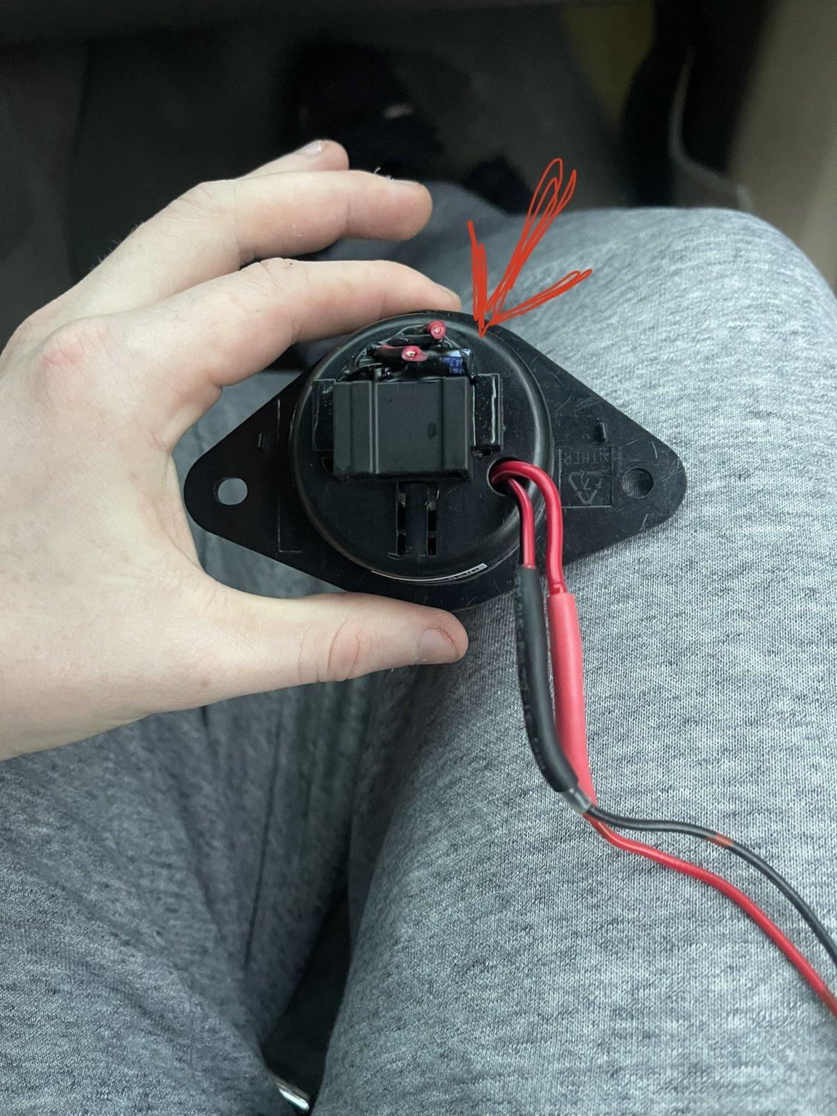

    I have a 2006 Tacoma. I just recently installed new tweeters. I had to splice them with my original tweeters harness. When I increase the volume close to max it wants to crackle. Do I need to let them break in, higher amp, or crossover? The tweeters I got are kicker H631SFJ101

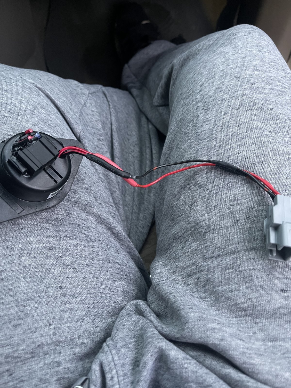

    It is raining right now but afterwards I’ll take the door panels off and send a picture. I heat shrinked the wires. The new tweeters were soldered so I had clamp them and heat shrinked them into the old tweeters harness.

  9. Feb 4, 2024 at 3:18 PM
    2212
    2212 [OP] Member
    Feb 4, 2024
    #443141
    8
    Deacon
    Yeah I crimped the wires then heat sinked to connect them.
  10. Feb 4, 2024 at 3:42 PM
    2212
    2212 [OP] Member
    Feb 4, 2024
    #443141
    8
    Deacon
    The arrow is were I clamped the original wires of the new tweeter. I do not know that much about speakers but where the arrow is pointing is showing a battery. Is that for the crossover? Could that be the reason for the crackle?
  11. Feb 4, 2024 at 4:10 PM
    rnish
    rnish Well-Known Member
    May 9, 2014
    #129450
    8,583
    Peoples Republic of Maryland (USA)
    Tacoma 2nd gen
    King's, Camburg UCA, Dirt King LCA, armor
    I don’t think that’s a battery. Probably a capacitor (blocking).
  12. Feb 4, 2024 at 4:12 PM
    Waasheem
    Waasheem The catholic radio bear
    Jun 26, 2019
    #297494
    2,816
    Waasheem
    2007 xrunner
    Ok, your connections look solid so my theory is out.
    Yeah, not going to be a battery there. I was thinking capacitor too.

  15. Feb 4, 2024 at 4:52 PM
    nd4spdbh
    nd4spdbh Well-Known Member
    Oct 7, 2013
    #114055
    14,583
    SoCal
    13 DCSB TRD OR v6 Auto
    While there is red and black on the tweeter side of the harness as pictured.... check the polarity on the main harness side where that plugs into. Stock they reversed the polarity going to the stock tweeters for more presense/soundstage.
    Needless to say find a wiring diagram of the door speaker wire colors and match them up appropriately to your aftermarket tweeter. You can just pull the pins out of the grey plug and swap if necessary.
