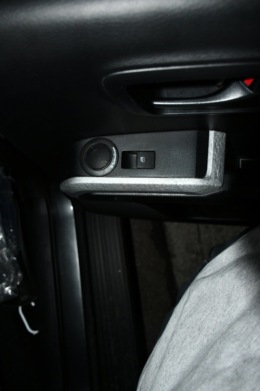

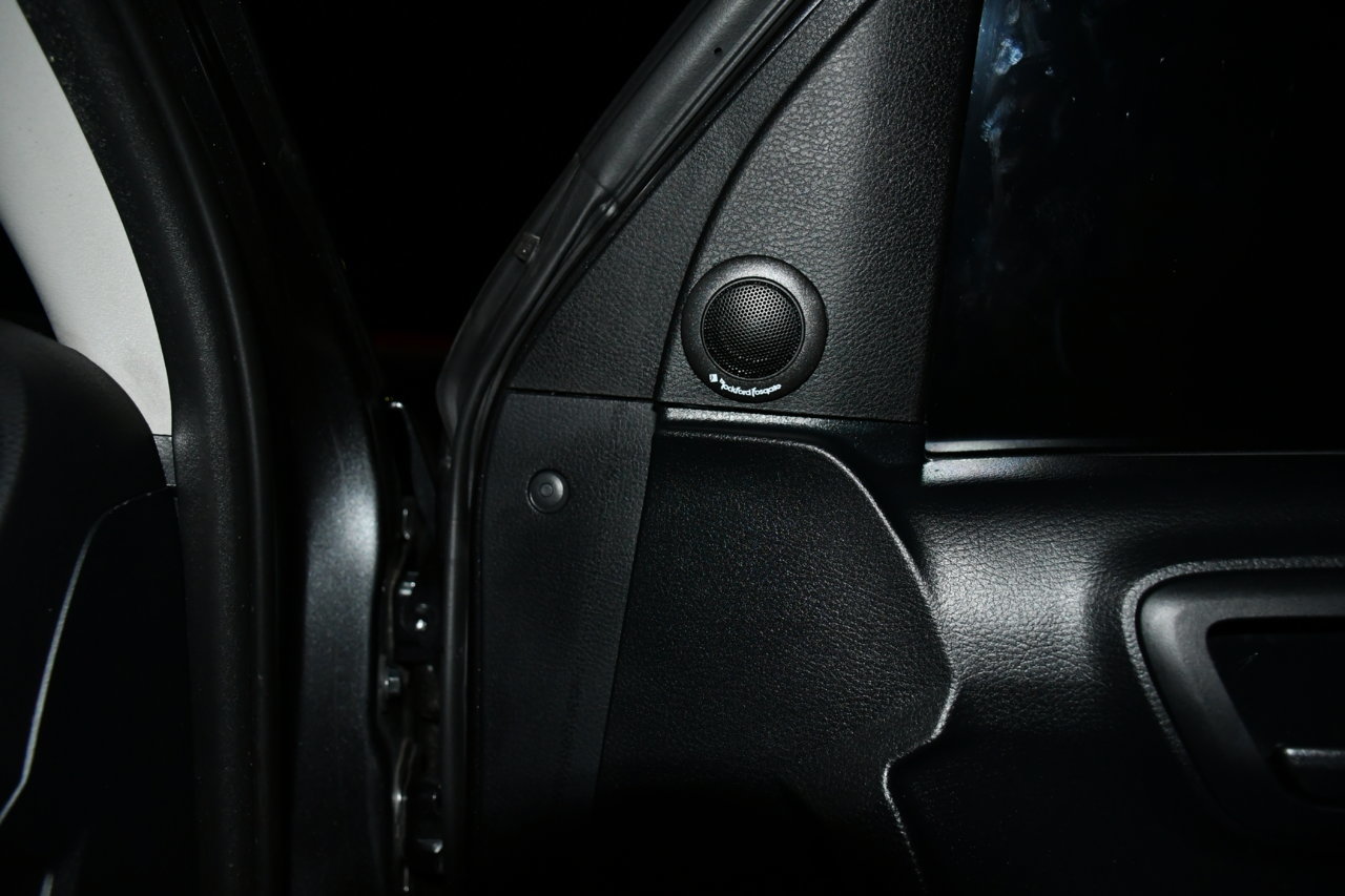

    well i did get a pair of Memphis Audio 2.75 in speakers in today and put them in the factory spot. they sound great and added just enough midrange to the front. i also got creative and installed the 2 sets of tweeters one in the back door and one in the front. i didnt want to cut the actual door panels so i improvised.
