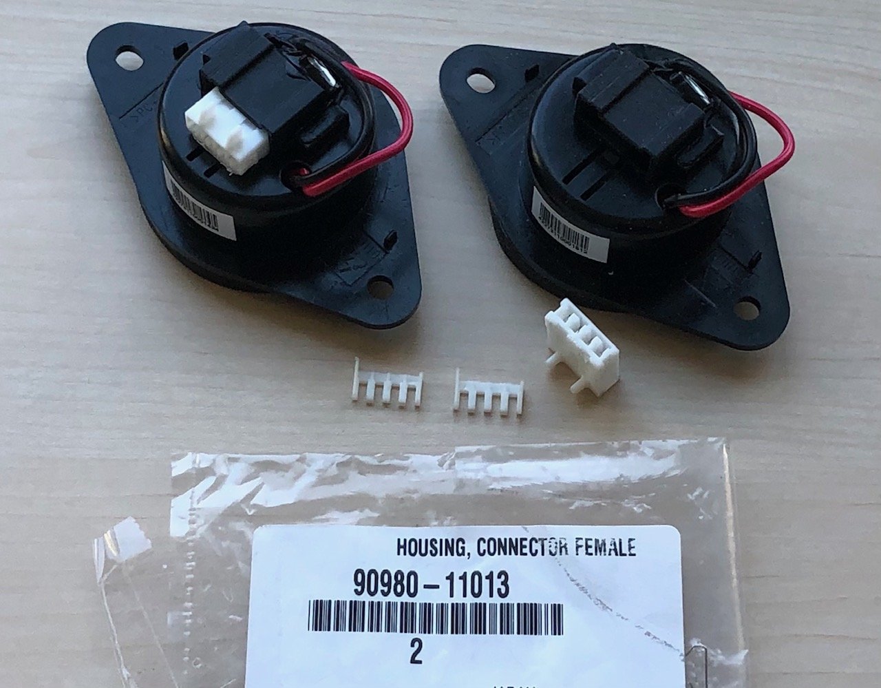

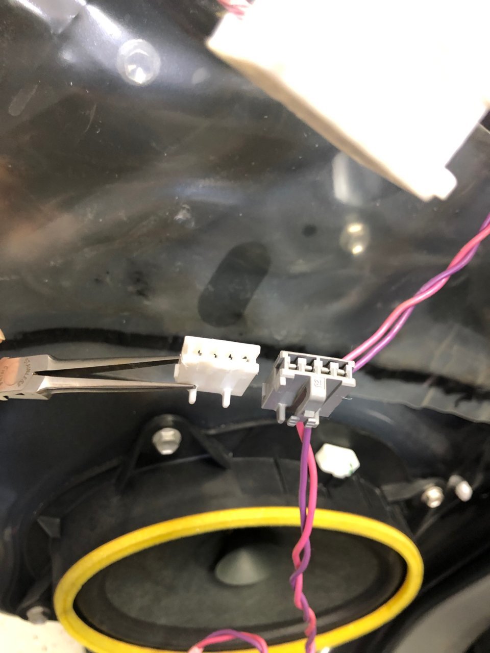

    I just did the Subaru tweeter project myself, plus I swapped out the door speakers for Kicker KS 6x9s in front and 6.5s in back. I know there are plenty of discussions about speaker brands, adding amps, and changing the head unit, but I only wanted new speakers (for now). I went with all Kicker to go with the Kicker tweeters and my already installed Hideaway HS8 subwoofer.

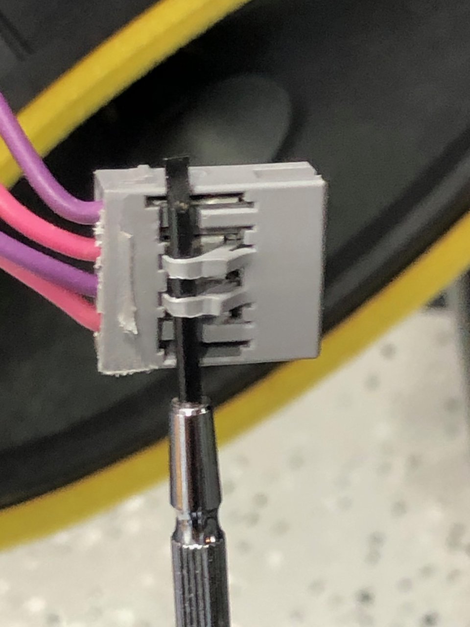

    Mine is a second generation Tacoma - I was nervous about the wire harness modification and wiring pin swapping, so I found the sockets at Toyota and did a dry run ahead of time. This way, if I destroyed a socket connected to the truck, I had spares ready. As everyone said, it was very easy and I didn't need the spare sockets, though I will suggest applying some heat with a hair dryer. That helped make those tabs much more pliable.
    For reference, the socket is:
    Toyota 90980-11013
    "Housing, connector F"
    List price $8.09 each (For me, well worth the peace of mind to have them, just in case!)
    (Photos after shaving off tabs with a Dremmel.)
