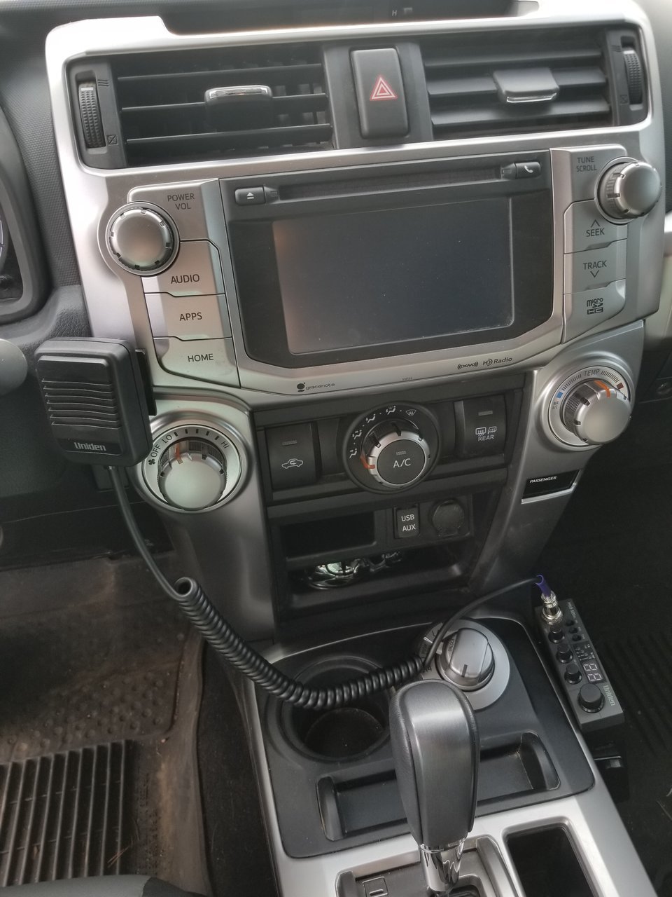

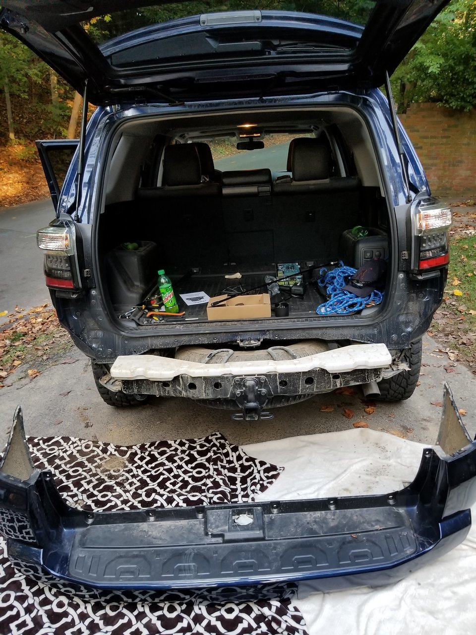

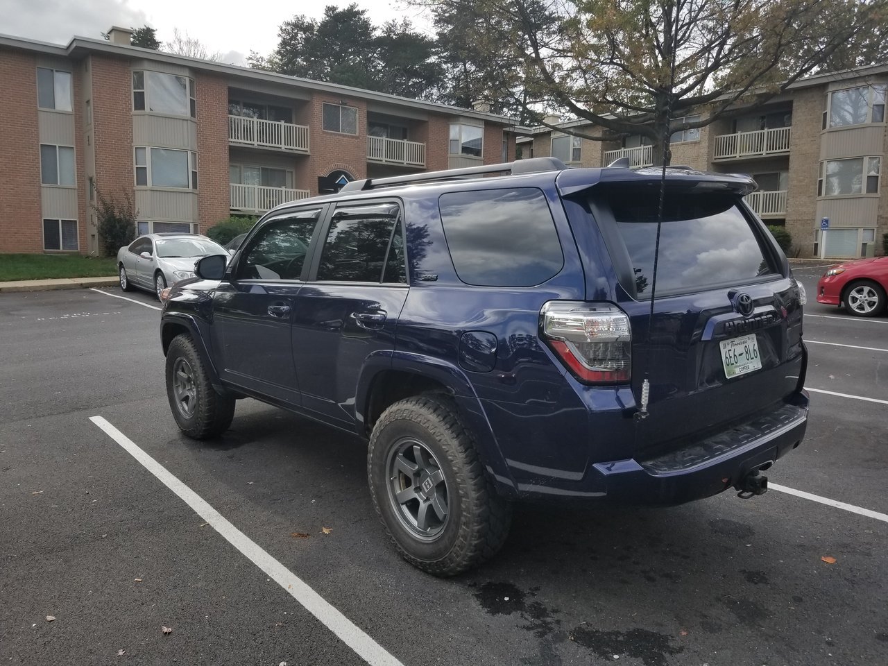

    So this week we went out and installed the CB Radio. I bought the Uniden Pro520XL CB, a 4ft Black Firefly antenna, the Firestik door jamb mount, and the Firestik Heavy Duty Stainless Steel antenna spring. All of this was bought off of Amazon for a total of around $80. The install took us a couple days due to running out of daylight on the first day.

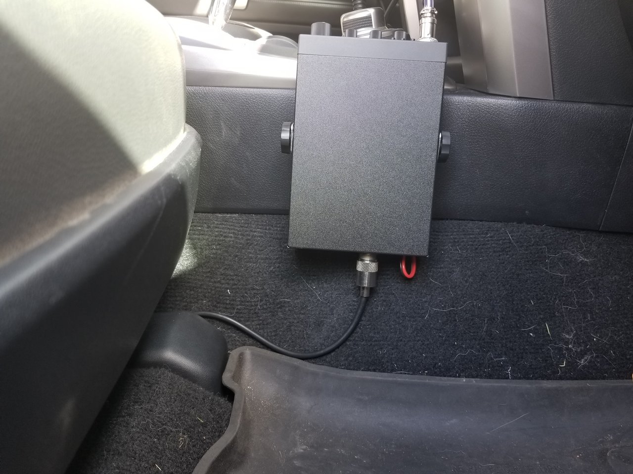

    We started with installing the CB on the passenger side of the center console area. The CB is pretty small and fits really well. The wiring is run behind the head unit to the Driver side and out the firewall through the big grommet. The Mic is attached to the head unit with a small aluminum plate and some heavy duty double sided tape.

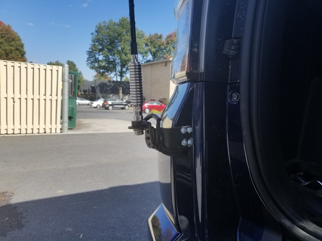

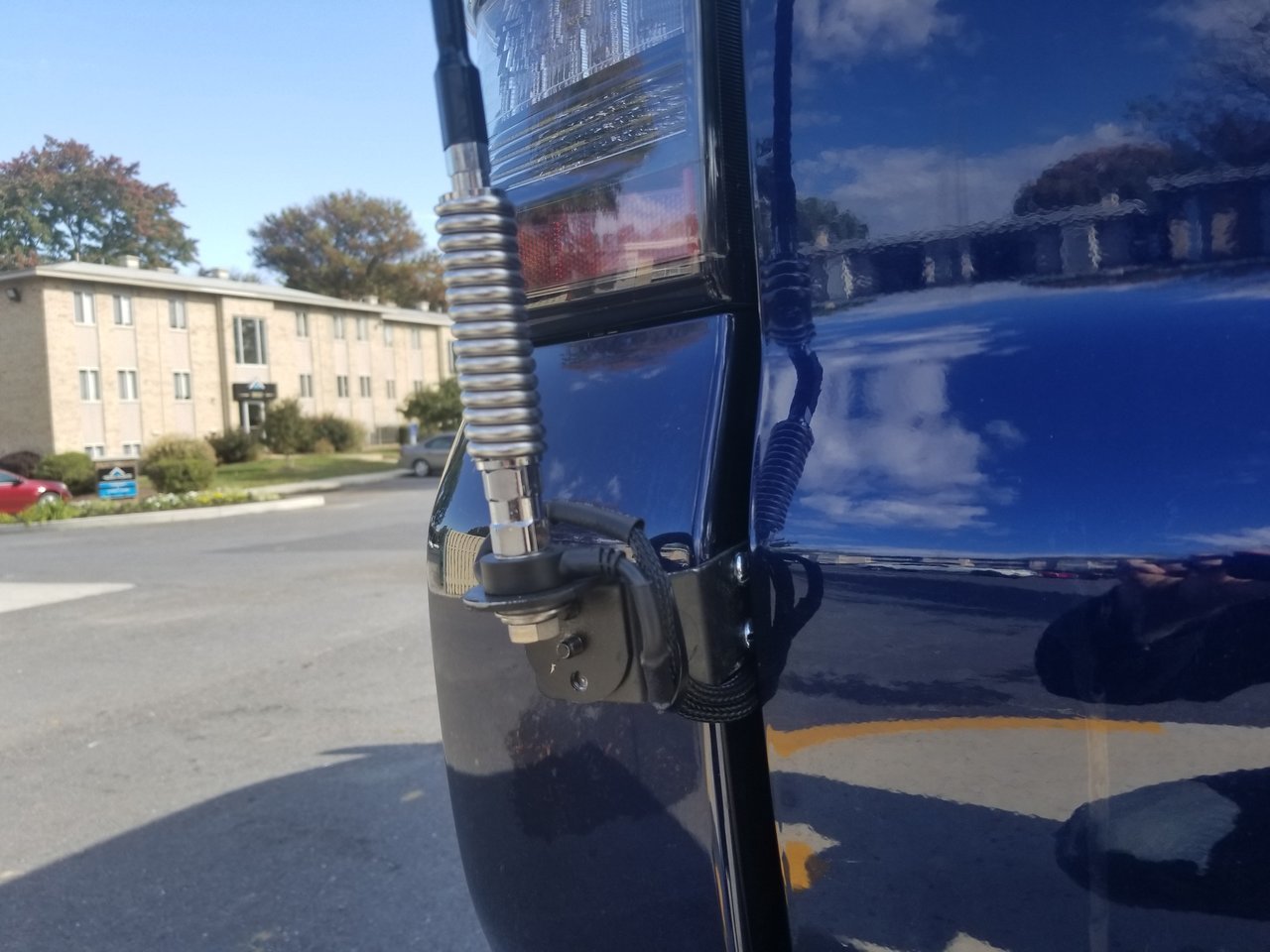

    Then we removed the rear bumper and started installing the antenna mount to the bumper. We drilled 4 holes in the bumper for the screws with an extra hole below for the wiring to go through. We also ran a ground wire from the antenna to the frame since the bumper is plastic and not a good grounding plane.
    Everything cleared on the rear hatch with very little room. The antenna is angled back as well so the hatch doesn't hit it when it opens.
    Overall I'm happy with the CB and antenna mount. We were able to get it all working on the first try and were able to communicate on it just fine without much tuning.

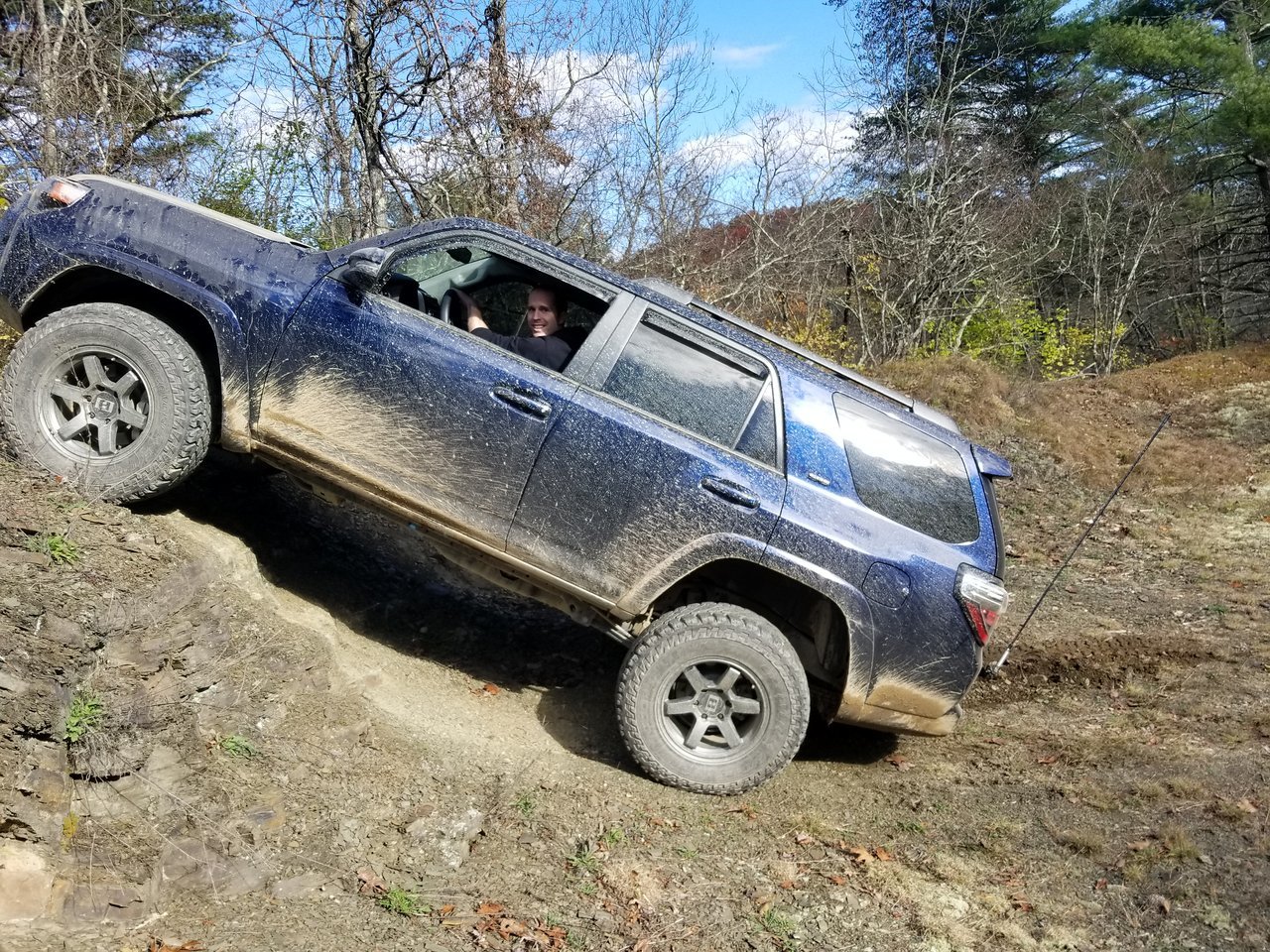

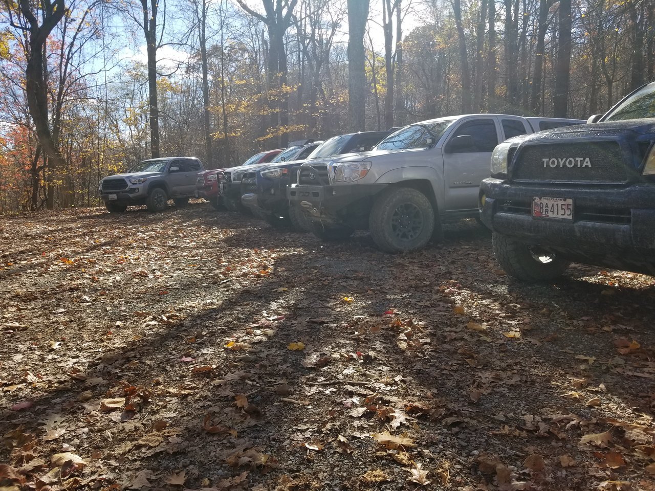

    Today I went to Green Ridge again with some guys from work and a couple others. Finally worked up the courage to do an obstacle that I've really been wanting to do. Also was a good chance to get a couple guys used to being in their trucks off-road.
    Surprisingly enough, the only thing I was dragging was the Fuel Tank Skid plate. Nothing else touched.
    Nice little victory shot with @AR15xAR10 in the way.
    Video:
    And a couple shots of the trucks:
    From left to right: @ELTACO13 @Montauk17 @EatSleepTacos Me @buyobuyo @AR15xAR10
    Overall it was a good day.
