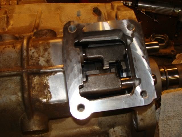

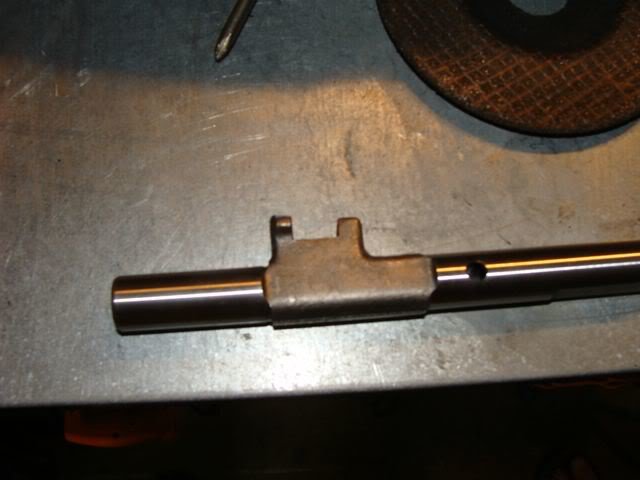

    OK.... Lets get into the 05+ tacoma t case and the FJ Cruiser t case.
    First, the FJ Case.
    As you look down into the case from the shifter spot, you'll notice that there are two separate shift rails in there. Both have a slot for the shifter to go into but one has an extra nub if you will at the very end. This is the hi/N/lo shift rail. The other one is the 2wd/4wd shift rail.
    Now lets look into the same shifter hole in the 05+ Tacoma t case. Notice that there is nothing there except the planetary gear set. No shift rails or slots for a shifter to go into.
    So lets look at one of the first statements that is not really correct.
    Quote "The "twin stick" type of modification could be done on the Tacoma case like this: The same "cut" made to allow the two shift rails to operate independently of each other would leave only the 2/4 shift on the existing servo. The back of the case would need to be drilled to expose the end of the H/L shift rail, which could be drilled and tapped to allow the connection of a pull/push cable (or a rod extension).

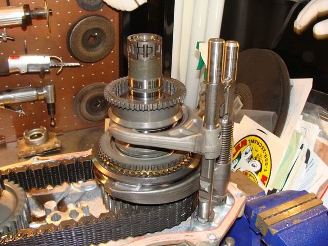

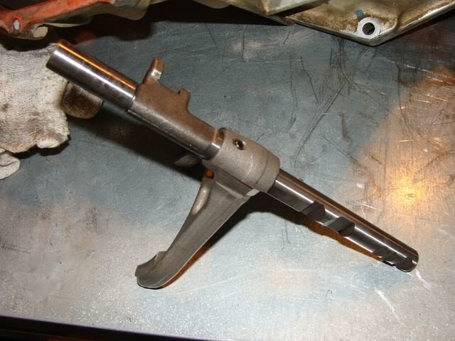

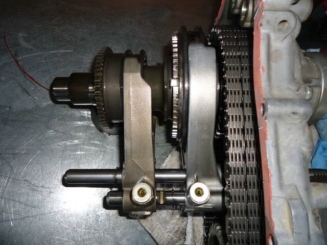

    There is only one true shift rail in the 05 + Tacoma t case. That is the long rail shown in this picture. You can see that it protrudes from the rear of the case and is activated by the actuator at the rear of the case. The other rail is a stationary rail that is an indent positioning rail. It tells the servo to "stop here" for 4wd and to "Stop here " for 4lo. It cannot move back and forth no matter what you try to do to it. It's design is to simply keep the shift fork in position.
    Now lets look at another statement that will get folks into a world of hurt.

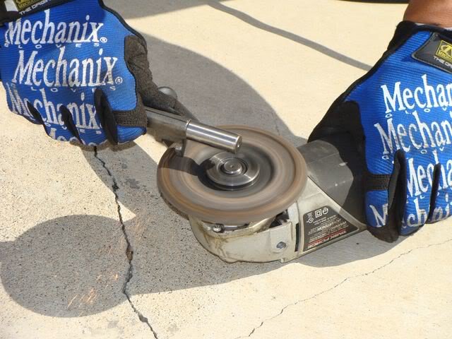

    Quote "As far as the "internal modifications" go, it is a matter of grinding off a piece between the 2/4 and the L/H shift rails, to allow them to operate independently of each other. In some cases, it is also necessary to replace the input shaft with the one that came from the target truck."

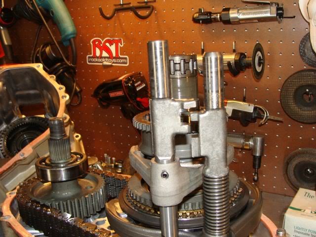

    Lets look at what really needs to be done to get these two shift rails to function independently of each other.
    Here is the FJ T Case split in half. You are looking at the two shift rails and forks. The shift rail closes to you is the hi/N/lo shift rail

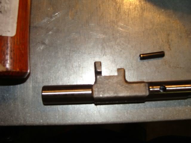

    A closer look and now you can see the hi/N/lo shift rail on the left and it has a protutsion at the end of the shift rail slot. That is what will be ground down but this alone will not allow you to shift them independently of each other. We'll get to that later.

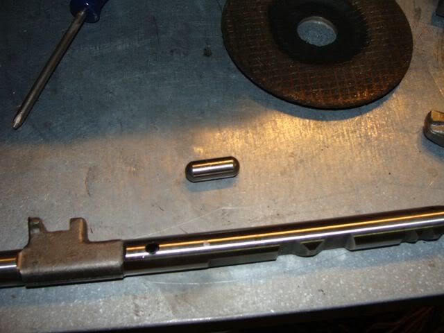

    We then take the hi/N/lo shift rail off and grind that appendage off.
    But thats not the only thing that is done.
    At the rear of the case there is a "pill" that needs to be taken out to separate the two shift rails so that they will function by themselves.
    Now... Toyota put those two items, the pill and the extension of the hi/N/lo shift fork for a very good reason. With those two items now missing, the t case can shift by itself from hi to neutral or from lo to neutral leaving your vehicle to roll freely. Imagine that happening as your wheeling up that long steep slope and you hit a small bump and your t case pops out of gear. I've seen this happen and it's not a pretty sight. Now when this happens, you cannot just throw the hi/lo shifter into one of the gears. You must come to a complete stop, put the transmission into neutral, and then shift the t case back into hi or lo gear from neutral. Why is this you may ask??? Because there are no synchro's in the hi/N/lo gear set. That is why you must come to a complete stop to shift the stock Tacoma case as well. Marlin and I came up with a fix for this in the form of a spring that keeps the hi/N/lo shifter in it's position.
    Now lets move over to the Tacoma case.
    You cannot "split" the hi/lo 2wd/4wd shift rails on the Tacoma case because they do not exist. there is only one shift rail that controls both of them and it simply moves back and forth. Now I only know of one person who has done a manual shift for this case but in my opinion it's not a good option for a number of reasons.
    One. To do this you would have to remove the actuator and on the end of it that goes into the T case there is an oring that keeps oil from coming out of the rear of the case. Oil flows from the case into the geared portion of the actuator to lubricate it. That would take some machining to come up with something to take care of that situation.
    Then there is the shifting mechanism that you would need to fabricate. Keep in mind that some of the issues with this case is that that very shift rail jams and is the cause of some of the actuator failures. I've tried to manually move a jammed Tacoma shift rail and it took a hammer and a pair of pliers to do it.
    I think this is a poor design and is prone to failure when used by wheelers.
    I also feel that the FJ Cruiser conversion is the best fix for this issue whether I do it or someone else does. Thats why I posted on both this site and mine on how to do it.
    There are reasons why Manufactures build their products a certain way and as you modify that product, it would do you and others well to fully understand why they did so before you change what they spent millions of dollars on designing. Remember, "If your going to build a rig, build it as if your loved ones lives depend on it"
    burntkat likes this.
