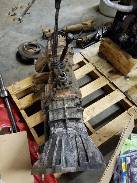

    When I saw his t-case picture in the manual thread, I got all excited that he was putting it in his 3rd gen...

    This is what you need.
    23 spline toyota gear driven tcase, then contact marlin crawler for the dual case setup, though I'd look for it used myself.
