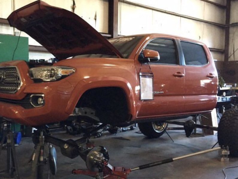

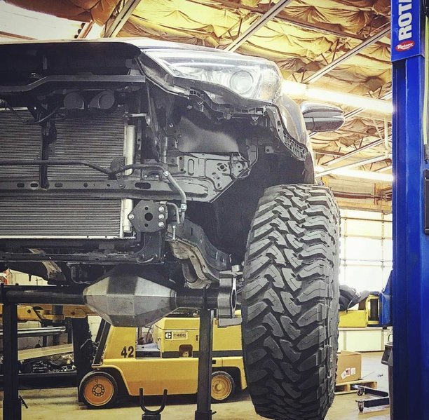

    All pro 3 link SAS kit, Diamond axle, kings on 37" MTR/K
    Yes, but I'm just saying since people keep mentioning duals when op only asked about manual t case with twin sticks.
    I have the FJ case in my 2nd gen with twin sticks. Didn't want to do duals or a crawlbox because the low range seems low enough with the torque of the 4.0.

    I'm well over $10K just in the front. Just spent $4k in wheels and tires too. Once the front is done, gonna get a beefier rear.

    Looks amazing, but aren't the 2nd and 3rd gens a bit heavy for birfs and toyota style axles. Should've rockjocked :eek:
