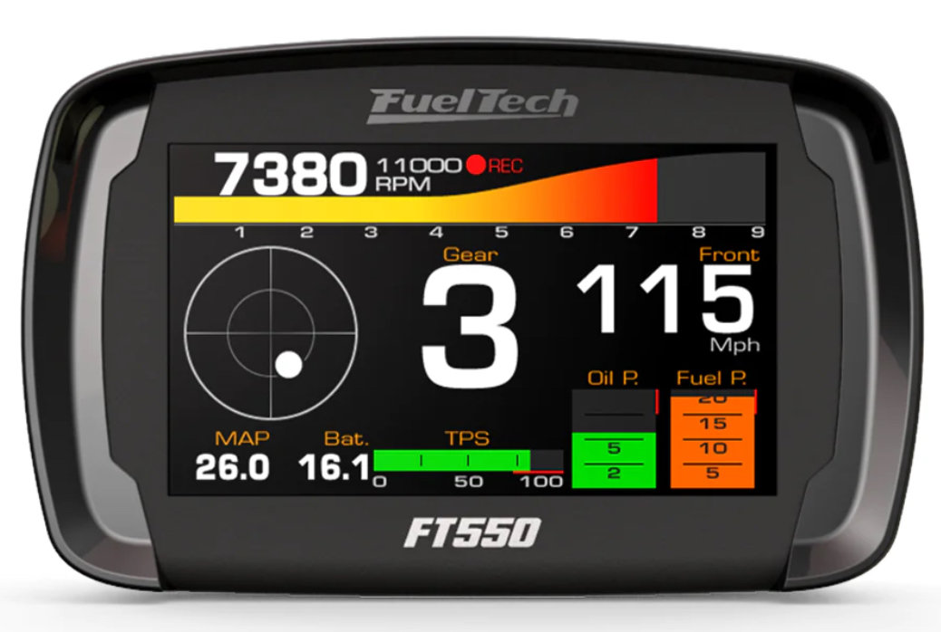

  14. Apr 5, 2024 at 4:39 AM
    #54
    Hiilux
    Hiilux [OP] Well-Known Member
    May 9, 2021
    #365167
    69
    E
    1976 hilux 1gr engine
    Twin turbo
    Thats good I went with Fueltech because of the integrated screen.

  17. Apr 5, 2024 at 7:14 AM
    #57
    Hiilux
    May 9, 2021
    #365167
    69
    E
    Twin turbo
    Yes all your info is in screen and the newer one you can program from it the FT700IMG_1640.jpg

  19. Apr 5, 2024 at 7:17 AM
    #59
    Hiilux
    May 9, 2021
    #365167
    69
    E
    Twin turbo
    Haltech is a separate screen in the case of fueltech that is the ECU. Also fueltech can be submerged in water Ip67.
