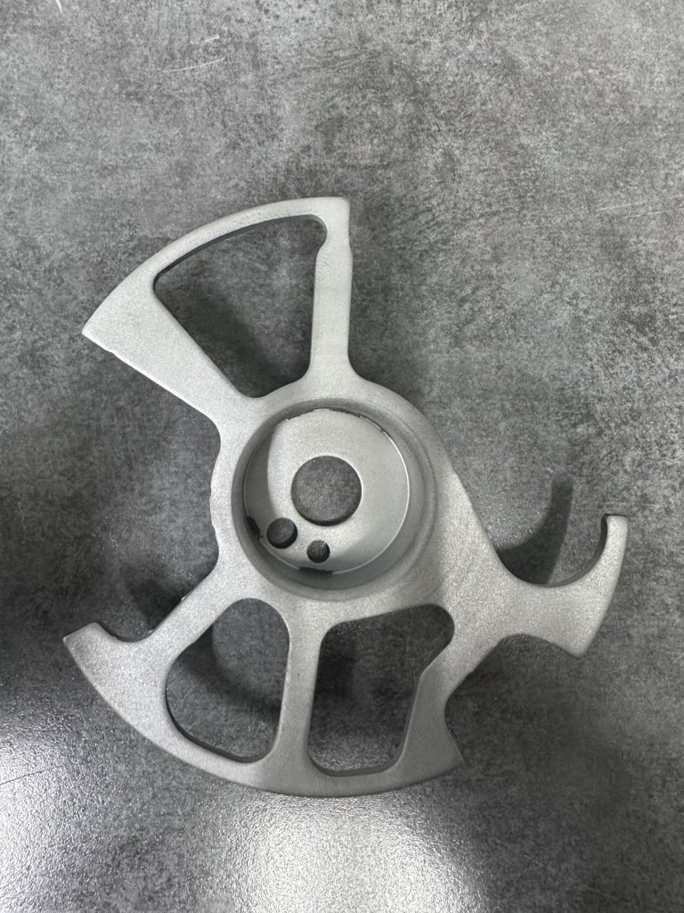

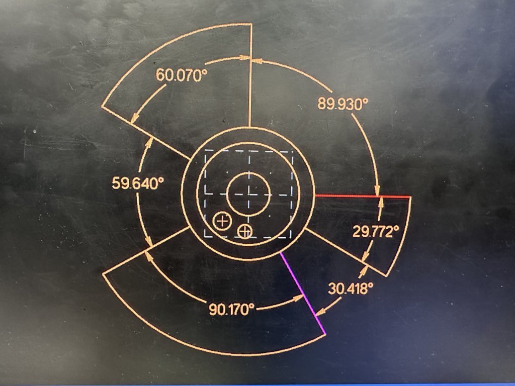

    I had the cam sensor pick up sprocket scanned and this is what it came up.

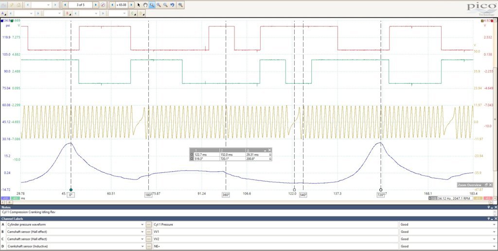

    Finally got around to it, looks like cyl 1 TDC is about 200 degrees past the center of the sync notch or 20 teeth after the last missing tooth.
    Taken at hot idle.
