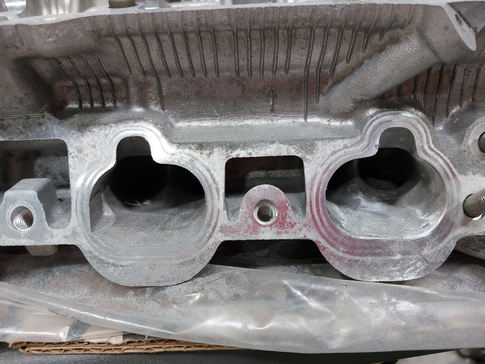

    Those water passages look nice!

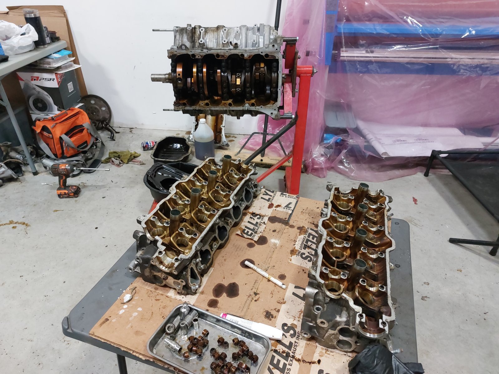

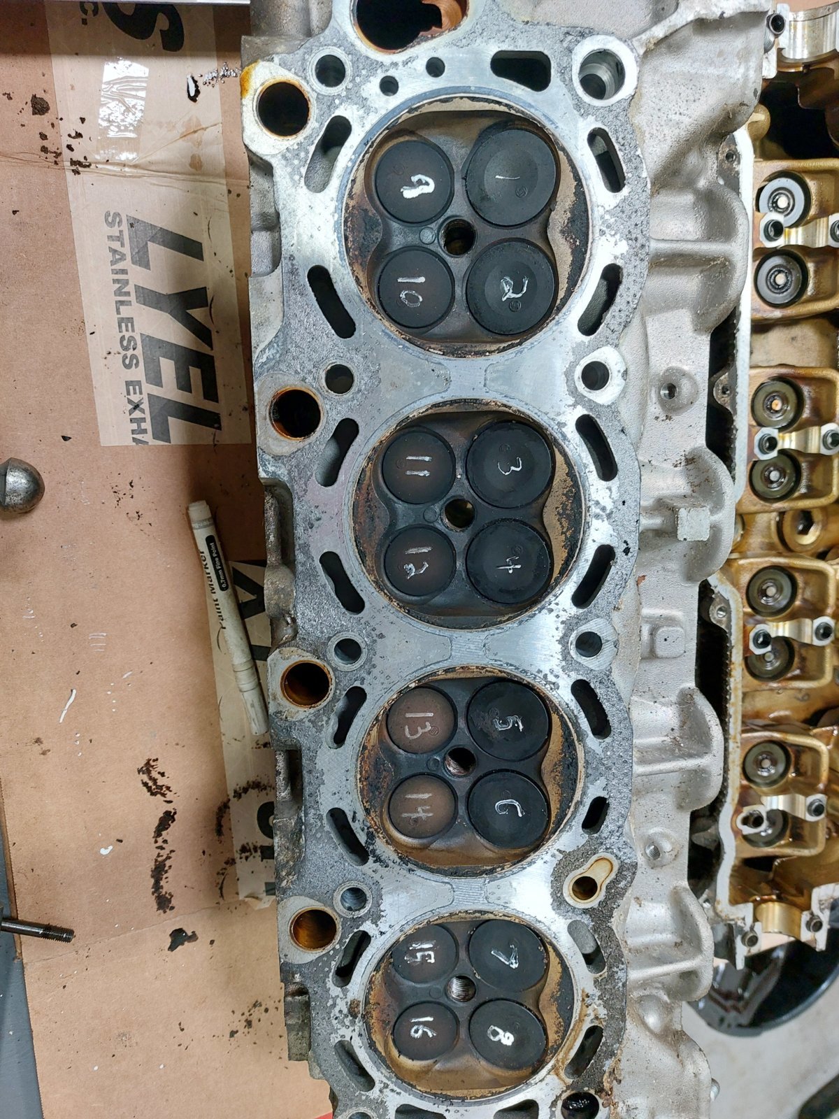

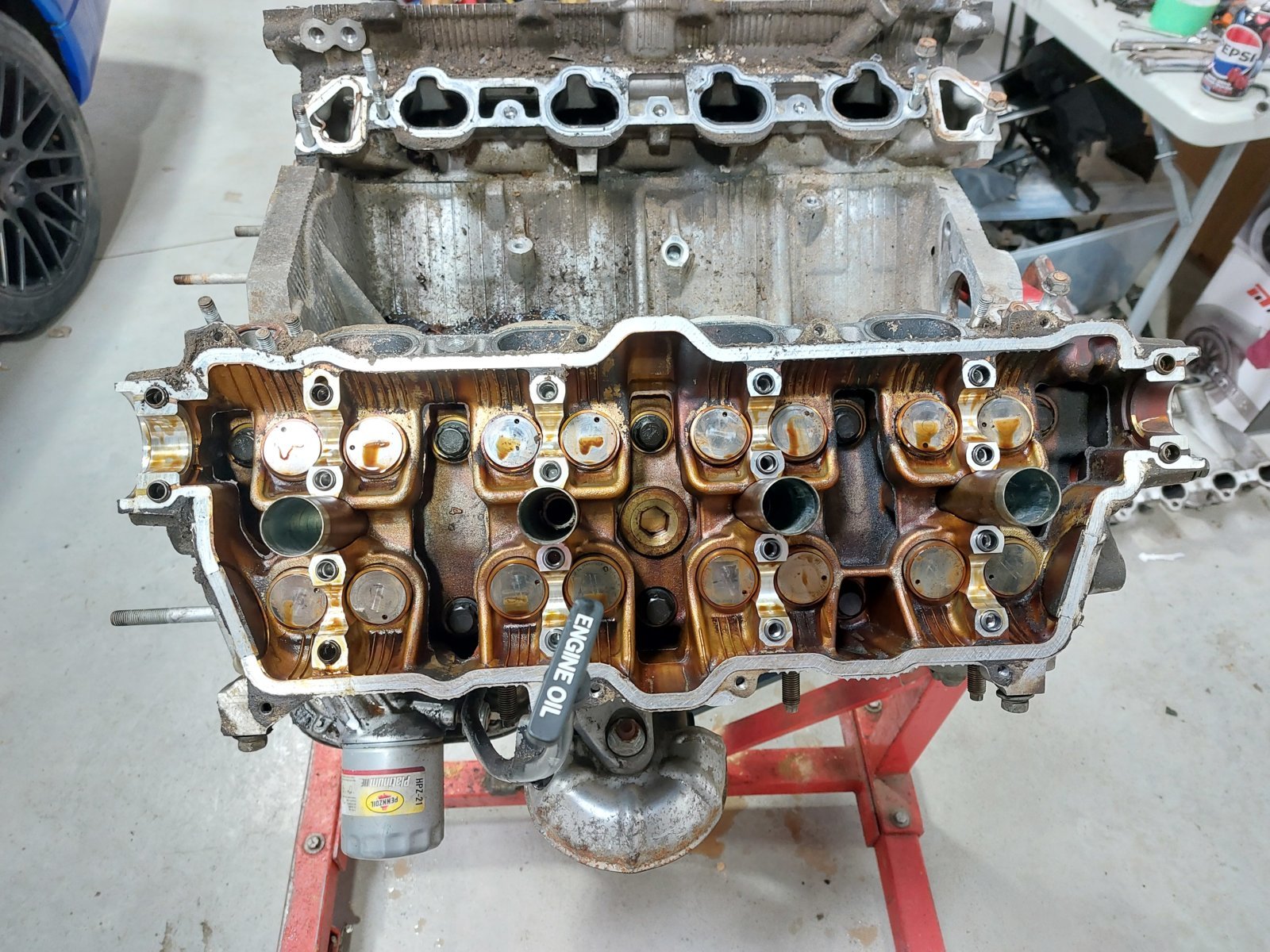

    Close to pulling the heads off now!
    This also looks good, the shims still have their machine marks.

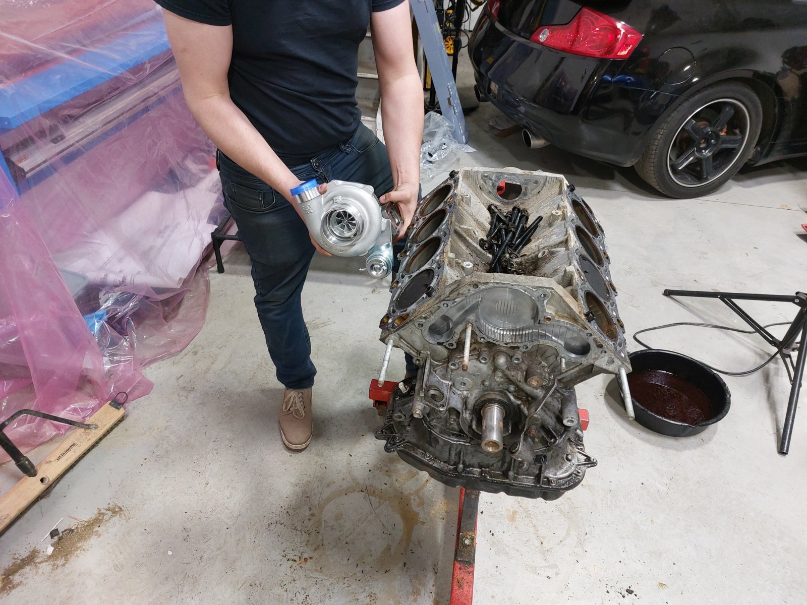

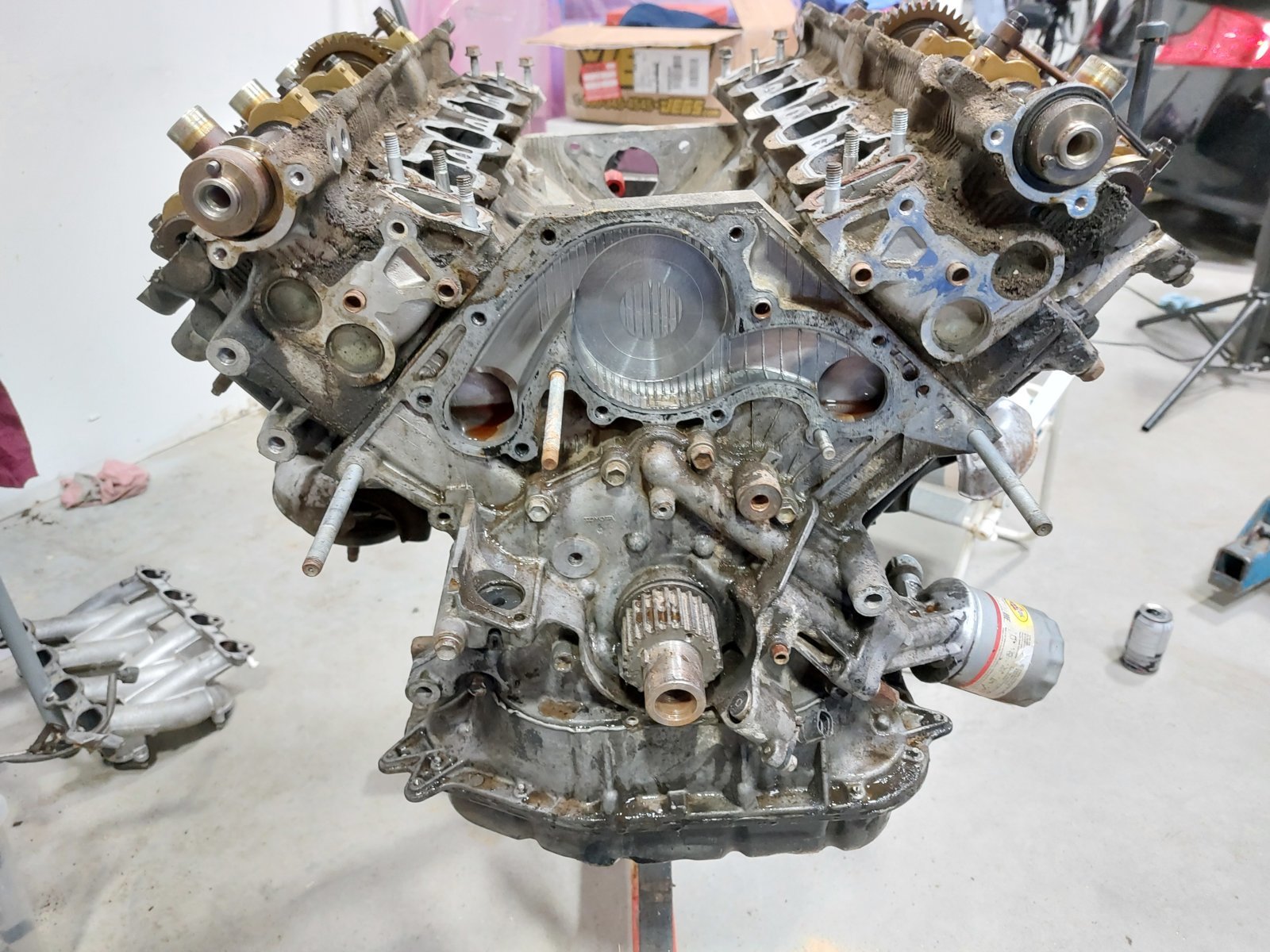

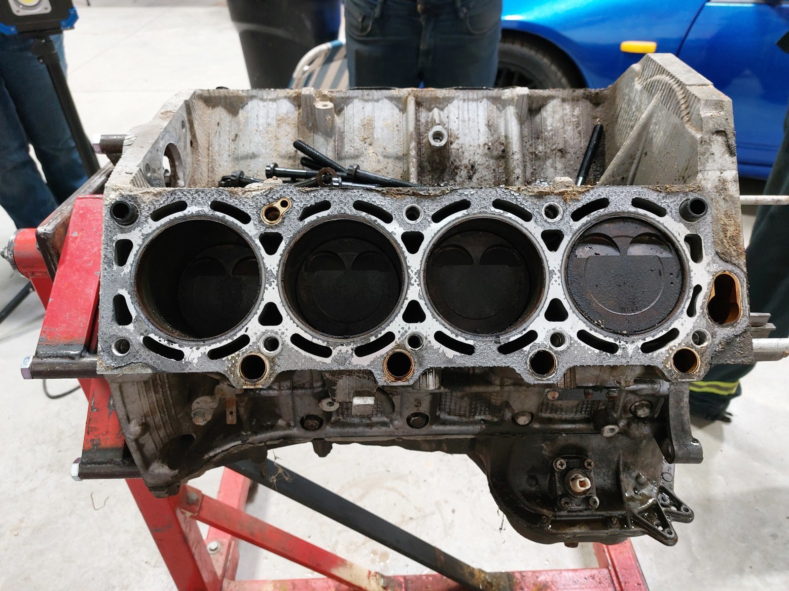

    Everything is all apart... time to send the heads for cleaning and the block to the machine shop.
    The motor is still looking good. Conrod bearings appear to be fine, valves all look pretty good. No signs of head gasket issues!

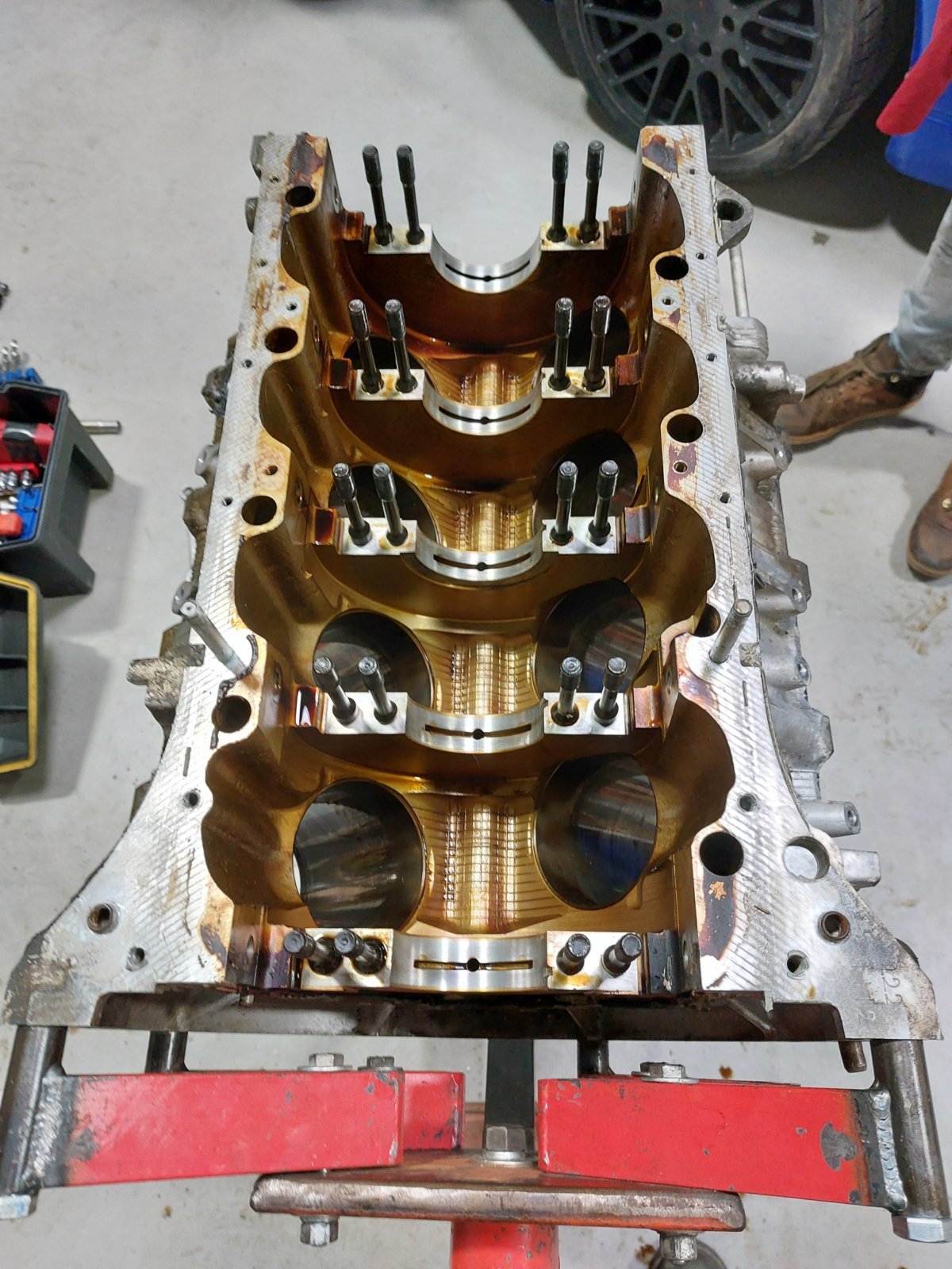

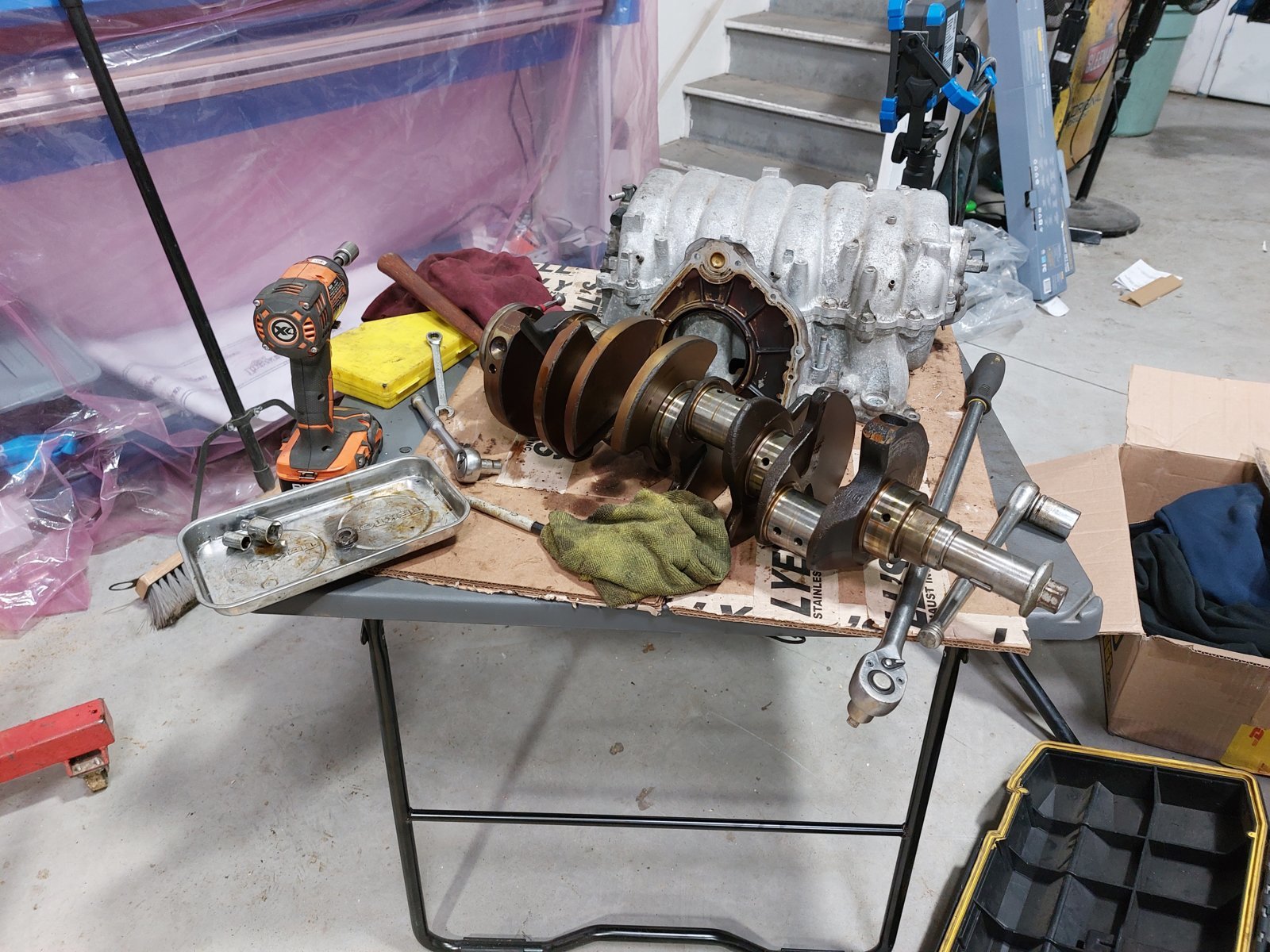

    Everything apart. No apparent problems at all. Rings, bearings, crank all look great considering the age.
    Sent off to the machine shop today for bore and new pistons.

    How many miles were on that motor? Thing is super clean.

    Allegedly 150000
