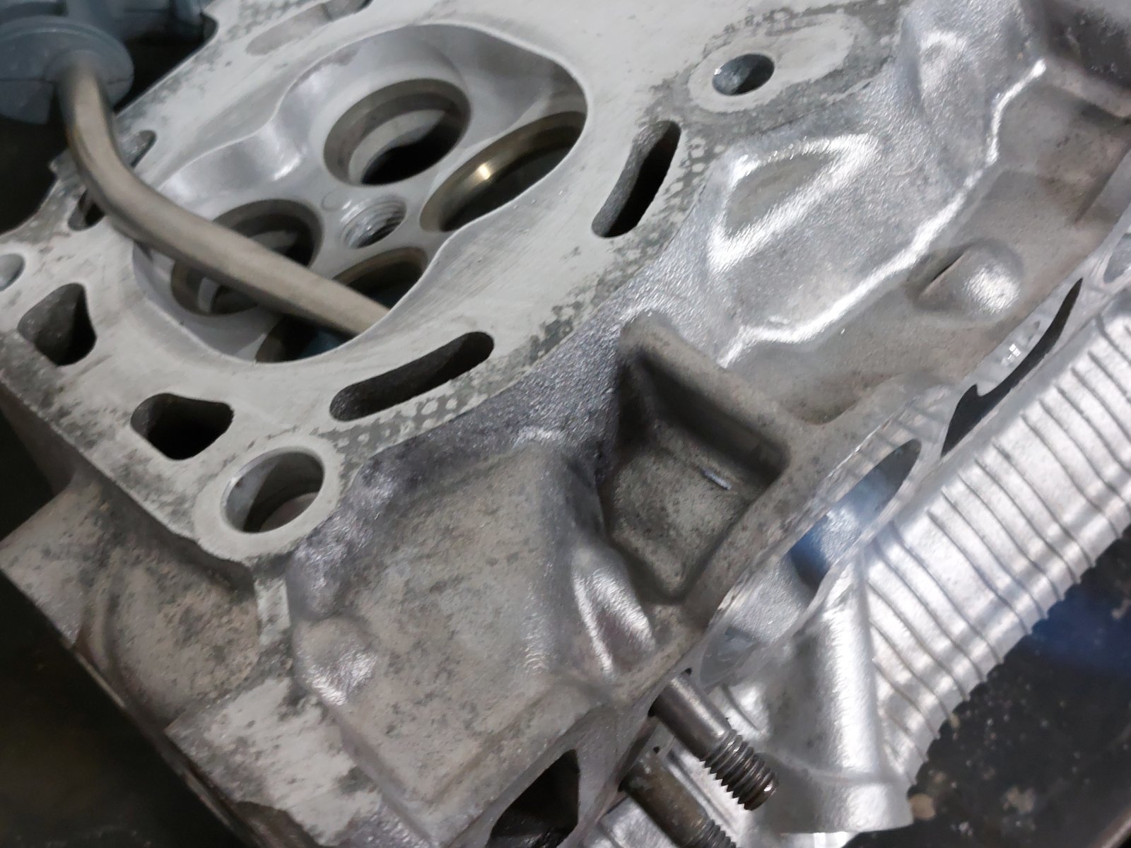

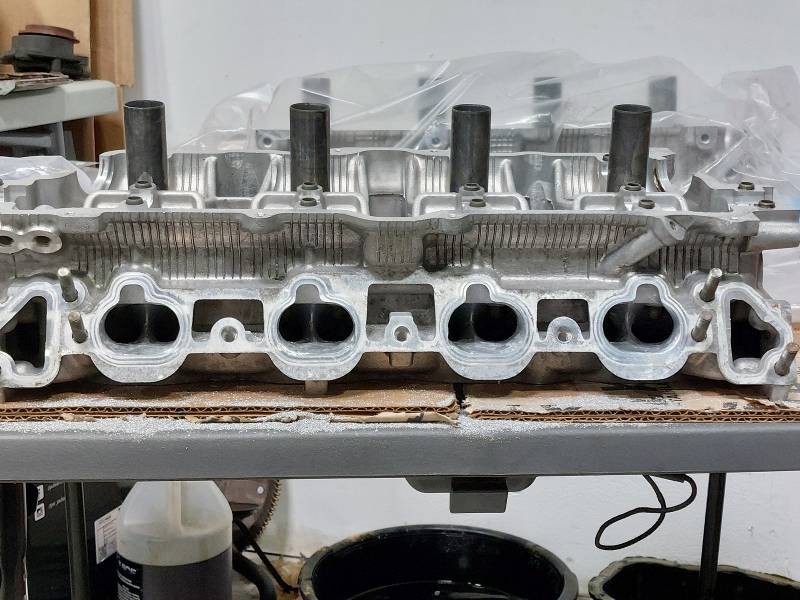

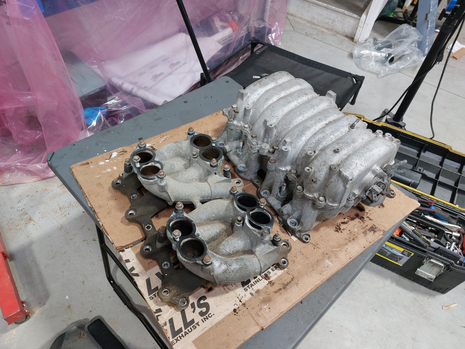

    Opening up some more.

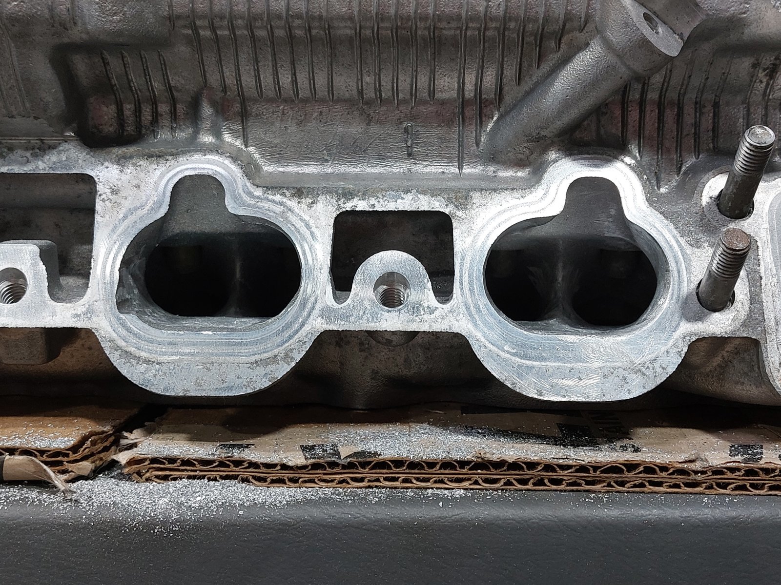

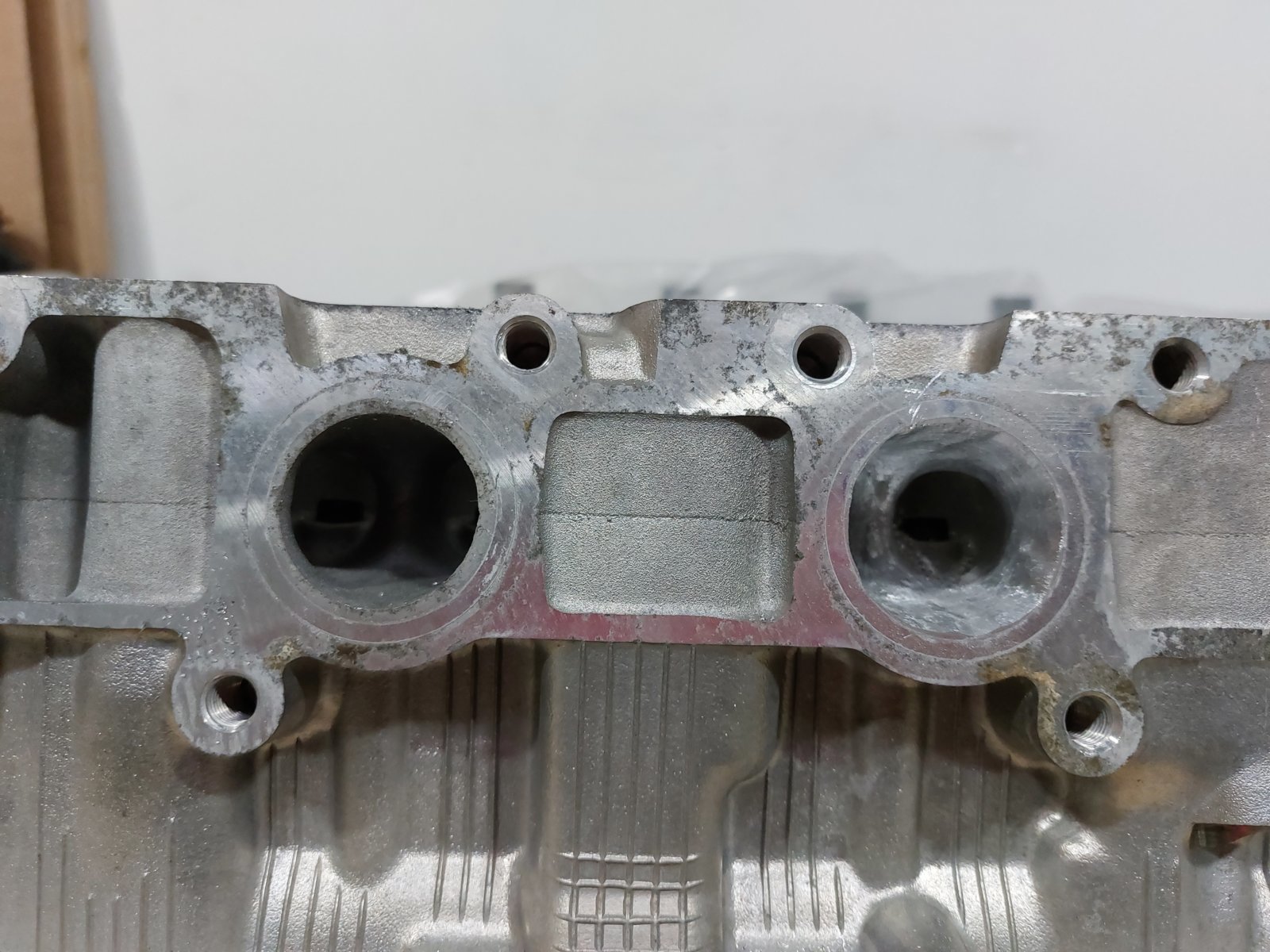

    Looking much good, except one port cracked... my speed shop buddy was able to repair it though.

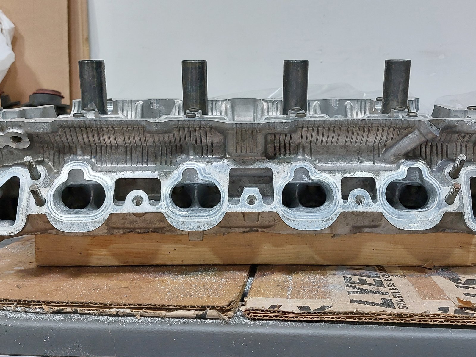

    One intake side done. 1/4 down lol.

    Oh man, my dad ported the head for my supra some years ago and he couldn't do anything with his hands for a week. You're a crazy man.....

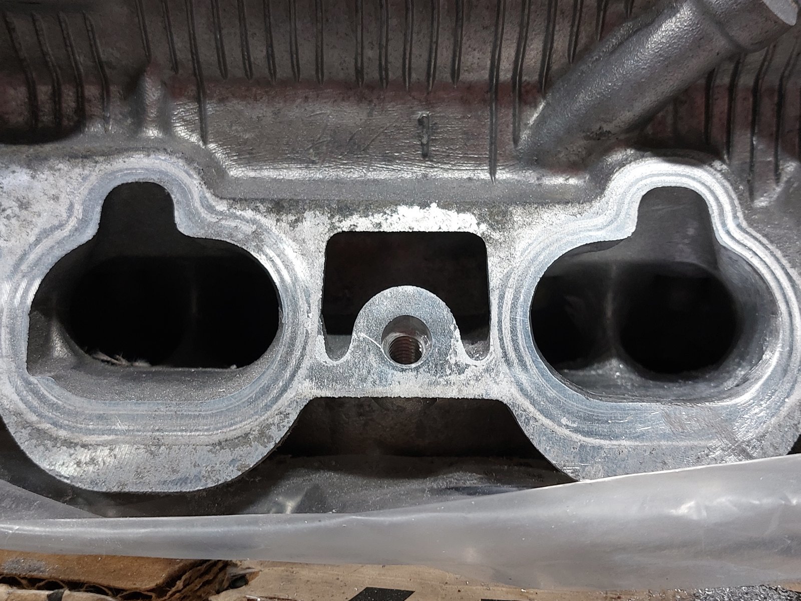

    Opening more shit up.
    Man I do not work with my hands normally so this is killing me.
    I hope it's crazy enough! This porting is probably going to net me like 20hp lol

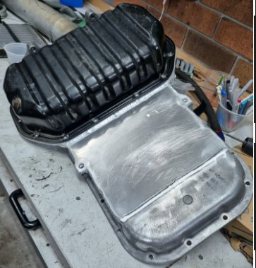

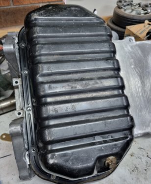

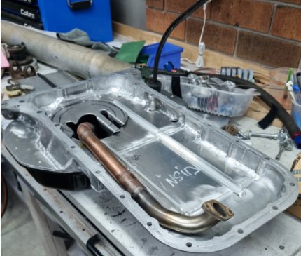

    The guy I bought motor mounts from might be selling a modified sump that he built for a customer who didn't come through with the money. The bottom sump has to be moved to the very rear of the engine (stock location for 300ZX) and made shallower in the middle to accommodate a higher subframe.
    It would save me a lot of headache in custom fab... we'll see what price he comes back with...

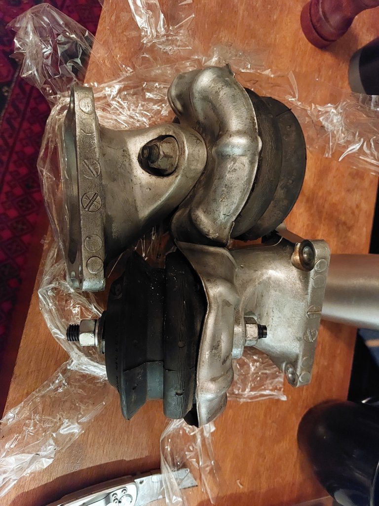

    To adapt the 1UZ to the Z32 frame.
