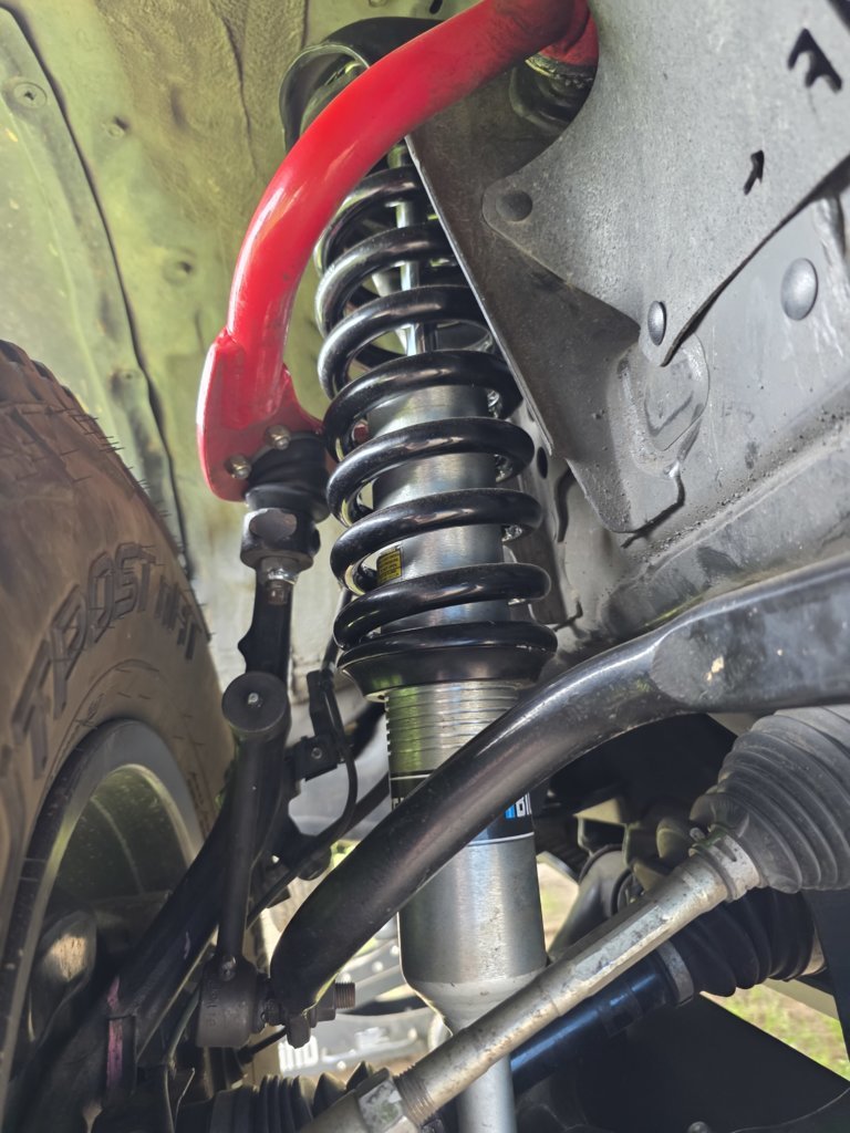

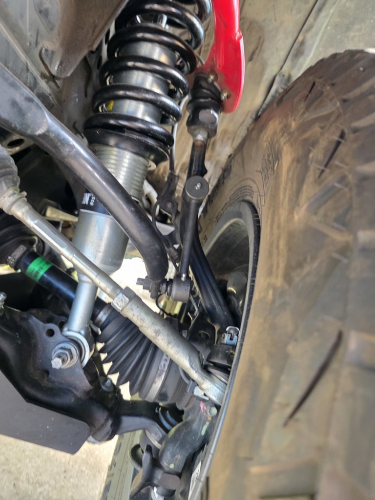

    Surprisingly I have a little bit of wiggle room, the clearance between the fins and the strut mount and skid bolts is a bit close but I couldn't get them to touch. I did however add another washer to the bottom side of the skid bolt and a neoprene washer to the top since taking the photos so that there's only a sliver of exposed thread. I have about 1/4 clearance from it full droop.

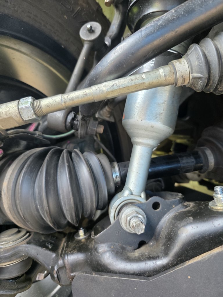

    Closer shot of the UCA and bucket
    I could probably get away with a 1/2 spacer but that would be the absolute limit before things start touching and the lines begin getting strained.

    That’s close!
