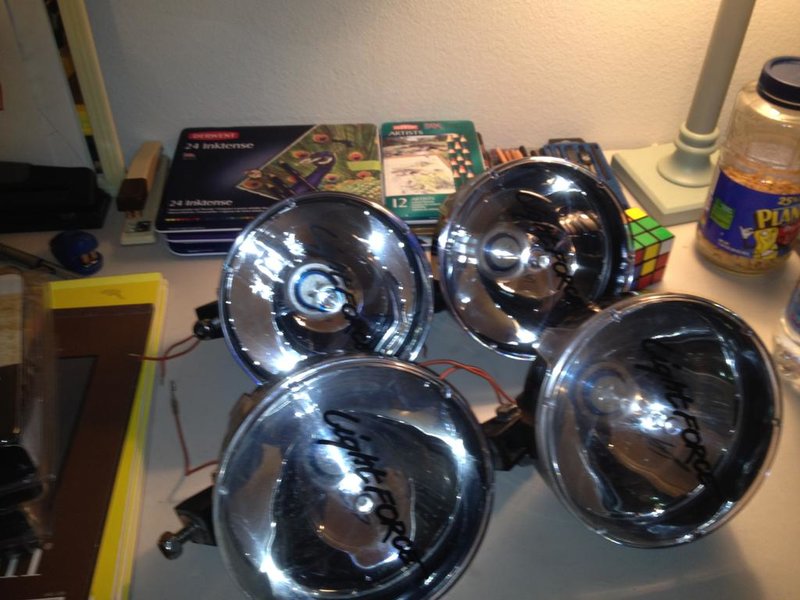

    Here they are for a grand total of 6 light force lights Four 170 strikers and two 240 blitz

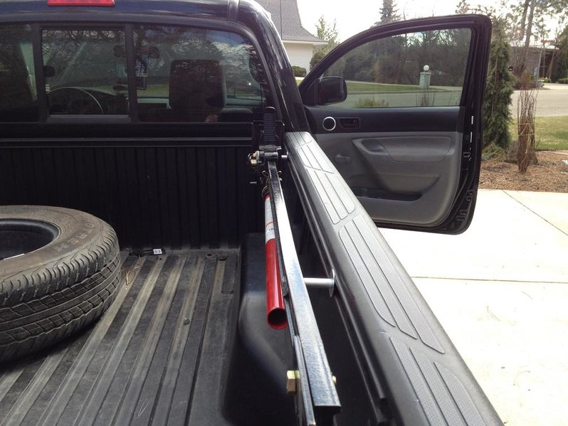

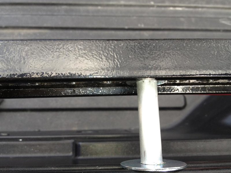

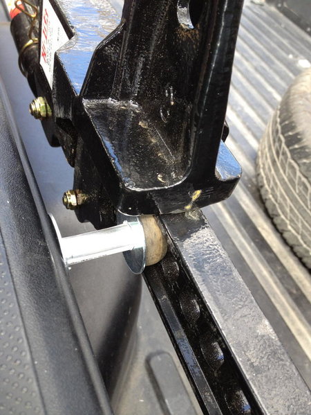

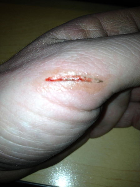

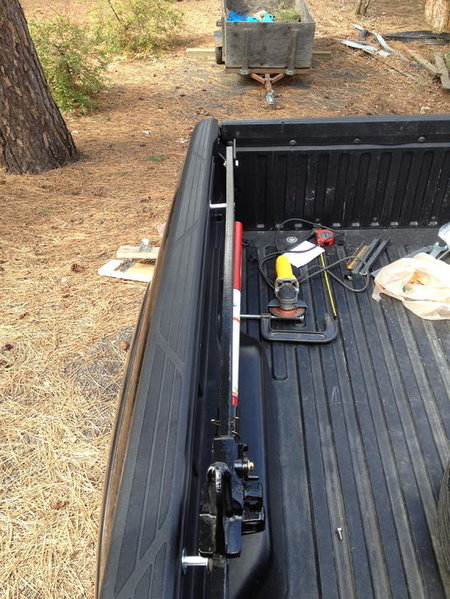

    today I mounted my Hi-lift and started making new battery tie downs
    for the Hi-Lift I used 3" long 3/8ths 16t bolts and T-slot nuts from Fastenal
    (don't go looking for them I bought everything they had nation wide... all 20 of them) I also used some 1.5" washers and reused the rubber rear shock bushings from my old shocks to keep it from vibrating and ruining the powder-coating. and some 1/2" Aluminum tube as spacers.
    And the battery tie downs still need to be welded up
    And the grinder got me.... Oops :eek:IMG_0991.jpg

    hmmm..will be interested to see how the hilif mounts hold up.

    I think I'm going to make two more and reverse the bolt orientation....
    plus it's going to be in the way of the rack supports so i need to move it anyway but for now it works just fine

    Yea i thought you were mounting it to the actual rack right?
