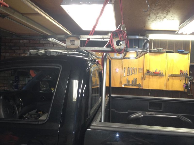

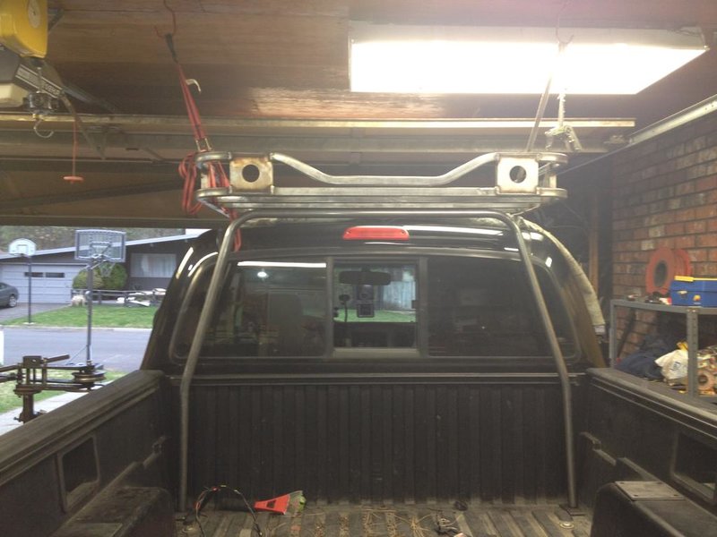

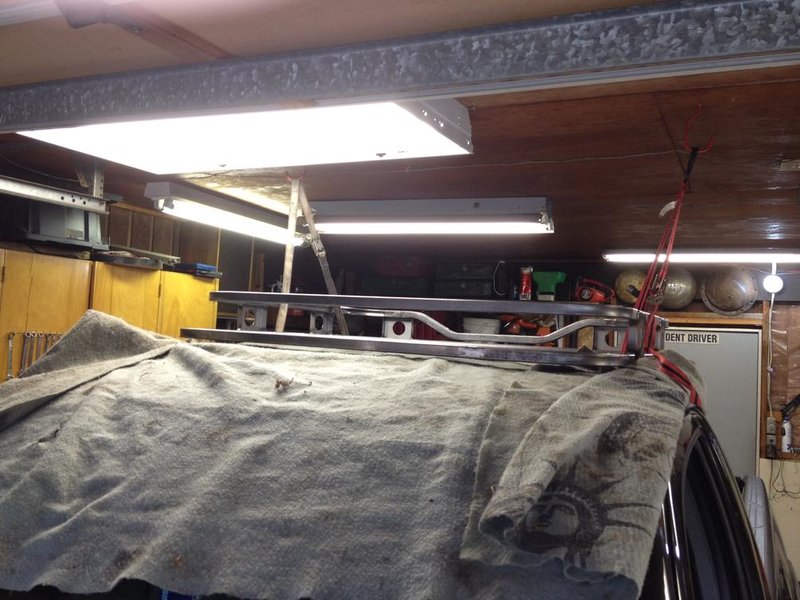

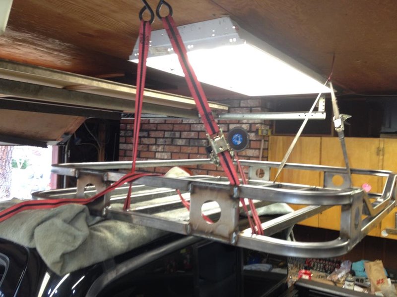

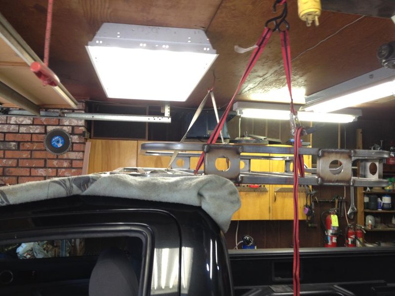

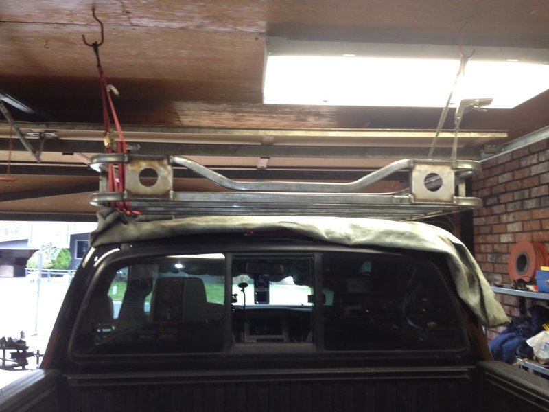

    Here are some more teaser pictures.
    I have everything ready to go just need to make the final welds and drill the holes in the bed for the rear support legs.

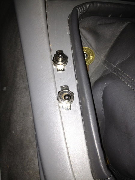

    The switches for the roof rack lights

    Thanks man, the rear supports are ben't up but i didn't snag a picture of them.
    The front ones will bolt into frame using one of the bed mount bolts and the rear supports will bolt in to a 1/4" 4x4 plate that will be bolted to the fender so whole rack is removable along with quick connects for the lights. The whole each should take about 10-15 mins to take on and off once it's done.

    looks good hangin from the ceiling! :thumbsup:
    also handicapable sticker hanging from the mirror ftw!!!

    I wish it was on my truck and not still hanging from the ceiling

    Wow a lot smaller then i had originally pictured.
    Sucky deal tho man. Will be worth it tho!

    it's 42w 36L on the top and 40L on the bottom and 6d

    I thought it was going to be longer! Lets wait for the finished product!!

    might have to deflate the tires a wee bit :p
    hopefully he doesn't pull into a garage every night or he might have some issues if he decides bigger tires/more lift.

    No It won't fit under the garage door... we're going to take the rack off and then put it on outside.
