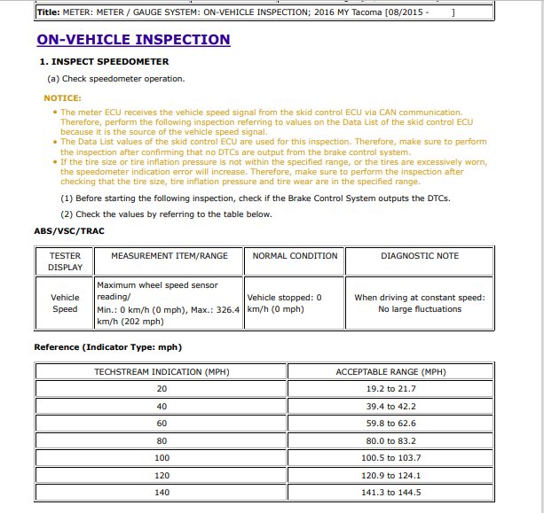

    I see the dealer's service department view. They do operate on facts. Your speedometer is showing a correct speed. Here is tacoma's speedometer check. You are set for 72, it fluctuates between 70 and 73. For them, it is acceptable and there are no safety concerns.
    Does it fluctuates at any speed in CC? Does it fluctuate when CC is Off?

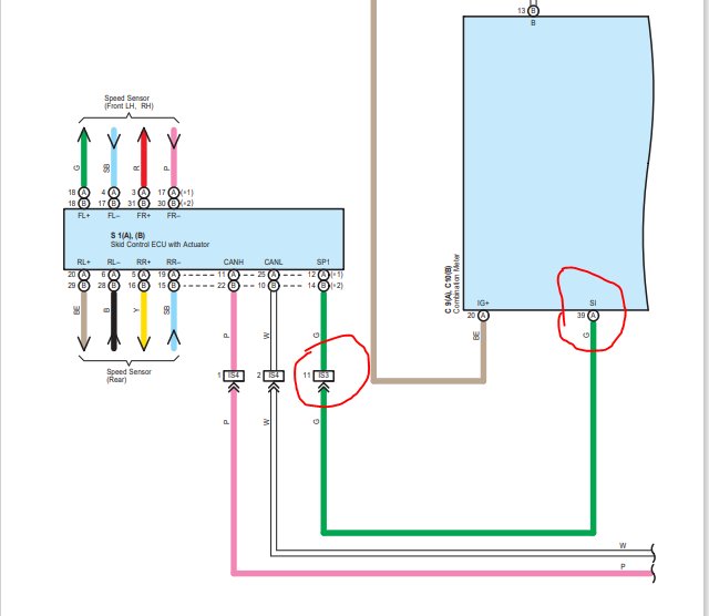

    You could check the wiring behind to make sure nothing is loose. It seems that the combination meter could be a culprit. Are you still under 3/36 warranty?
    Green wire is the speed signal output for speedometer. It goes to from Skid Control connector to Combination meter via junction connector IS3.

    He's been to the dealership, and they ignored the issue and sent him packing.
    That's why he's here.
    Checking the wire and connector you posted above, is all he can really do without a scope.
    Thanks for the diagram. I kind of backed out of this thread.
    Not a lot we can do here "easily" to help over a thread.
    It's going to take time and a scope to prove the issue.
