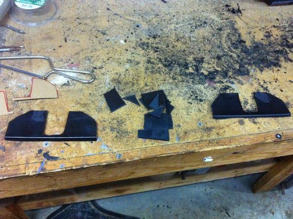

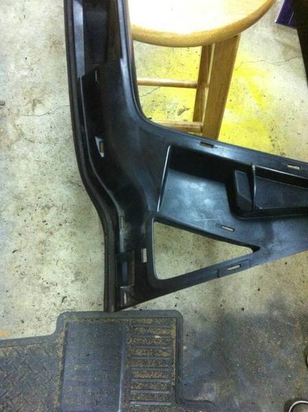

    Cut up the bottom piece of the grill to use as the fillers.
    Some rough cut outs from the plastic. The extra pieces should come in handy when I attach the cutouts.
    Got them rounded out and fitted.
    Cut out the triangles.
    How she sits as of now until I get some epoxy.

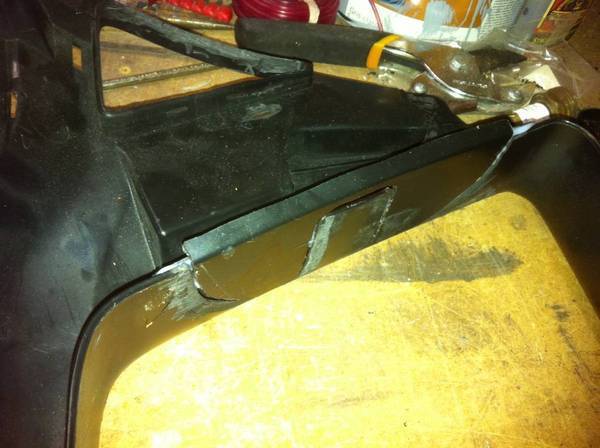

    Used the extra plastic for some tabs on the fill pieces.
    Both sides of the grill with the inserts. Excess expoxy will be sanded down and bondo to fill the rest of the gaps.
    Used some more remaining plastic to give some backing for the bondo to come later.
