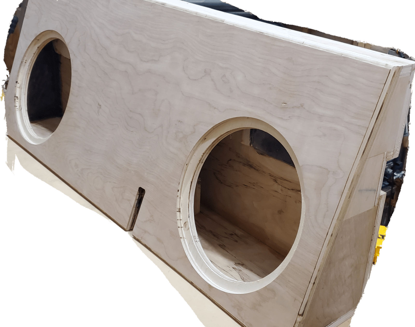

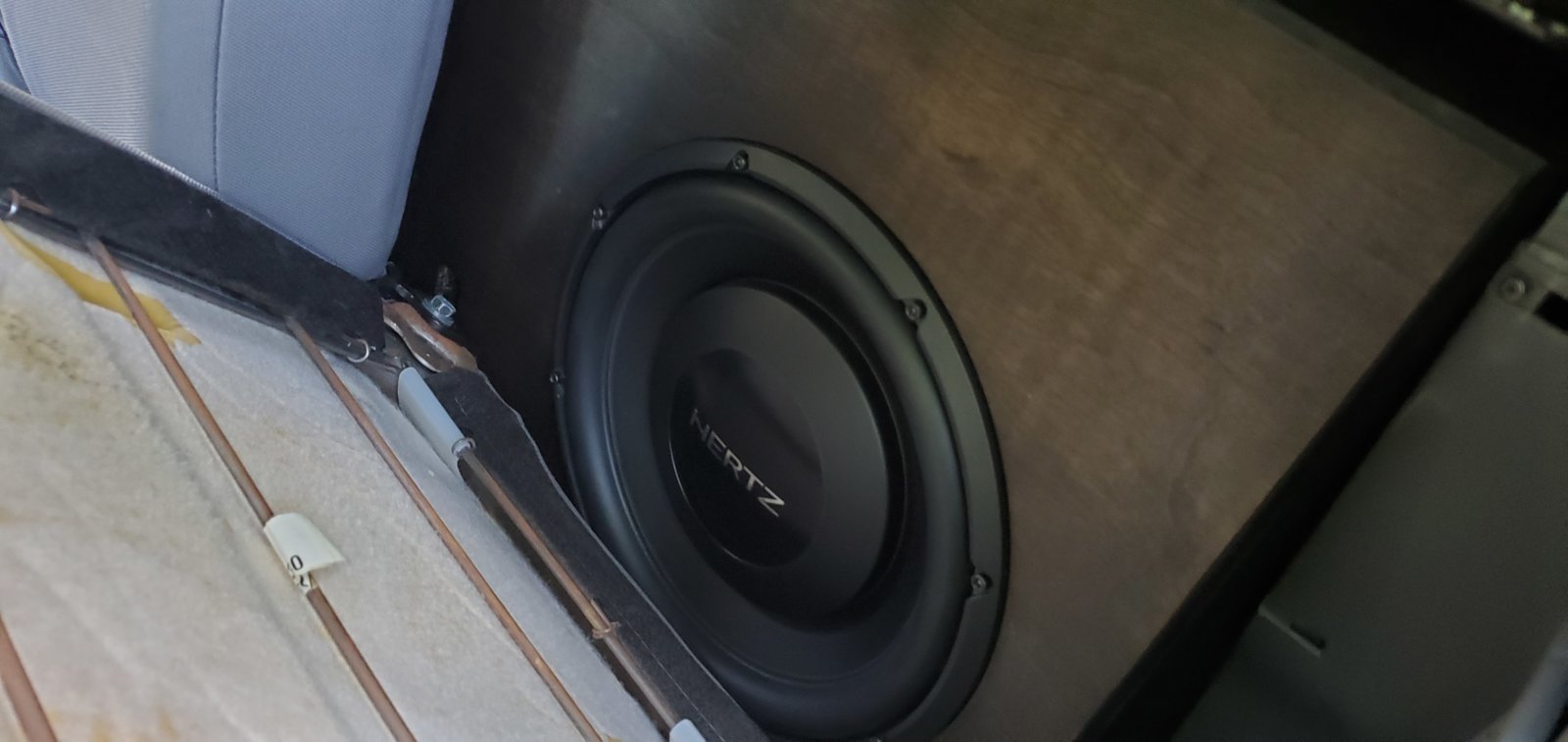

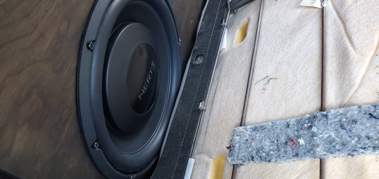

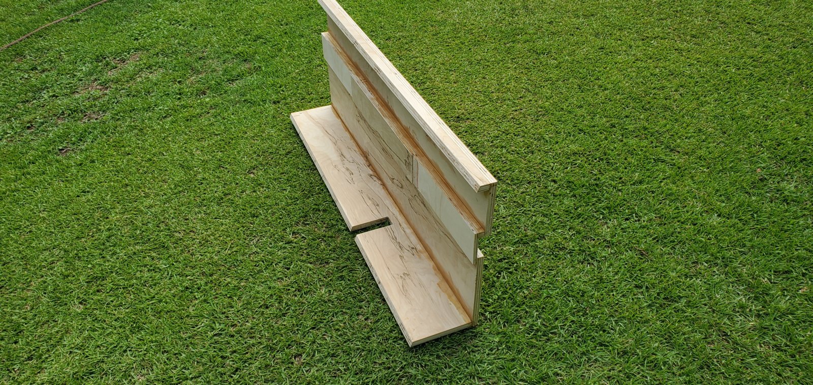

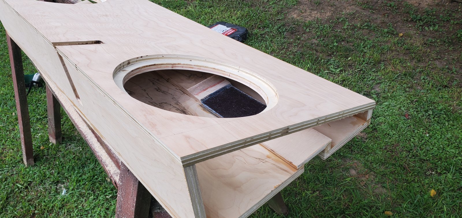

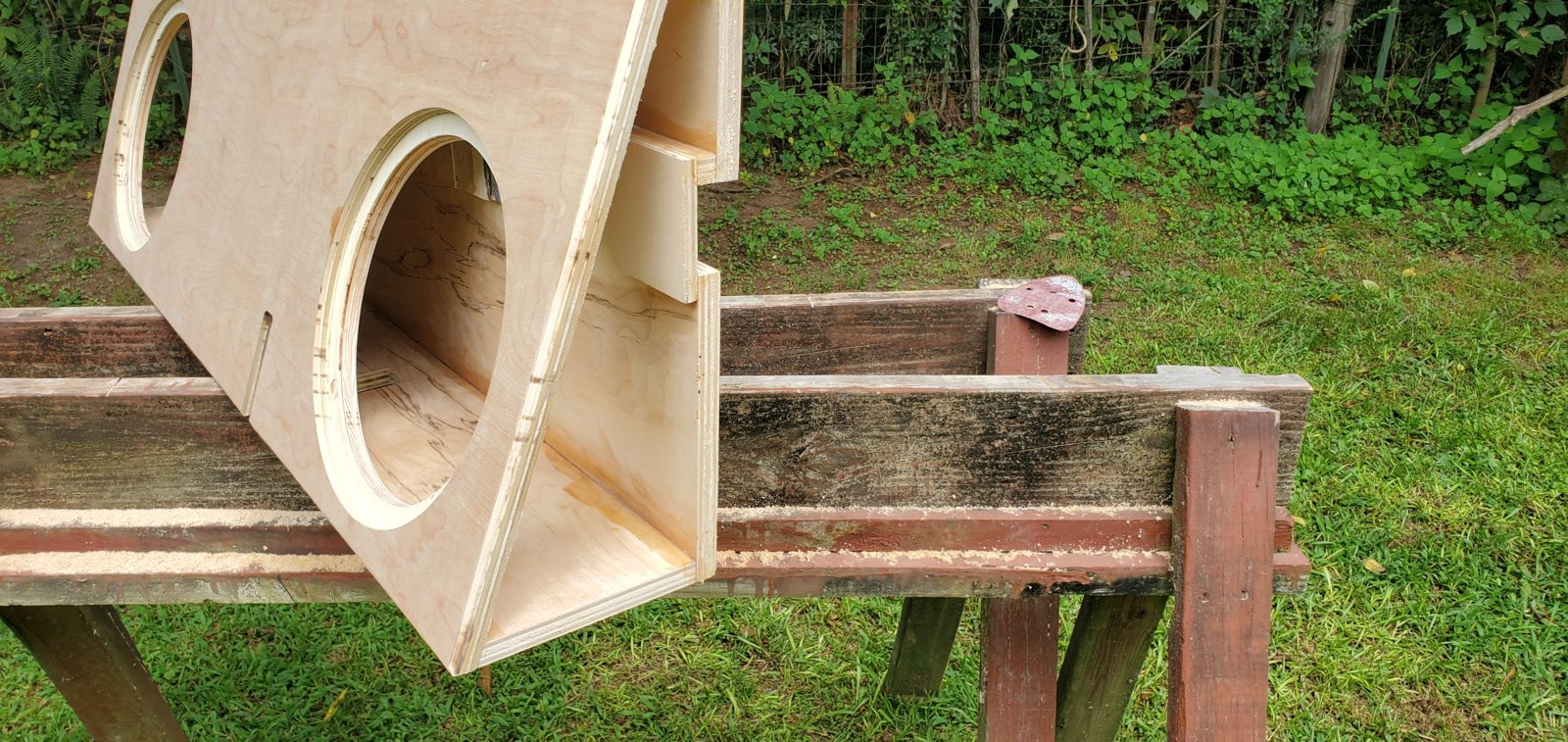

    I'm not a bad fabricator, been doing it for years, but trucks and their limited space is pretty new to me. Was a challenge getting around 1.5 cubic feet and getting even the depth needed for these shallow subs to clear. I probably couldnt have made the tolerances any tighter. Two of these 12's should absolutely be plenty of bass in the cabin of a Tacoma. You will see in some of the build pics some mods I had to make to get clearances..With the seats up there is around .75 to 1.0 inch of space from the woofer to the seat backing...Thanks for looking..

    Man that baby is crammed in there..lol..There is hardly room for even the woofers to flex. And then there is the issue of it being behind those foam seats. I know bass is a bit different but its gotta make an impact being behind all that foam...Will just have to see how it feels and sounds in the next coming weeks....I could always fold up the rear seat bottoms to give them some breathing room...

    Yeah I stuffed it with about a pound of polyfill. It honestly likely isn't going to make any difference. I've modeled these sub parameters in Winisd and this box being around 1.5 -1.65 cubic feet is around .7-.8 QTC so its already in that happy medium zone of power handling and low extension..Shallow subs have come a long way from when they first came out. I remember they sounded like shit back around 2005. These things can dig down into 20 HZ territory no problem. Probably going to be overkill in the tacoma cabin..Can always reduce output..
