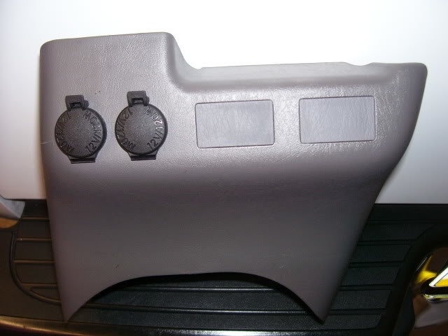

    I have two blank covers to the right of the two power outlets under the ashtray on my 1st gen. If these had something there from the factory, what would they be??

    Security system

    ^what he said
    I used mine for lighting switches

    Does the security system use both spots?

    Yes. One is for the Led to show its on and the other i think is a button to shut it off(not exactly sure on the botton but i believe so)

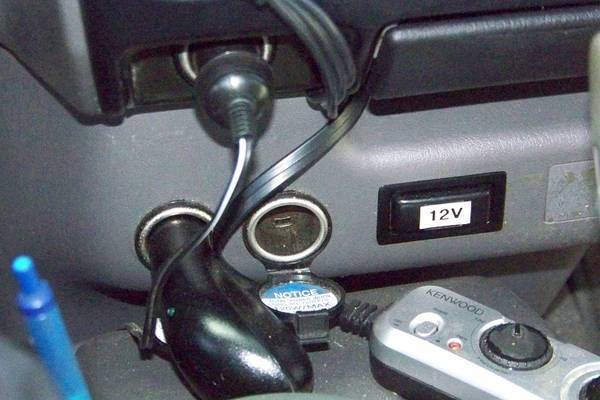

    I grabbed a hazard flasher switch from the junkyard, wired the grounds to the two 12v outlets throught it. I then removed and jumpered out the relay, making the outlets on all the time, unless I turn them off via the switch.
    The top outlet is separately controlled, it still operates by the ignition switch.

    how hard is it to wire something to one of those spots

    Getting in there is nothing, how far you want to put the rest of the wiring can get tricky. The panel just clips in with the pins on the sides. Then the sockets have plugs on them.
