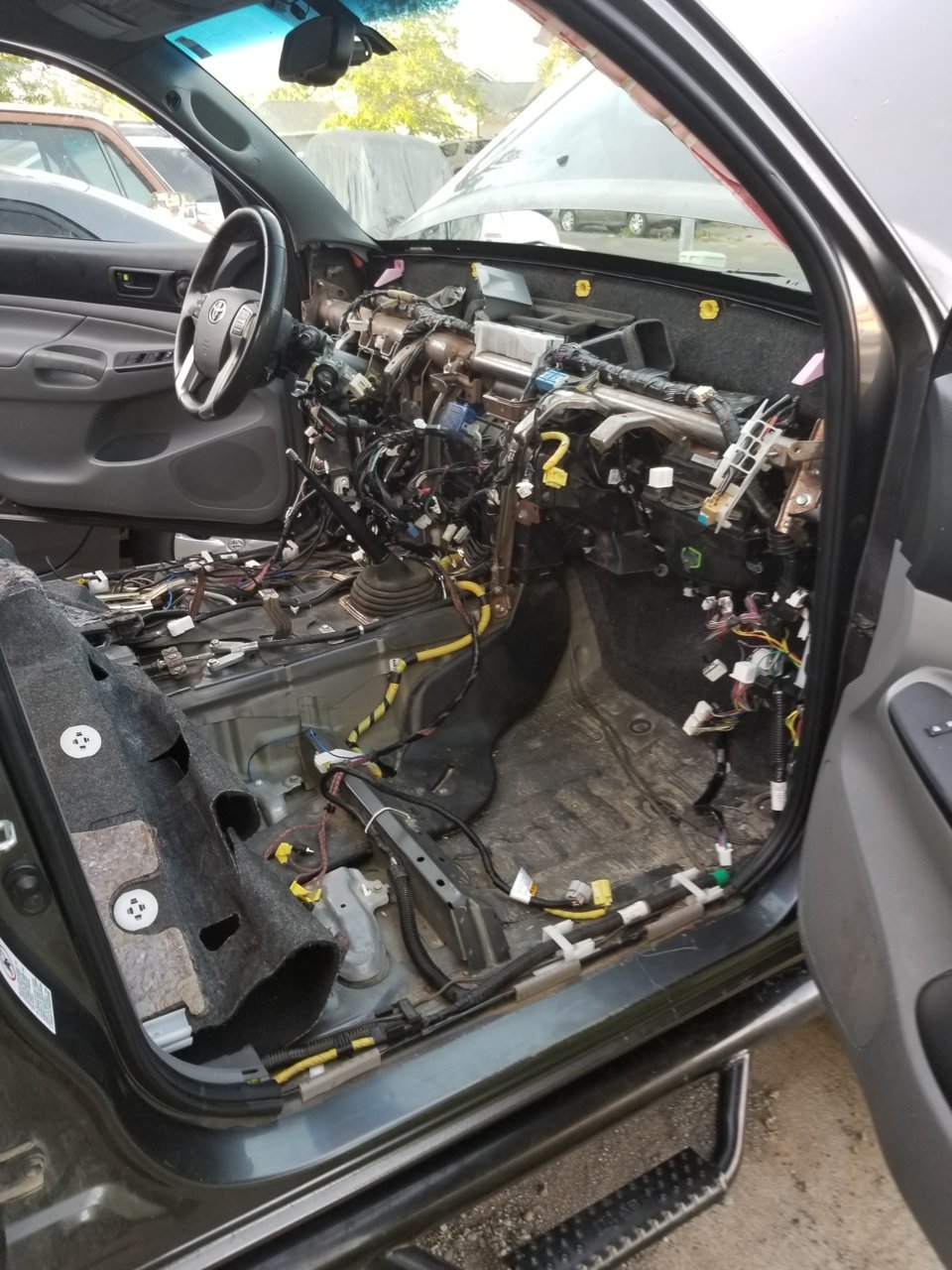

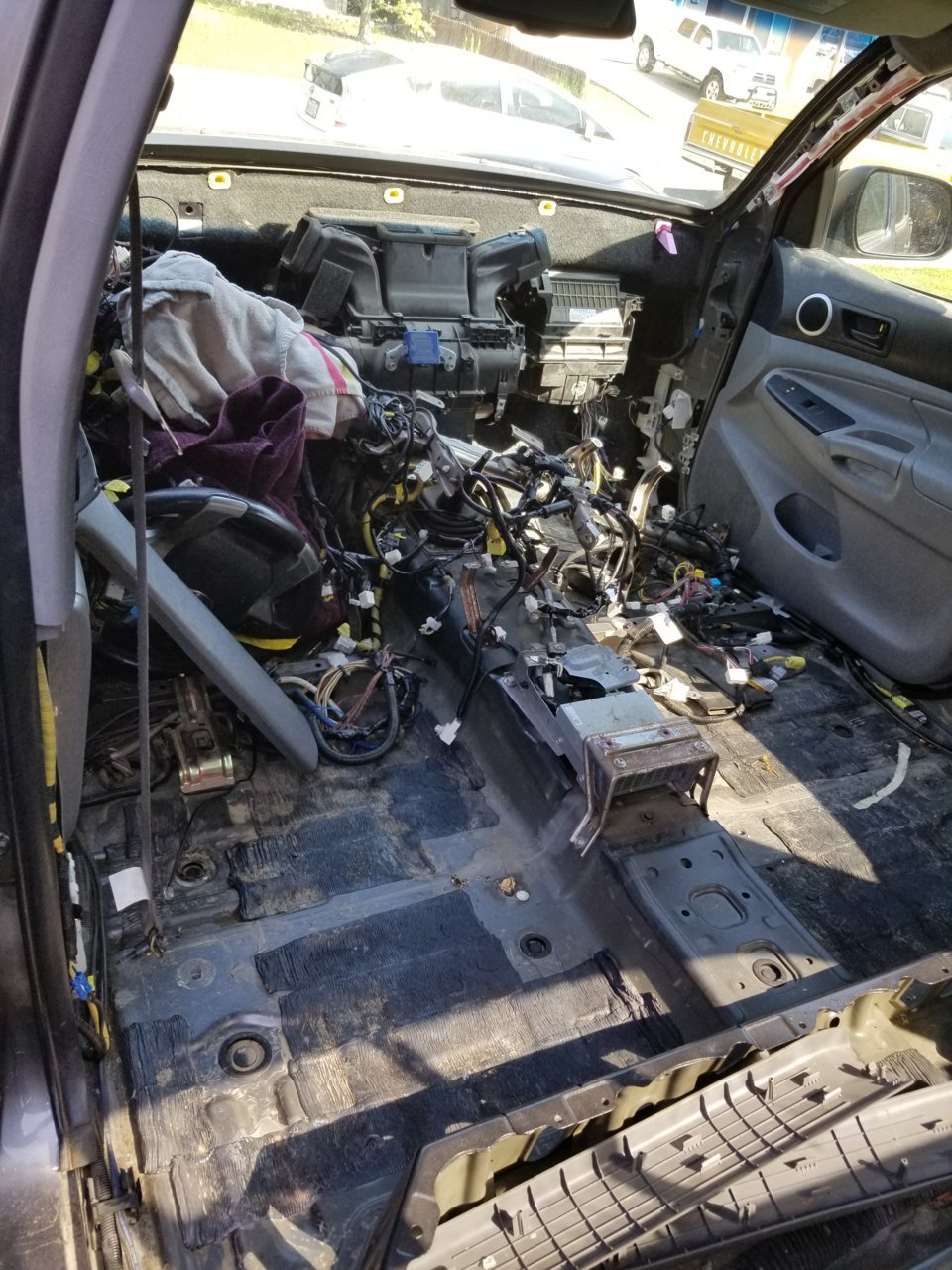

    I recently purchased a truck which took five shot to the front end. Two rounds went through the fender, into the cab, and through the engine harness. I've traced the path of all of the other rounds and those are the only two which have done any significant damage.

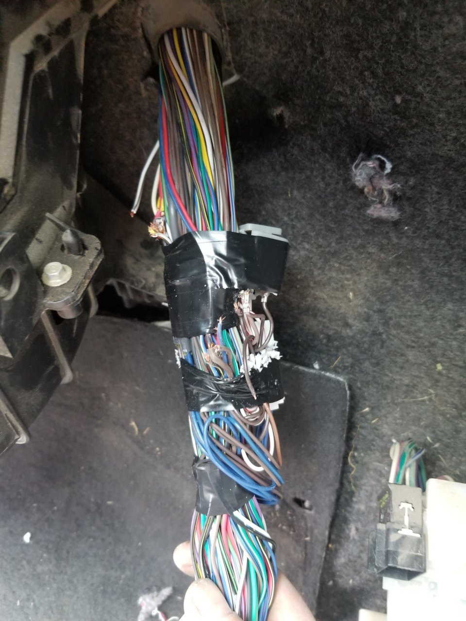

    I've repaired the wiring harness with those low temperature solder sleeves. It seemed to be a success. I reassembled the interior, called a locksmith to cut and program a key and she wouldn't start. The security light does turn off indicating the key was programmed correctly.
    It cranks but it will not start.
    It will start and idle great with a little starter fluid.
    I've already dropped the tank to find out that the pump isn't receiving power.
    I also don't have drivers side rear window, no horn, and my 30A trailer charging fuse keeps blowing. All other fuses are good inside the cab and under the hood.
    The I've removed the cover on the ECU. No burnt capacitors or anything.
    After completely reassembling the interior I've torn it all back apart again, double checked my work (connections look great). I've looked underneath the truck, all throughout the engine bay, and I cant find any other broken or damaged wires.
    I'm stumped.
    Does anybody have any suggestions on where to look next or what it could possibly be?

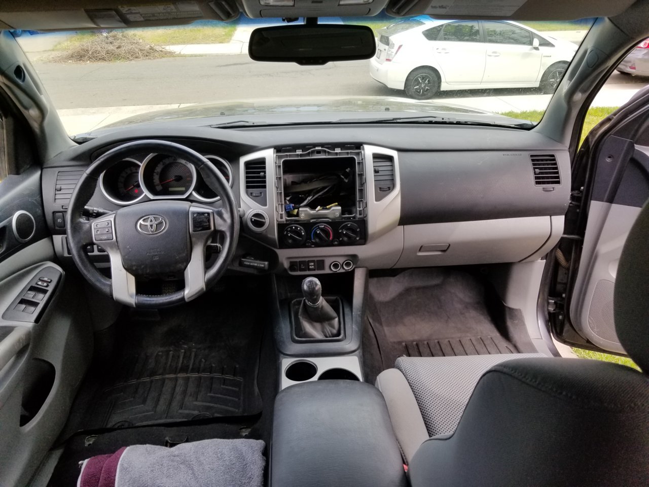

    Assembled for the first time expecting it to start:
    Bullet Entry Locations (the direction of the middle line is off. It actually put a teeny tiny dent in the exhaust manifold)
    Almost Assembled for the first time:

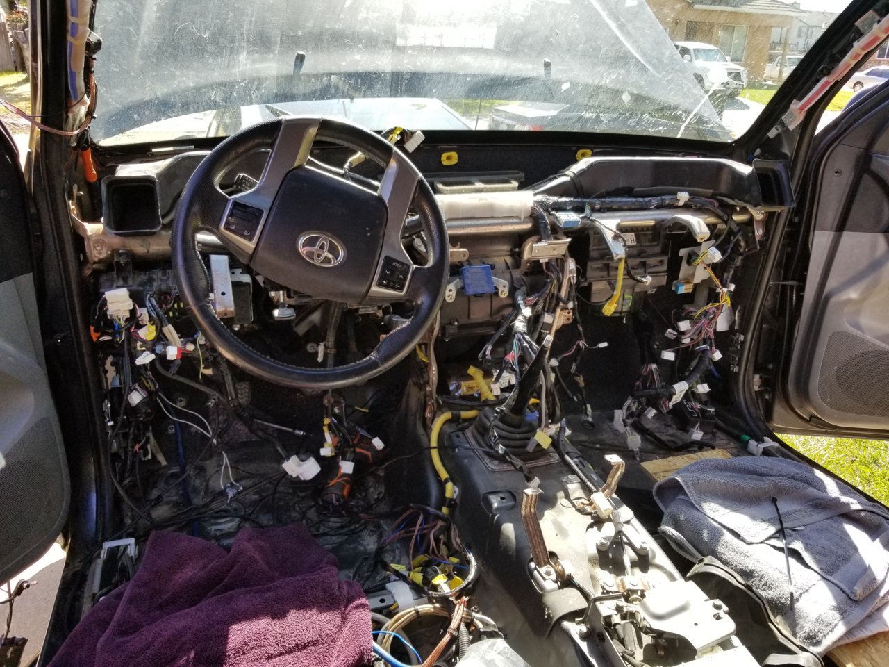

    Current State:
    The Condition I received the truck in 1 of 2

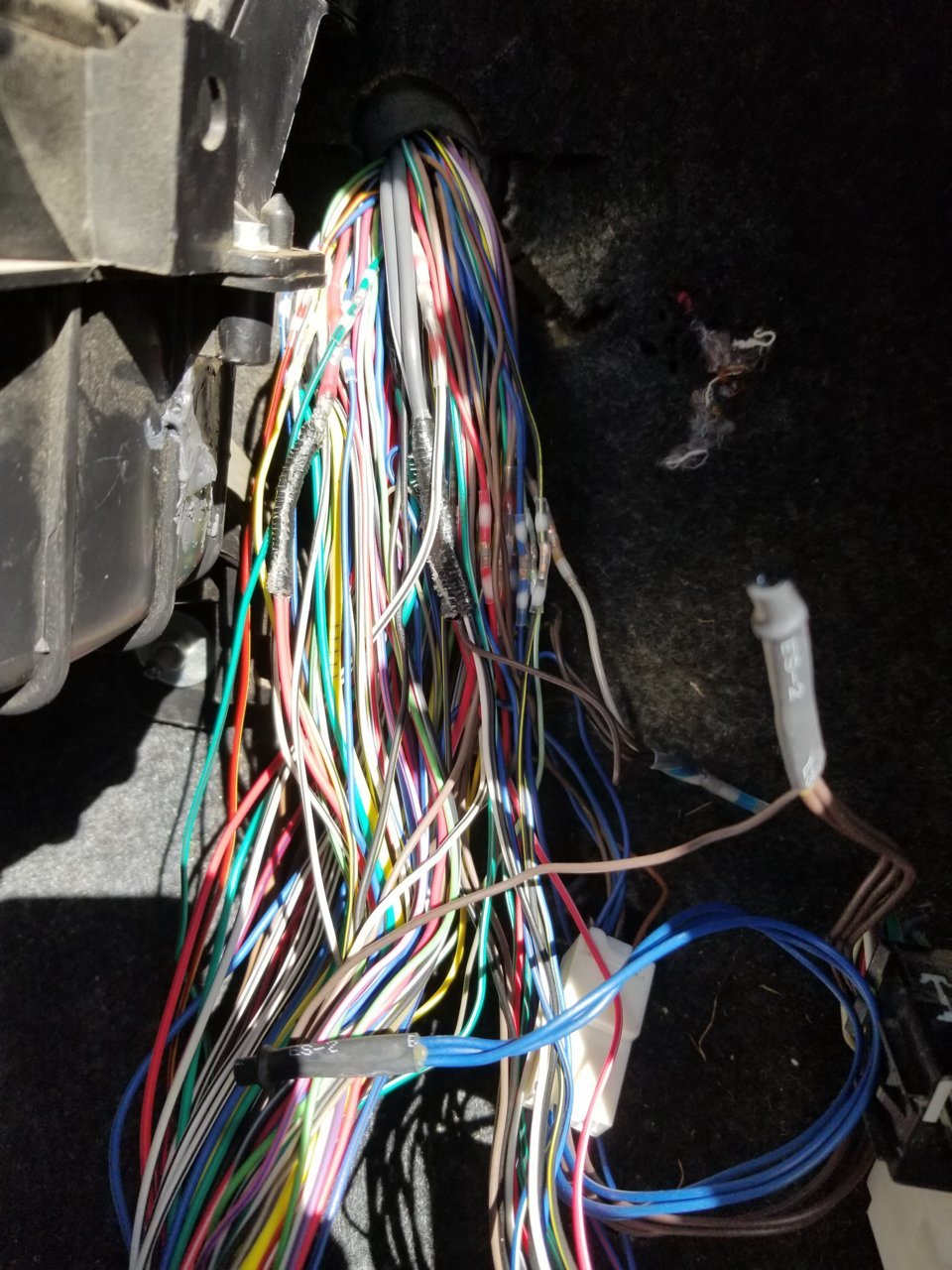

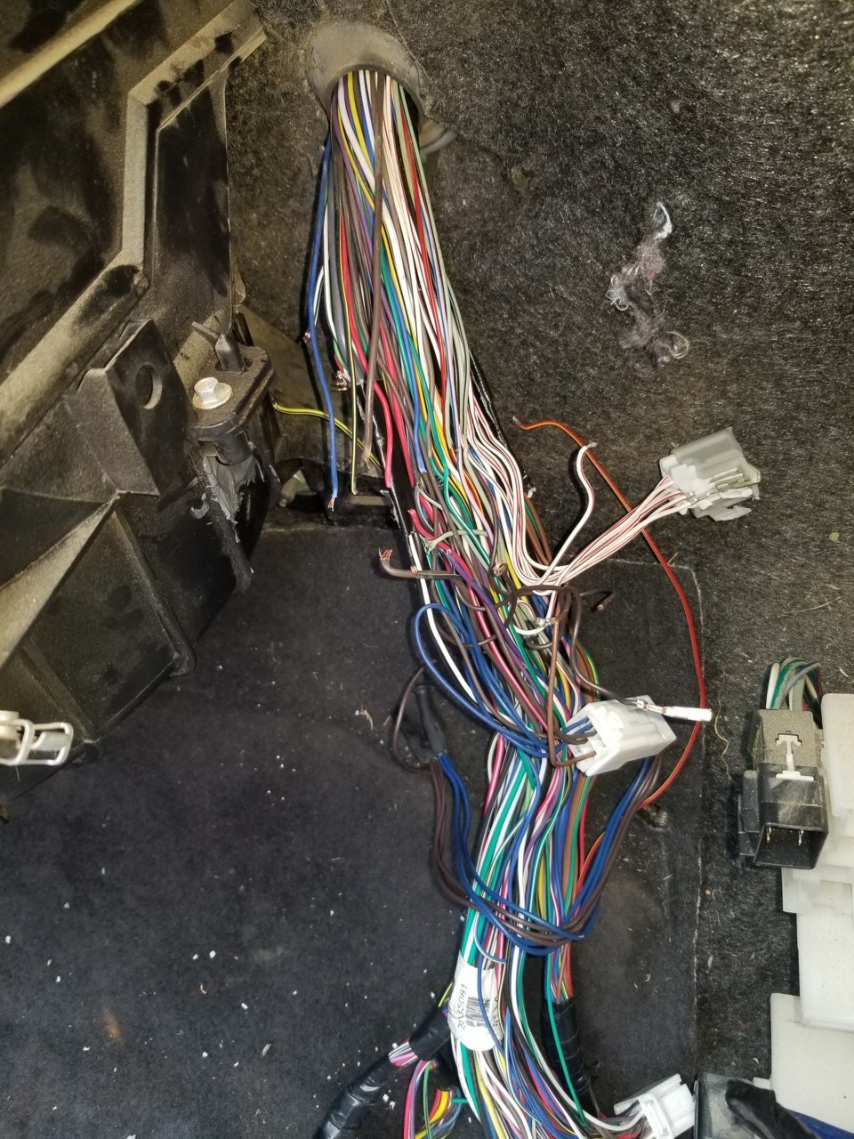

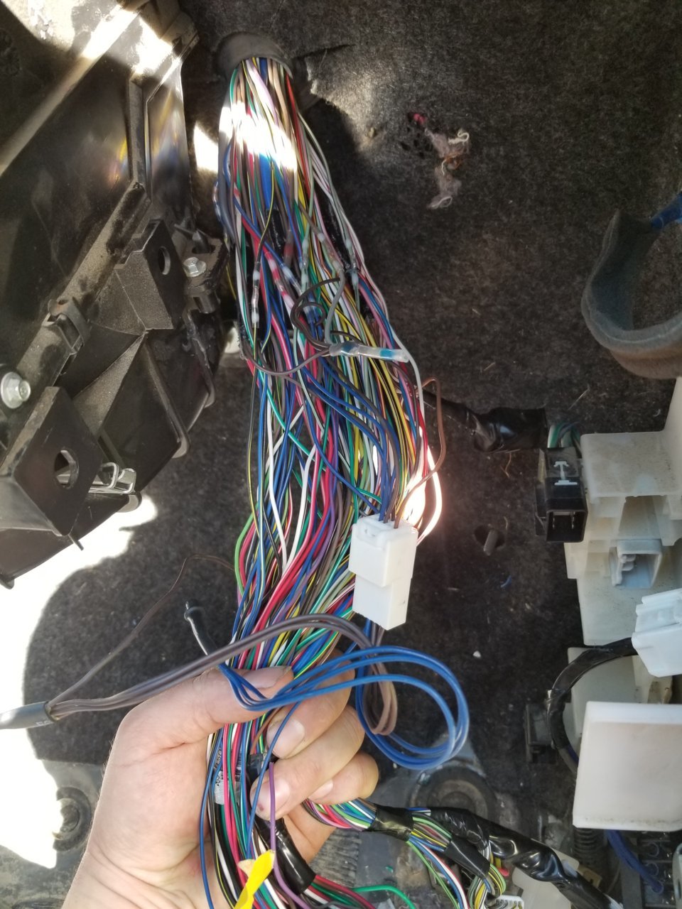

    Pictures of the wiring before and after repair

    I dontbelieve it was seized. It appears to have been taken apart by a body shop. I'm guessing they disassembled to assess the extent of the damage. All hardware was neatly packaged in bags, everything was included, and audio wires were labelled.
    No blood or anything. Nobody would have been hit even if they were sitting passenger. Gutted interior by a body shop to assess damage.
    One bullet was in the blower fan area. The other just fell on the floor near the glovebox. Nothing made it past there.
