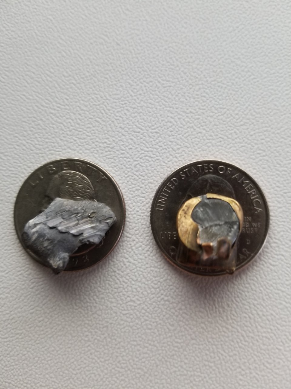

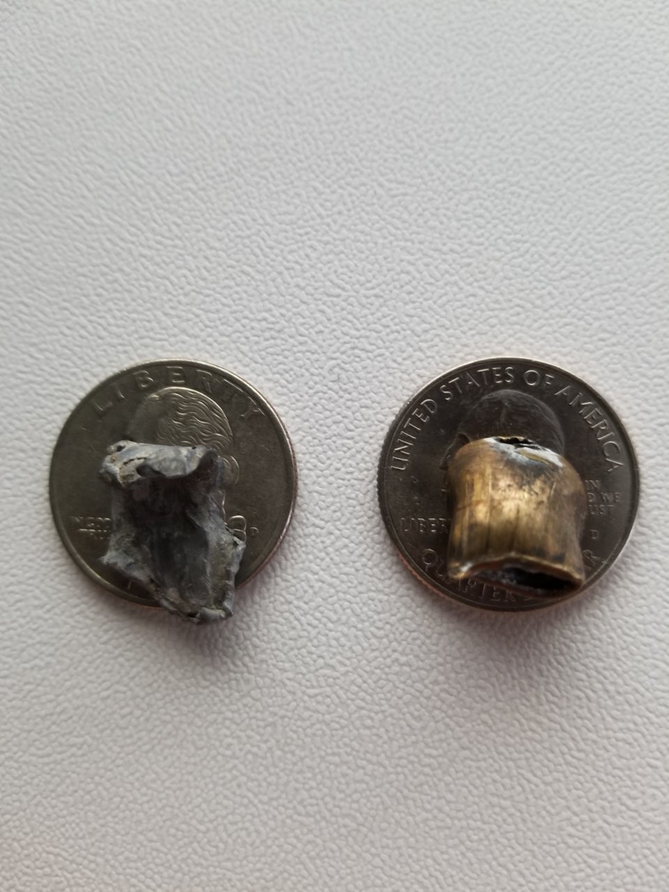

    The bullet I found in the blower assembly on the right. The bullet lodged in the back of the radiator on the left. .243 rounds may leave clean holes however they would probably be straight through the truck! lol
