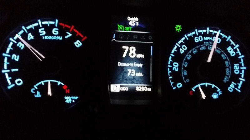

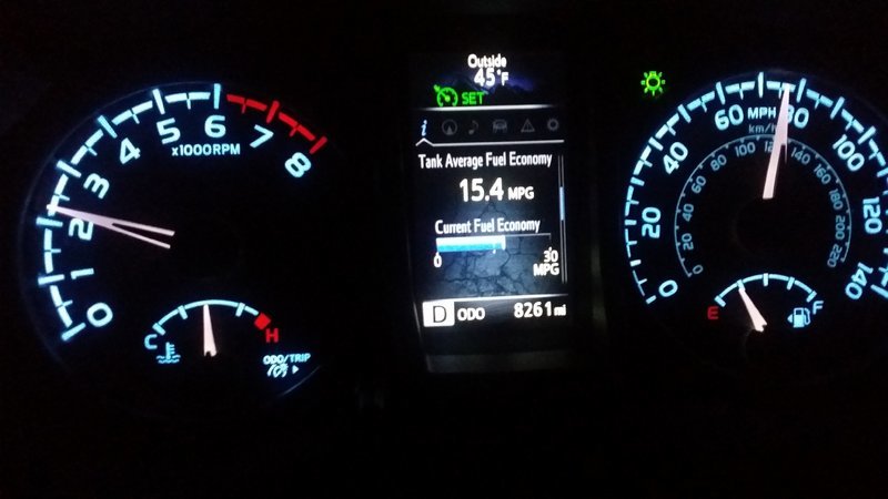

    I managed to capture a couple of common complaints on video a few days ago on my way home.
    1. Howling noise out the drivers side window
    2. High RPM on the highway in 4th/5th gear
    Will either of these be solved later down the line by Toyota? Who knows. But at least I've got proof that they do in fact exist on a brand new, completely stock 2016 Tacoma going down a flat highway. Yes there is some wind, but nothing that would keep my old truck from staying in 6th the whole time ('09 5.7L Tundra). Apparently the Tacoma just doesn't have the guts or something.

    My Taco does the same thing. I have 9000 miles on mine about 95% highway, and I average 15/16 mpg calculated manually and electronically.
    I have been a member since last September, and from all my data and everyone's in TacoWorld have found that the v6 3.5L does not have enough torque to maintain highway speeds in excess of 70mph. I am in Texas where some areas are posted at 80mph.
    The transmission continually hunts between 4,5,6,5,6,5,4,5,6,6,5,4 consistently on straight highway above 70mph. Many on this forum are consistently seeing 20+ mpg, some are 4x2 and many drive at 60mph. I can get 18mpg at 60mph.
    I have found the BIGGEST culprit is the CRUISE! I can now get 17mpg if I DO NOT use the cruise. On small inclines without the cruise, the truck will slow down and stay in 6th, then gradually pick up speed when the incline minimizes.
    Conclusion: The Taco does not have the proper torque power at higher highway speeds to prevent constant shifting. Just as a side note, I am a journeyman auto tech/instructor with over 30 years experience. I am NOT a Toyota tech, but I have worked for other dealerships.
    The 3.5L has a TON of power when you need it; just NOT at the torque band above 70 mph highway speeds with the cruise on. Above 70 mph it stays in 4th and gets around 15mpg.
