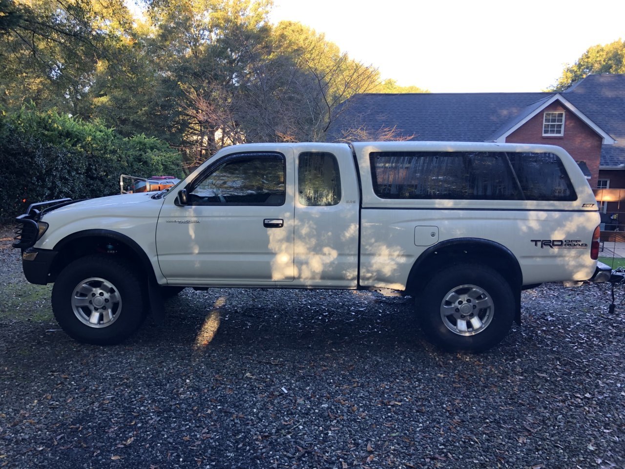

    Yes. I have King coilovers with 600 Lb springs set to 2.5” lift in the front. May not be the best picture, but the truck actually sits pretty level.

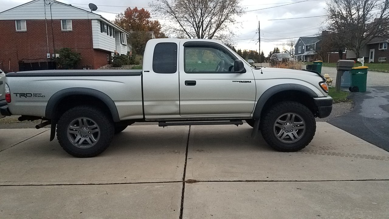

    honestly I got the OME leafs as well. I don't usually keep my bed loaded and I keep the shell on in the winter (~150 lb?) and the rear is soft for DD (my fronts another story).
    here's a pic from awhile ago (after 15k, I'm now about 50k on it)
