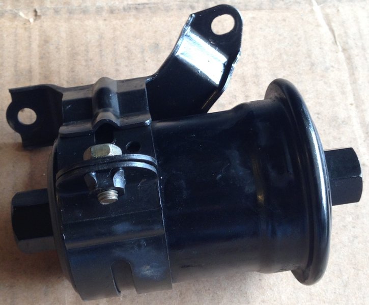

    I changed the filter today. Got some gas in my eye. "Always wear safety goggles". LOL
    I did a fill-up and checked my MPG's old-school; actual MPG was 7% higher than the UG said so that was a relief. I'll see if that holds over the next few tanks.
    I'll post some more diagnostic numbers (trim, MAF, etc.) next week after I've run with the new filter for a while.
    Check out my clean dirty fuel filter. Not bad for 140K miles, huh? Gas that I poured out of it was very clean, BTW.

    She's still running like a champ. Pings are rare and short-lived, even on 87 octane. Yesterday I took a hill in 5th gear that used to cause pings in 3rd gear & 4th gear on 91 octane, and it didn't ping. I also did a WOT throttle run from zero to about 80 and I can't say it was any faster, but it sure was super-smooth.
    Fuel trim numbers are roughly the same as before I changed the fuel filter, which is why I haven't posted them. As far as I can tell, both long- and short-term trim numbers are always between -4 and +4. But I do look at the road once and a while. :cool:
    This tank has a bottle of Techron in it which in the past has seemed to slightly improve driveability and the ability to make smooth shifts.
    I really appreciate the help you guys provided and hope that the record of what was done here helps other members. IMHO, if you're running the original MAF sensor and having some sort of engine trouble and not throwing a code, for $72 it is a relatively cheap and very easy thing to try.
