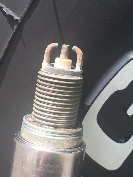

    Cleaned the anti-sieze residue off the plug threads... Didn't really feel like trying to clean the head threads today.
    What do you guys think of this plug appearance?

    Looks clean. How many miles?

    I'd say maybe 15-20k.

    To my non-professional eyes, they look fine.

    Plugs look like they're burning just fine in my opinion.

    Maybe I'm worrying too much since the plugs look OK.
