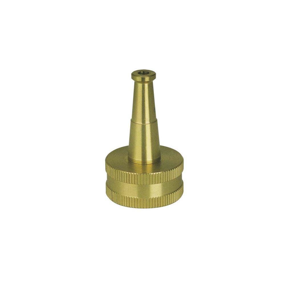

    I always use one of these attached to a garden hose to loosen up dirt and grime and blast the stuff out.
    Works great. Then just undercoat it a few days later when it dry.
