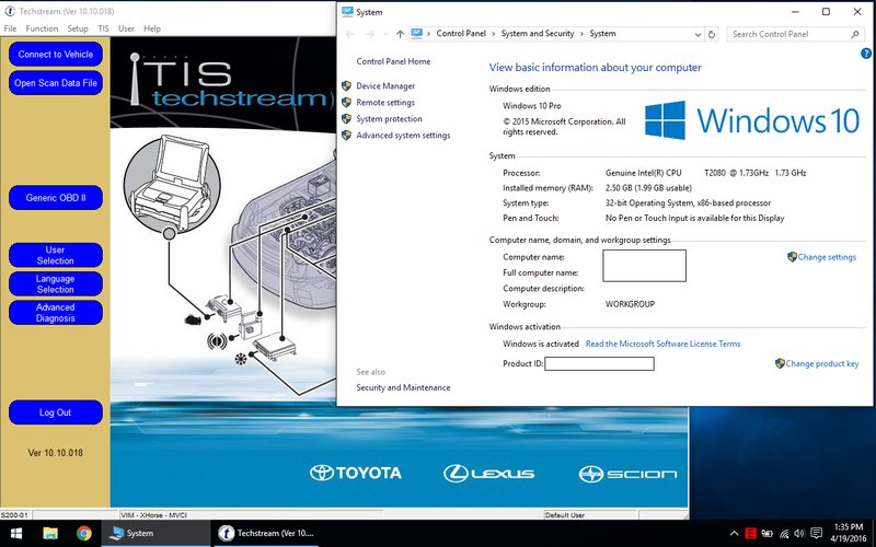

    Does not need XP, 32 bit yes. I am running it on Win10 without doing anything special, installed off the CD that came with it.

    So you have a 32 bit version of Win10 installed?
