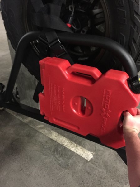

    @GHOST SHIP provided the best idea.
    I'm going to buy 2 pairs of these tube clamps, cut a plate out of aluminum that bolts to the clamps in each corner, and throw the mount on the plate for the rotopax.

    Aluminum too. if anything, the mating surfaces can be sanded down a bit to provide a more positive (tighter) clamp, but you'd most likely strip the aluminum threads before over tightening. I wouldn't trust one to not rotate on the tube by itself especially when something heavy is mounted to them, but with multiple clamps and some bracing (mounting plate), these should be pretty slick and work perfectly for @SixthSnail 's project.

    And with the can mounting there, it will be easy to fill at the pump without removing it.

    You trip is this weekend? If you can get the clamps in on time, we might be able to fab the plate and mounts before you go.

    I got same day shipping so they will be here tonight. Problem is that I don't have a rotopax mount right now. I gave you mine! haha. That won't offer same day shipping so it wouldn't be here on time.

    You can take the one you gave me for the weekend and just swap out when the new one comes in. I got you, boo. Let me know, I can get aluminum plate and get started on mock up using CAD (cardboard aided design).
