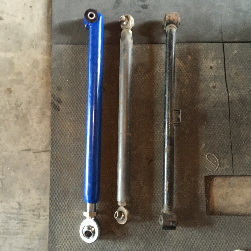

    Some personal perspective, I have gone through 3 different link iterations, and I will second AssBurns on the heims, they are the strongest and provide the most flex, but are a consumable and are expensive and noisy. Here are the different versions of links I have had:
    2" DOM w/ 1.25 heims and poly bushing / 1.75" DOM w/ 7/8 heims / stock
    All the heims fail eventually, I have been using Ruff Stuff heims, but they are junk with a plastic liner instead of teflon like FK ones, I will be replacing all of mine with FK heims this spring.
    Check out the Rokmen and Dobinsons (not sure if they fit a 3rd gen) ones too if you want low maintenance and better ride at the price of sacrificing a little flex.
