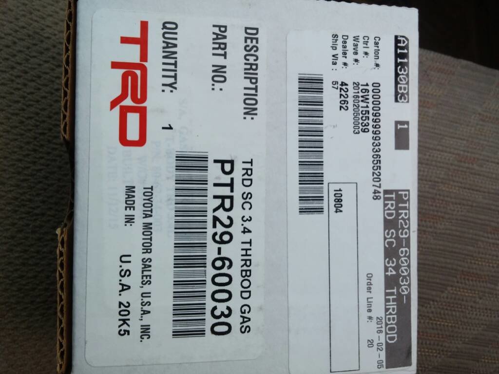

    Concerning those supercharger parts we talked about a few weeks ago:
    I got the gasket and the one way valve. Both with shipping was $26. I will install at some point today, but both look perfect.
    Toyotapartsdeal.com

    I talked to the guy that was fulfilling the order and he said that they are producing them still and have no problem fulfilling orders.

    The guy seemed annoyed I even asked. Like of course we have these parts.
