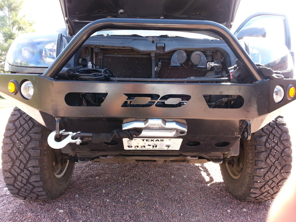

    Addition of the winch

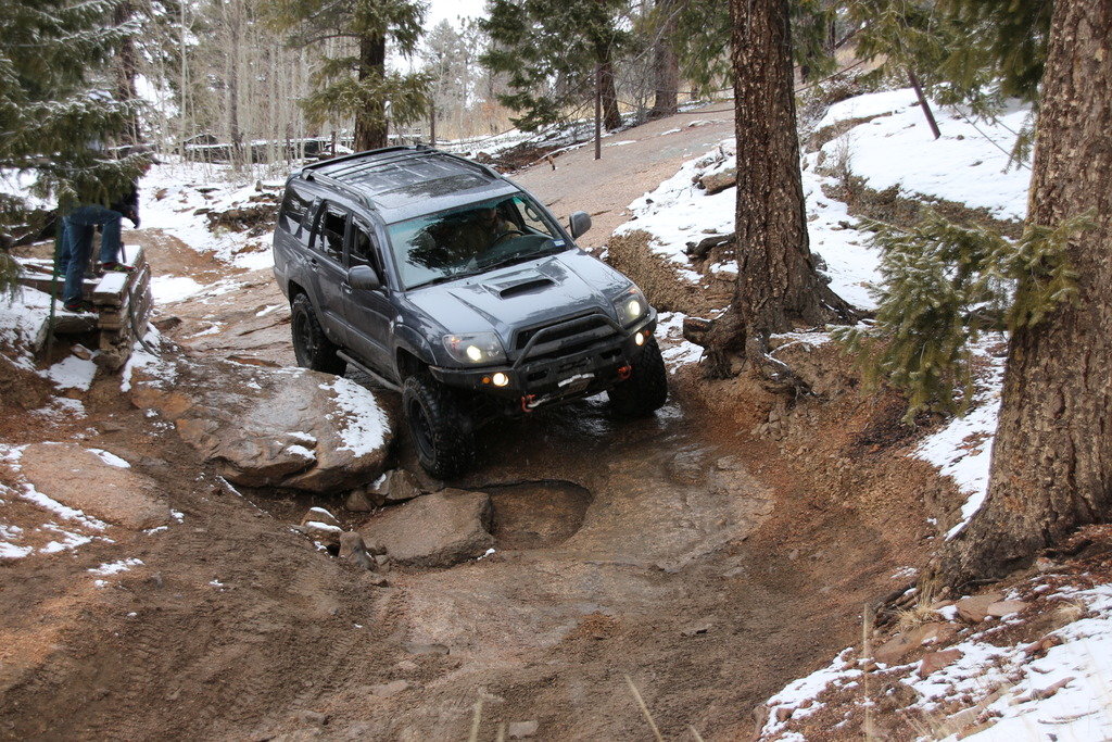

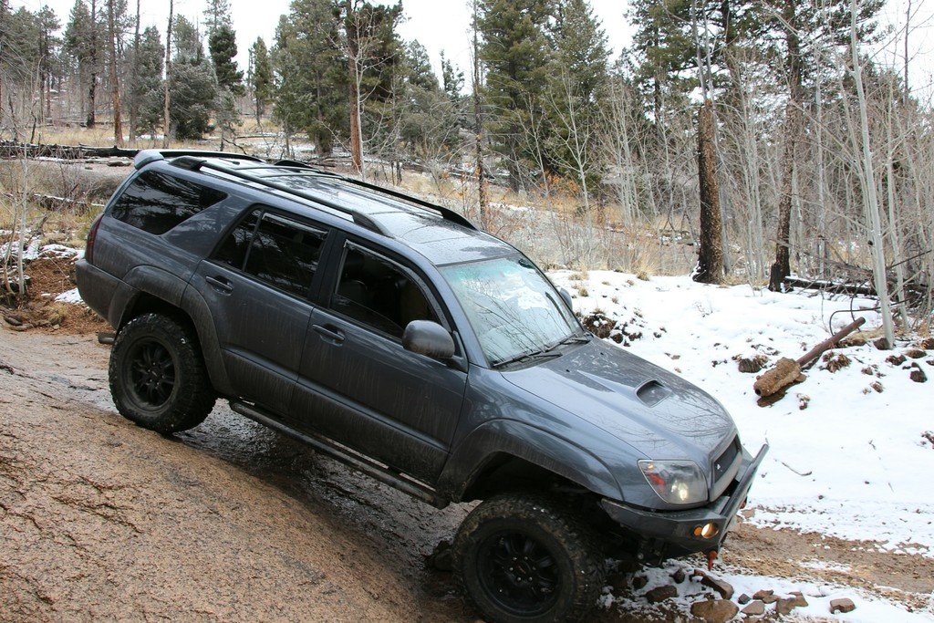

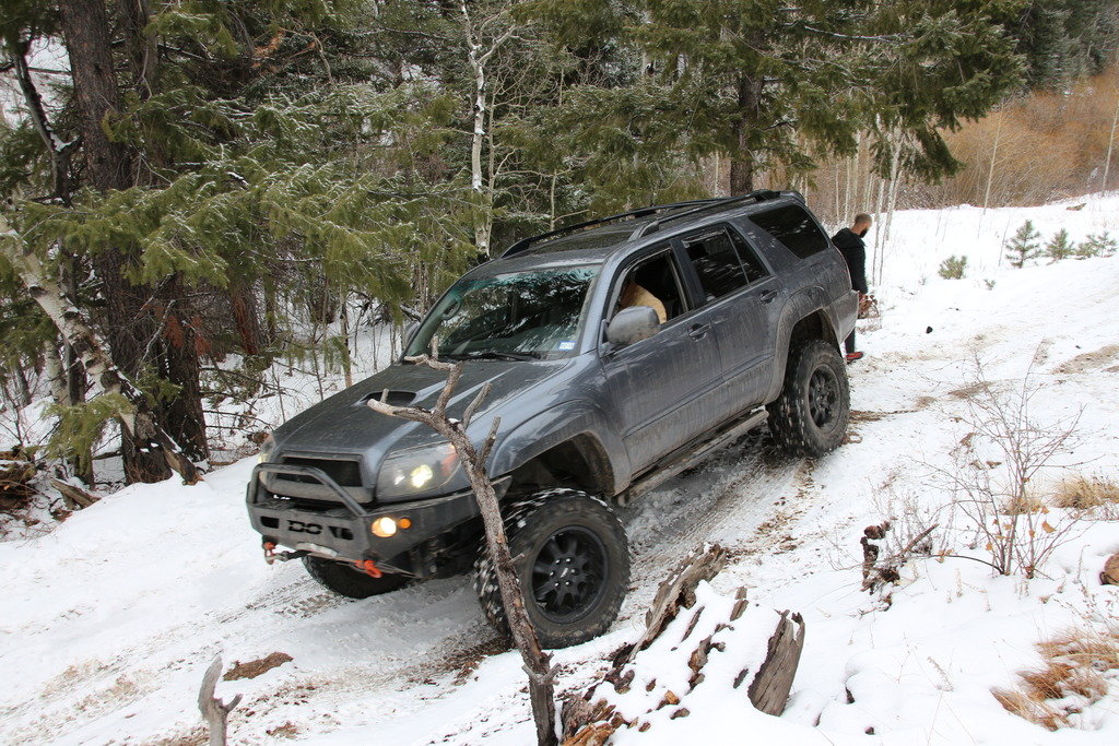

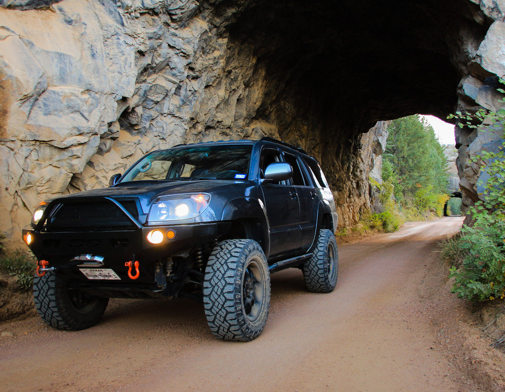

    And a couple obligatory wheeling pics from Hacket Gulch. I need to find all of my other pics...
    IMG_8566_6f7ebc0f1241d51d4334c7fd3860951d0442c8ae.jpgIMG_8562_53e748f44c64eca8e9a3be01d0eadf981fa4989c.jpgIMG_8647_1_7aca053c936c39aabc9935122a8a0cceffda5387.jpgIMG_8657_1_8899cebc06699d30f8dd2467565352837943fbb9.jpgIMG_8712_a9b521fb78a322f653a1ee2315a99ce0a4e34df0.jpg

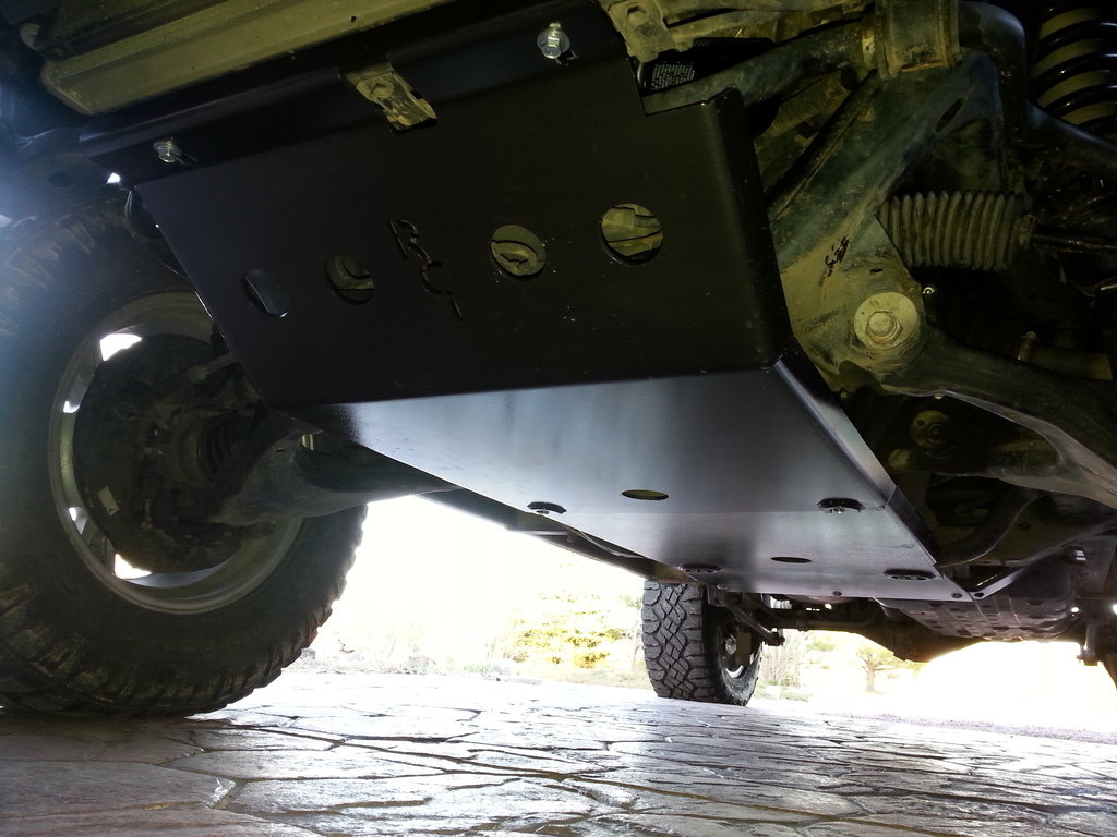

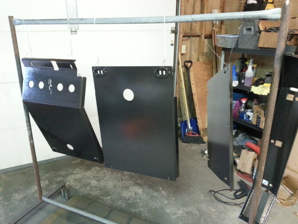

    So this past weekend was a busy one for me. I finally got around to getting my RCI skids painted up and installed just in time for some summer fun. I ended up using 2 cans of rustolium self-etching primer and around 5 cans of rustolium hammered black. I think it came out pretty well. It almost looks powder coated so I really can't complain.
    20150324_184603_7d6e757415484e2fb0a0488aff61476b029af913.jpg20150405_185222_df86e4e1acd69c7e2e40329e28e0083c540e509e.jpg

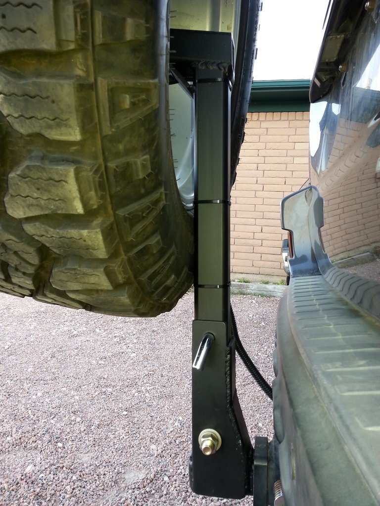

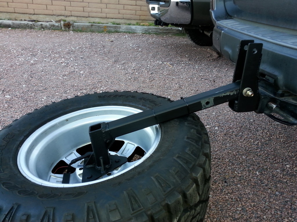

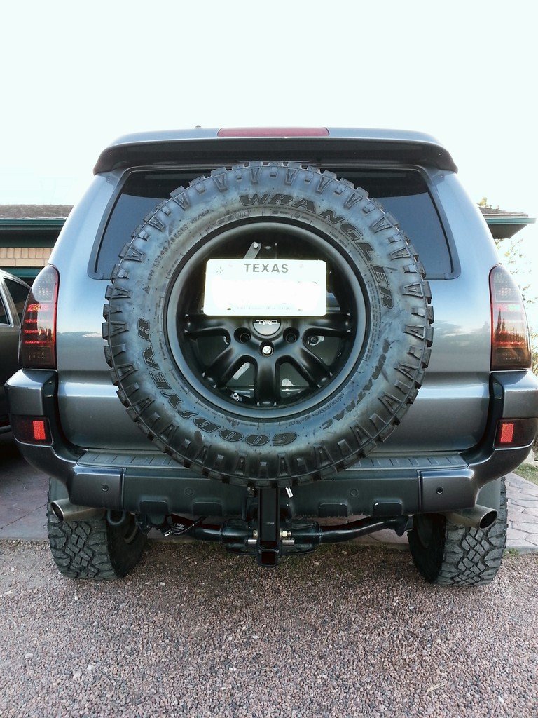

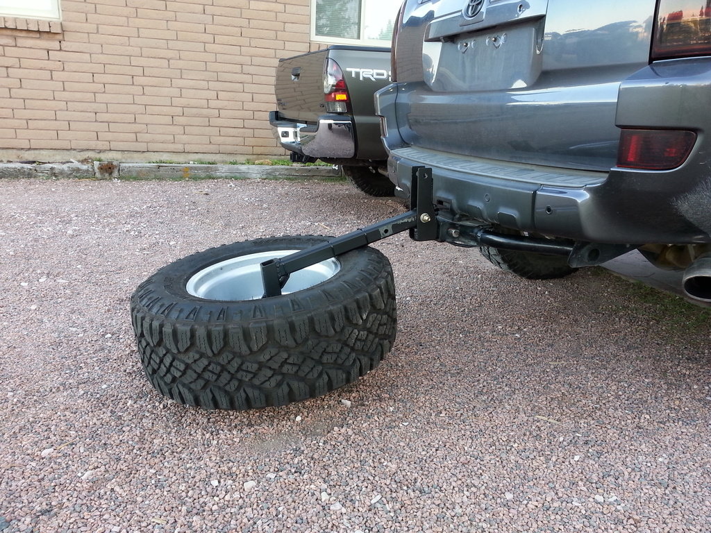

    I also whipped up a spare tire carrier for my upcoming trip. You don't realise just how damn much room a spare tire can take up until you get it out of the cargo area. Should have done this sooner! It is only a temporary fix though until I get time to fab up a full rear bumper and tire carrier setup. I already know it's going to kill departure angle even worse than the stock bumper did but it'll do for now.
    Anyway, here are some pics of it. I used 2x2 1/4in thick square tubing and 1/4 in plate for building the whole thing.It is super sturdy and doesn't wiggle or rattle at all thanks to the tolerances being tight enough and the use of a couple bolts to pinch the carrier into the hitch receiver. I also ended up having to make a lighted licence plate bracket to keep the plate out of harms way.
    20150405_185327_f708f823561cb562e36d8d9248bef496152c920d.jpg20150405_185407_1_6a432c4074652772d655478591052ed20611e30f.jpg20150405_185425_1_153ba6db8842e4c88a632e084731e31dcc61c41d.jpg20150405_185639_efad080eb173bc20b2b6b1245d082a4ad5a4573d.jpg20150405_185655_f5c7bbfc7e76522062a47806b0354a768d1dd108.jpg
    If you noticed the paint wore off, that's because I was impatient and had to put the carrier on and test it out 3 hours after I painted It.... lessons learned.

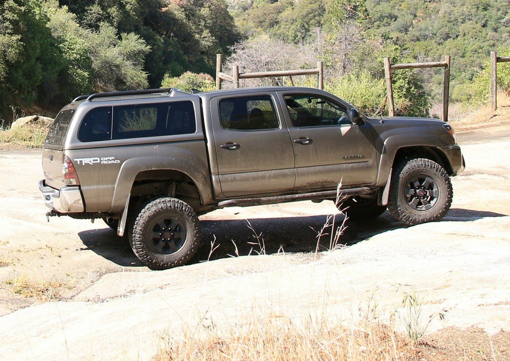

    And a couple more because it's my build thread and I can... at Pismo Beach Pier
    And at Sequioa National ParkIMG_9424_3c57496d6664fcde1f2e4fda484b324eb1d7b700.jpg
