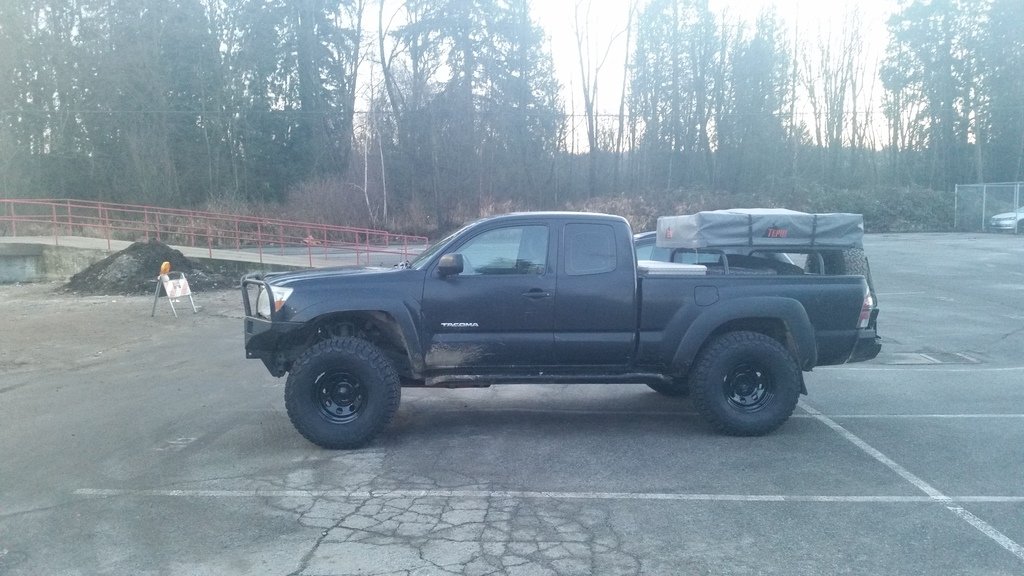

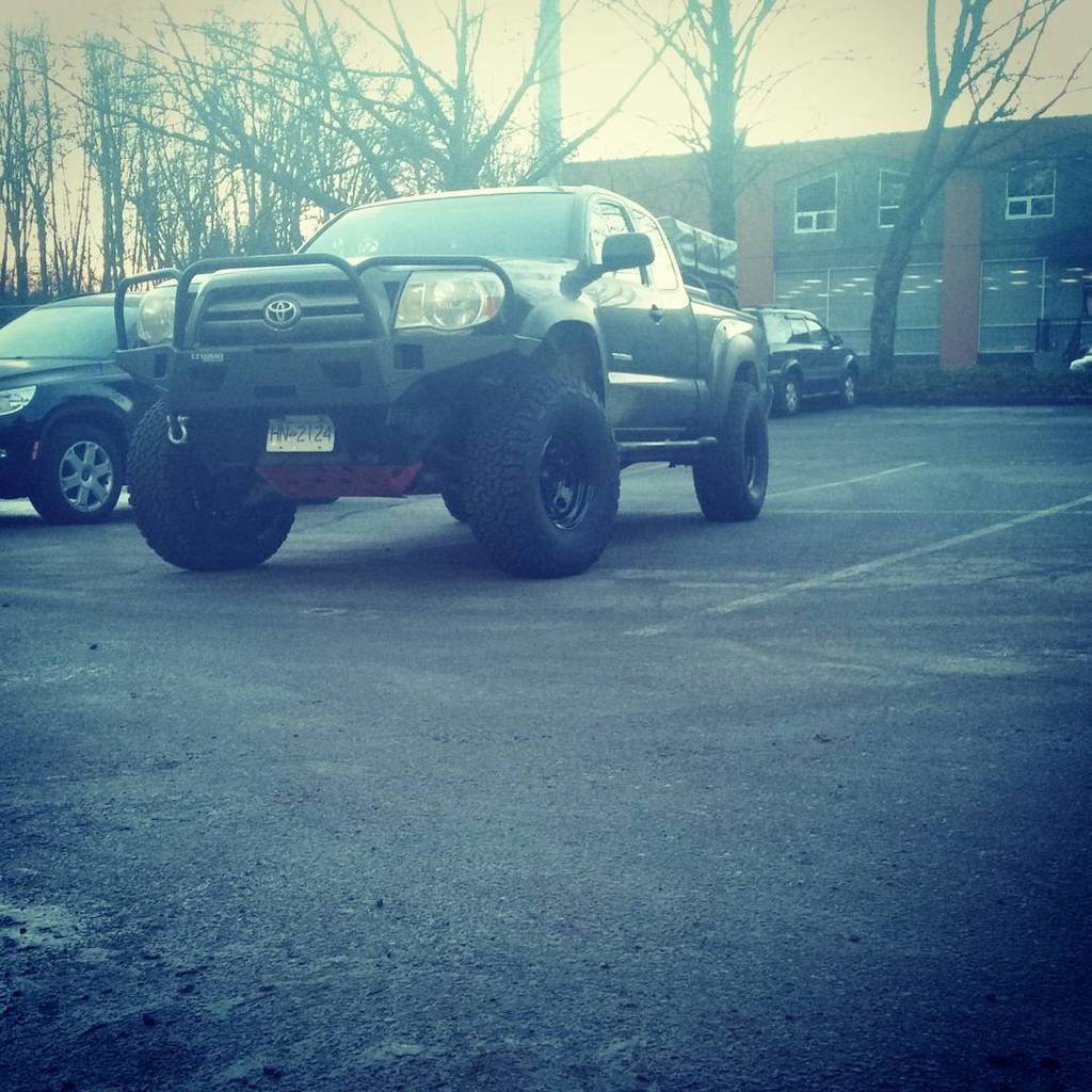

    The tires are bfg ko2 315/75R16 the Rims are Pro comp series 97 16" 4.25 bs and I love the way she looks now been breaking necks all over town

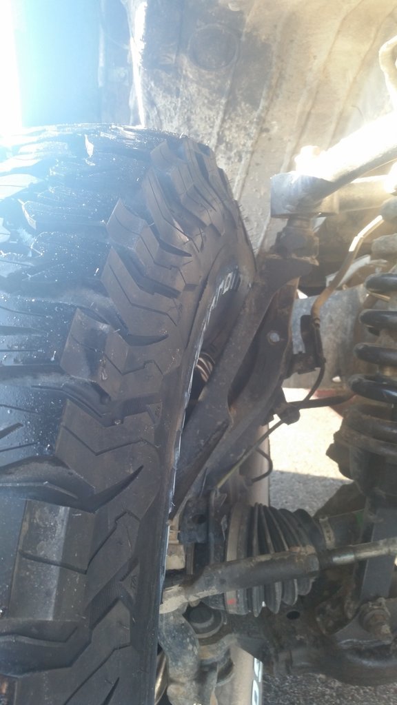

    Interested to see how the KO2's do with 35's on the 4 banger. do you think you'll need any more trimming or beating on the firewall? Spindle gussets? I'll be getting new shoes soon, wondering if I should bump up a size...

    On the front I'm good on the street lock to lock well see how she does off road... the rear I'm gonna need to do the shackle flip it changes the angles enough so I can get away with maybe only trimming the rear inne liner and not the fender. That's my hope at least. The Rims at 4.25 are the same as my stocks with the spacers so I should be good there as well even aired down

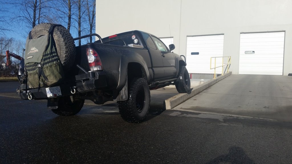

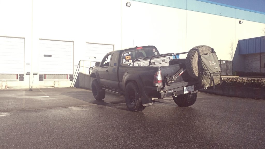

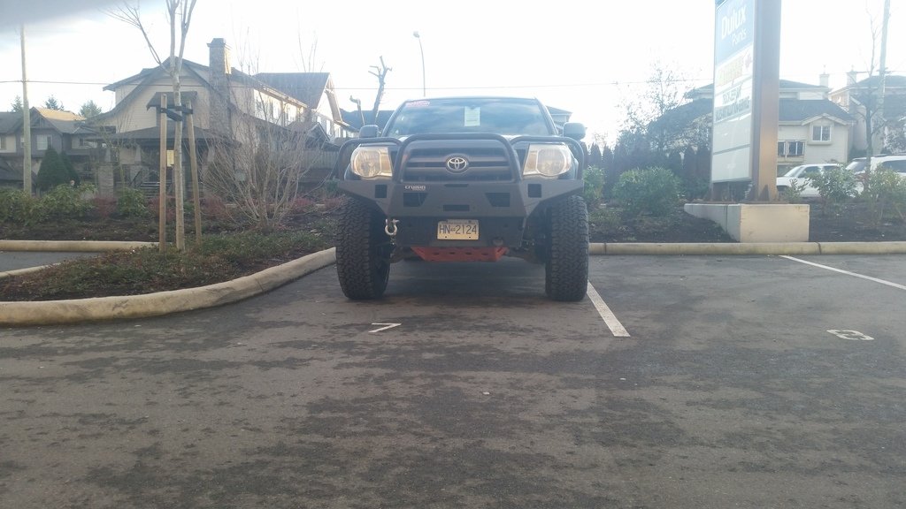

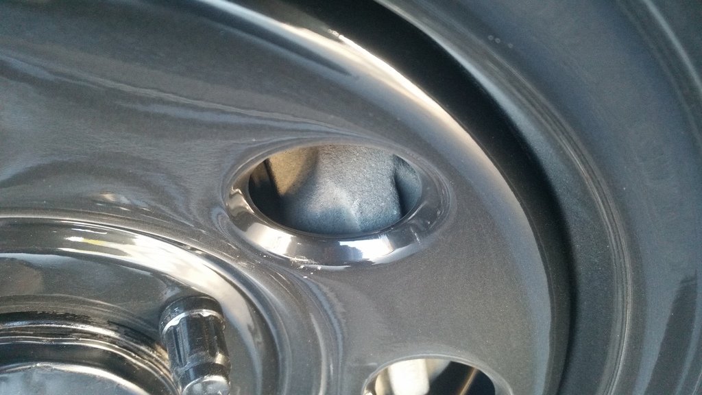

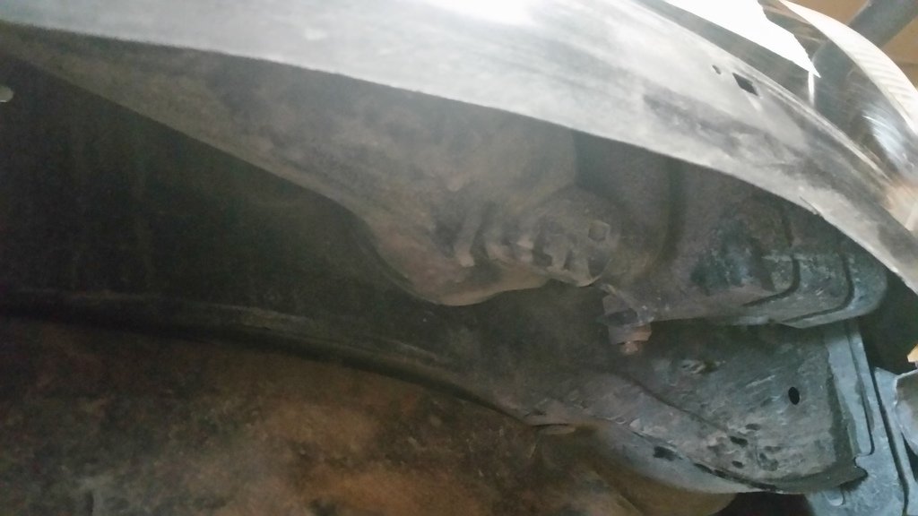

    Checked for rubbing and aired down the tires to see if I was gonna have issues holly fuck it's close lol rims clear the calipers by a c hair and the tires cleared the gussets when aired down to 15psI

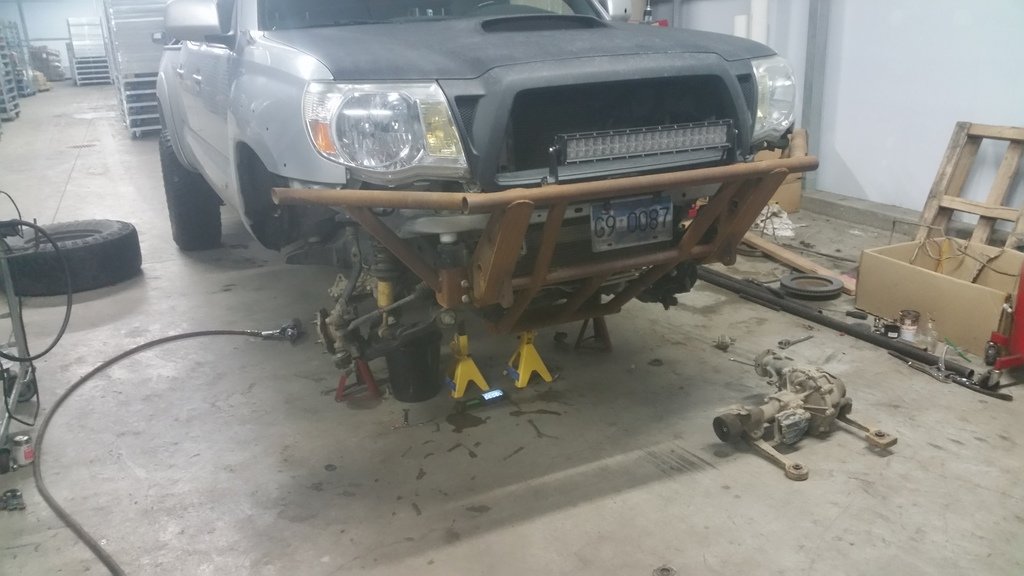

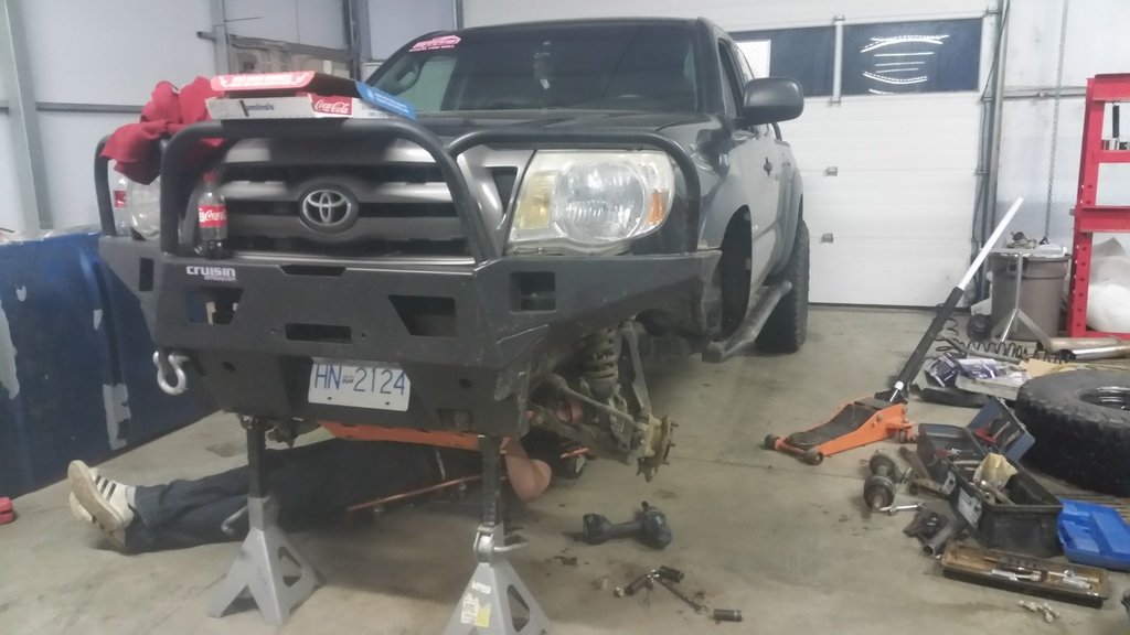

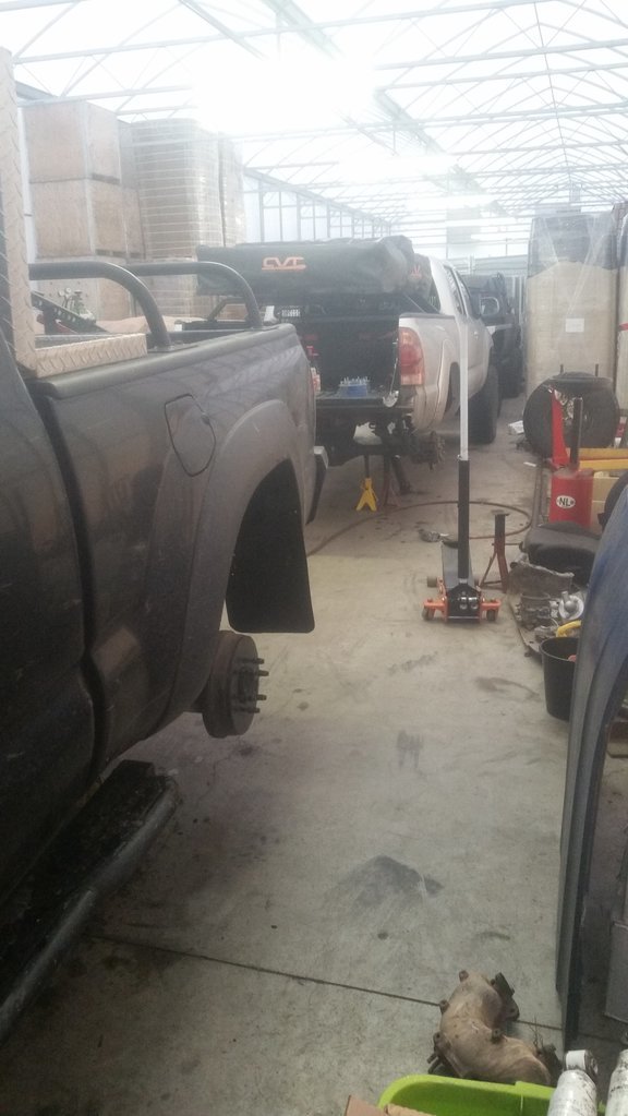

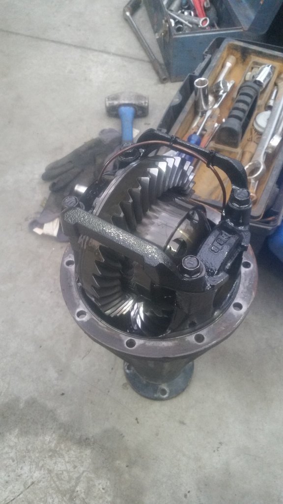

    Well it was a good 10.5 hours in the shop but we got the arb and 4.88 diffs in my truck and my stock 410s are now with @thekernel114. I didn't really take much for pics cause too us turning wrenches but here's what I have
    I've still gotta find a spot for the compressor and get it all plumed in and working right. So far though everything is great. Love the gearing with the 35's it feels great to drive no more clutch riding

    how hard of an install doing the gears was it yetti? pretty straight forward?
  9. Jan 18, 2016 at 3:48 PM
    #209
    TYetti
    TYetti [OP] 4cylinders of awesomeness
    Mar 8, 2014
    #124858
    2,343
    Mat
    Abbotsford, BC, Canada
    09 Tacoma AC 2.7L 5spd 4x4
    I cheated, we swapped the rear third put of the silver truck which contained the 4.88s and locker with my stock third and 410s. Same with the front diff. Setting up gears is advanced and takes a very persice understanding of what your doing. Since the components are so pricey I leave it to pro's. As for swapping the diffs well its just a bunch of unbolting and removing of plugs etc. I'd have liked to have taken pics and done a detailed write up but we both needed our trucks running at the end of the day so it was down to business

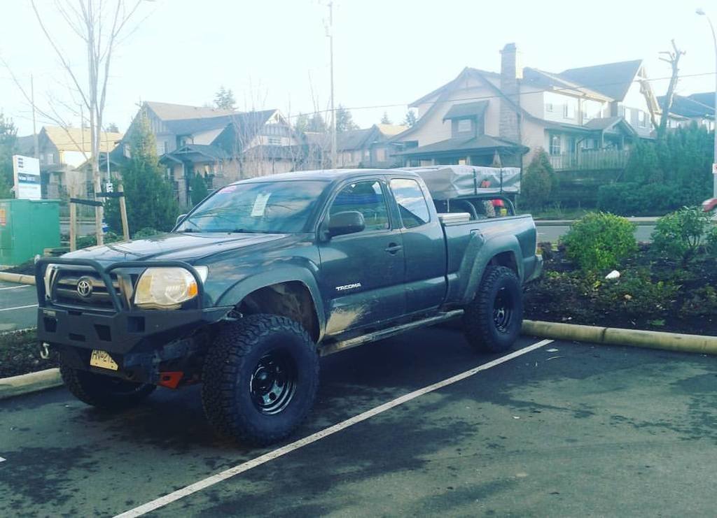

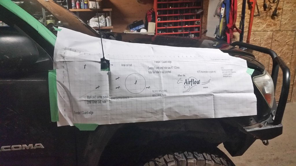

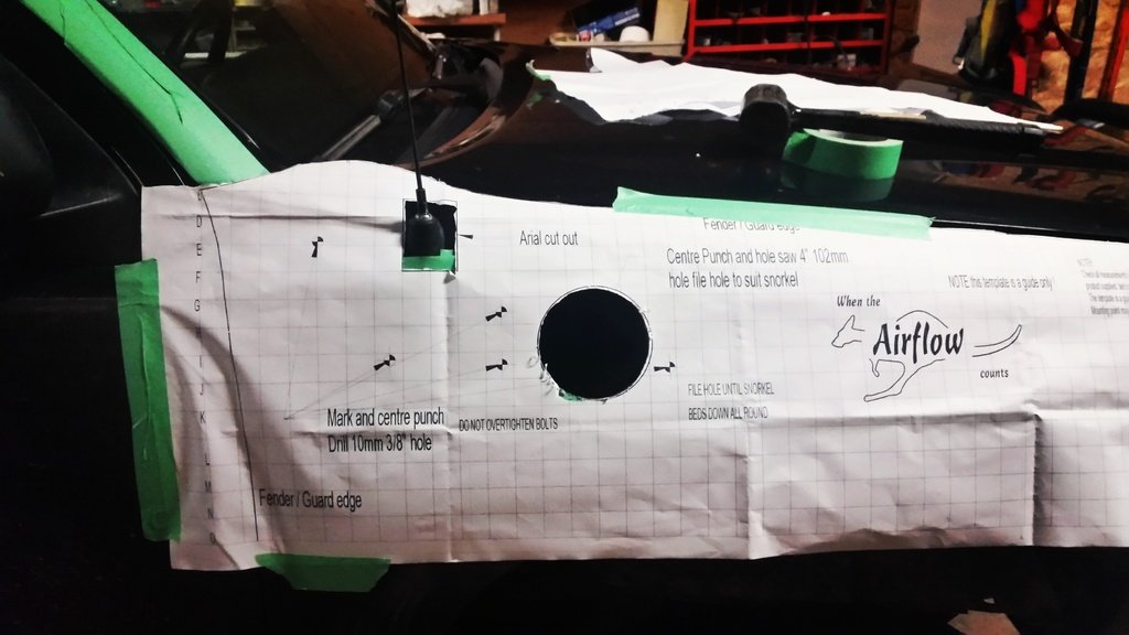

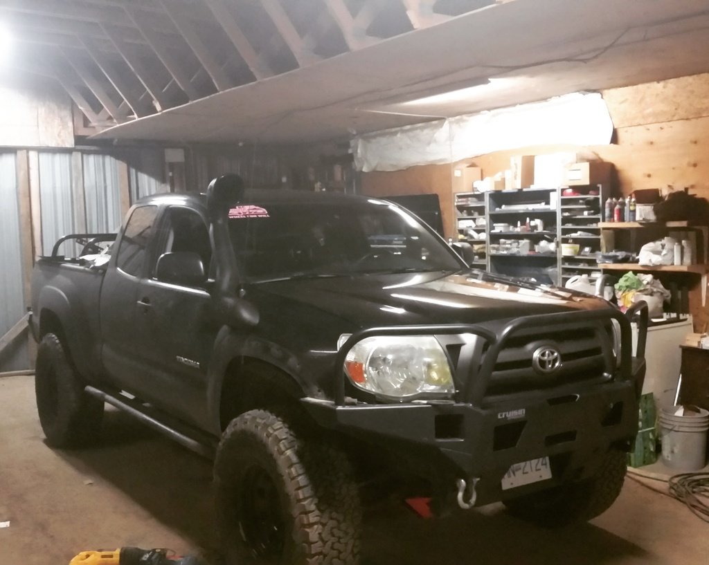

    My snorkel arrived today and after work I decided to put it on, to solve my intake issue. Now I cannot stress this enough the template is only a guide and when you put it on the studs might now not be where they're supposed to be. That being said I only had one hole I had to enlarge a bit. Overall this isn't a terribly difficult install just a pain in the ass.
    I started by masking off the fender and a pillar

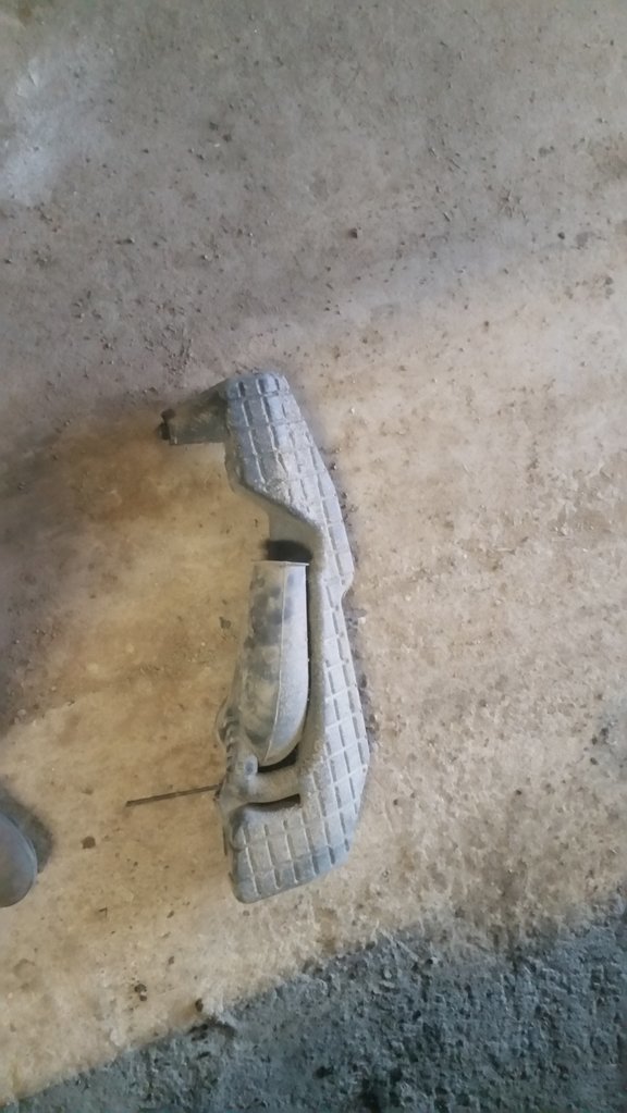

    Then I took apart the air intake only to find this contraption
    Then I lined up the template
    And cut
    After this I put some paint on the studs which had been drying because I locktighted the shit out of them. I then touched them to the paper and then used a punch and drilled out all the holes. This is where I took the instructions and threw them out its no so easy for the 4cyl. Youll need to take the fender off, I left the Antena attached allowing the fender to kinda rest partially on the ground against the tire. Next I cut out the weird support bracket until the 90 pipe could fit without issue. Then I used some sealant on the longer of the two 90s and stuck the long end through the intake hole in the truck. Now attaching the oem box. Once that's on use the supplied flex pipe and clamps to attach the other 90 at this point you can throw the fender on loose, and begin fitting the snorkel body on. This is the hard part Yu just gotta work it till it goes on and you can thread the bolts onto the studs. The upper stud I couldnt get too cause my hand was too big and didn't wanna take the fender off for a 5th time.. I gotta reattach my flare, and tidy up a bit but the fit is awesome I'm super happy with the snorkel... I haven't decided if I will use the a pillar bracket yet either
    Finished for now

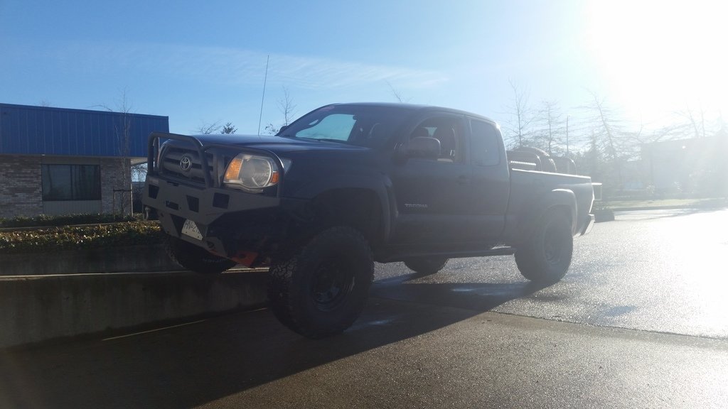

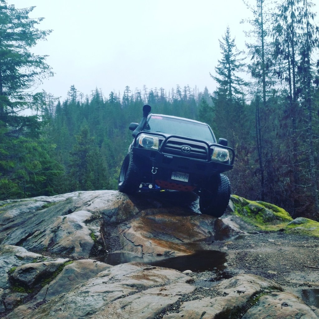

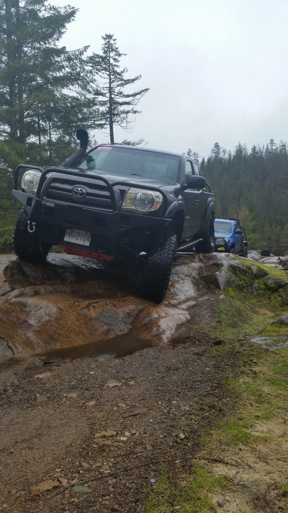

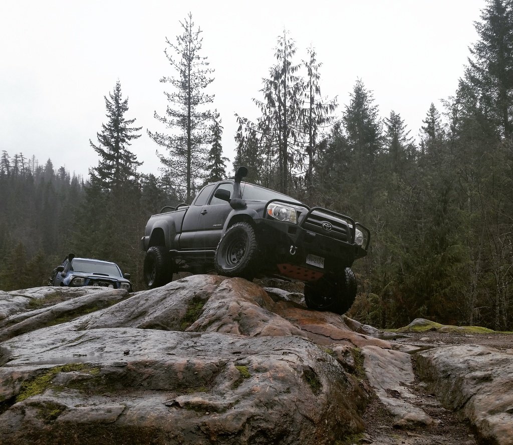

    Snorkel and tire test was a success

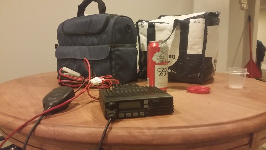

    Ok so adventures in VHF radio. Scored myself an icom f121 mobile unit last weekend, and picked up an antenna whip and cable today ended up going with a Larsen wide band as per the radio store guys suggestion. While running the cables I found out my floor was all wet on the drivers side. I think I got a little carried away when hitting the pinch weld anyways I siliconed the fuck out of it so I'll have to keep an eye on it. But I got the antenna set up on a fender mount, couldn't finish the radio though..I also picked up a set of oem leafs I'm gonna add another leaf to my pack so when I got the rtt on I don't sag. I've got a lot of little projects to do before the 24th of march as my truck will be making an appearance at the Vancouver international auto show as part of a display and the day after that I leave for my first multi day trek of the year
