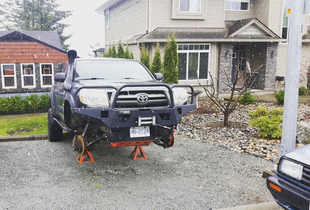

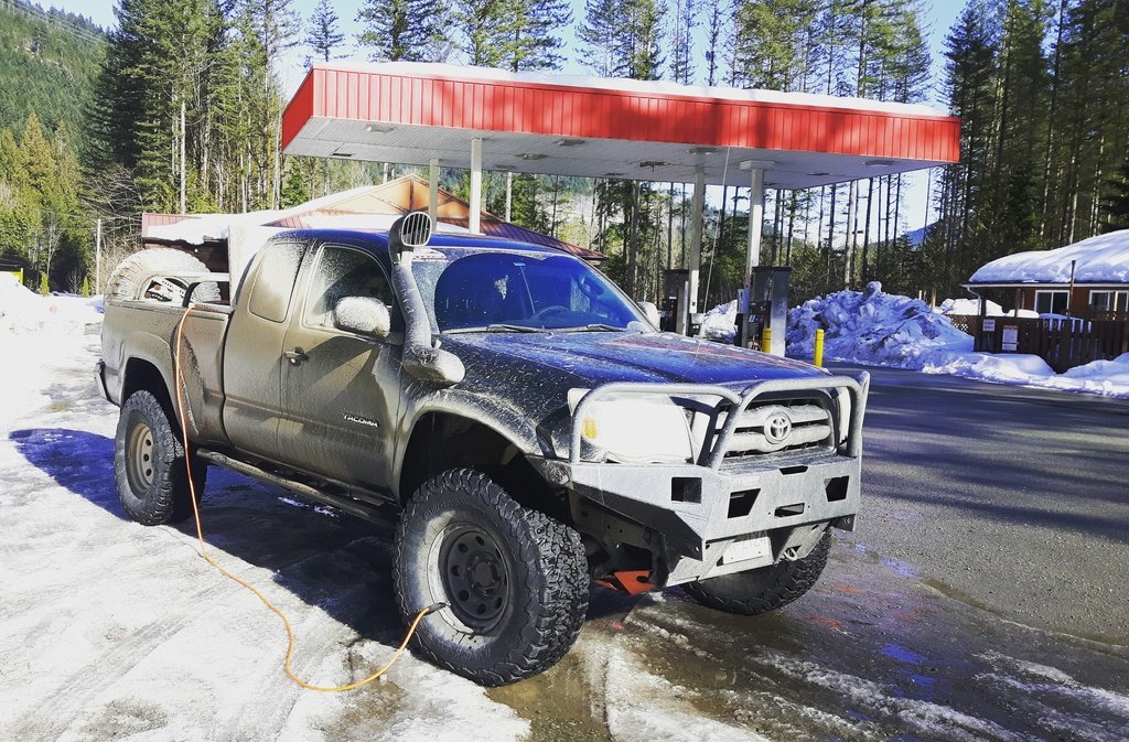

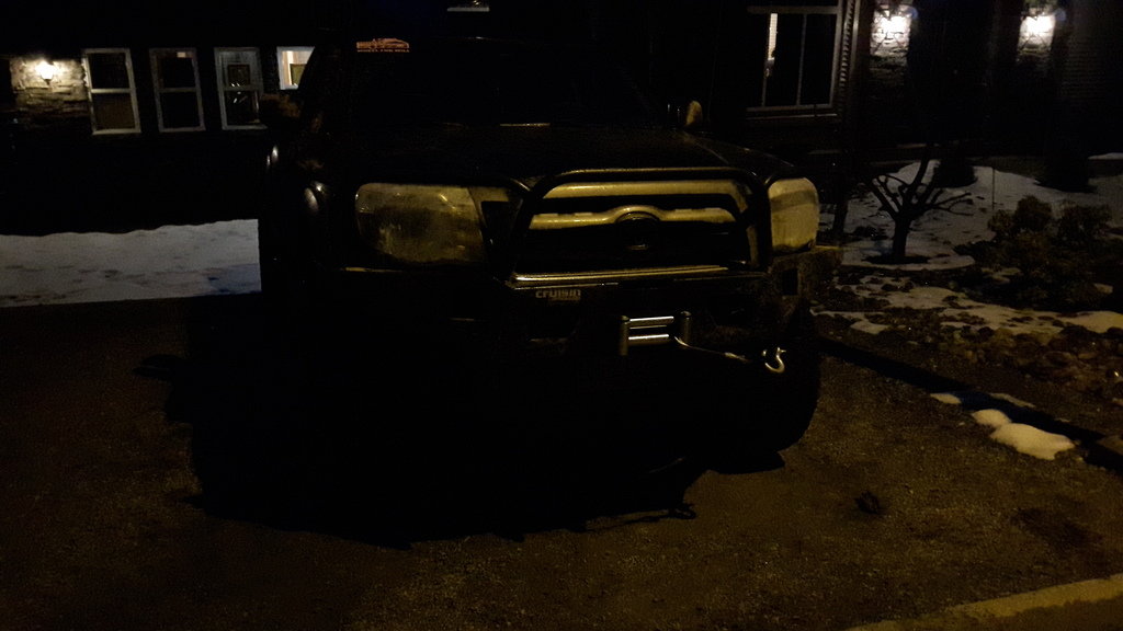

    I finally did something. After spending 3 months on my floor my winch is finally on the truck lol.... long story short I went to try and run some trails Monday and couldn't get more than 10 ft and got annoyed cause if I had a winch I could be more aggressive and ya went home and tossed it on.
    Post wheeling glamour shot
    Worlds worst update photo
    I still have yet to change out coil springs and wow can I feel the heaviness in the front end now...

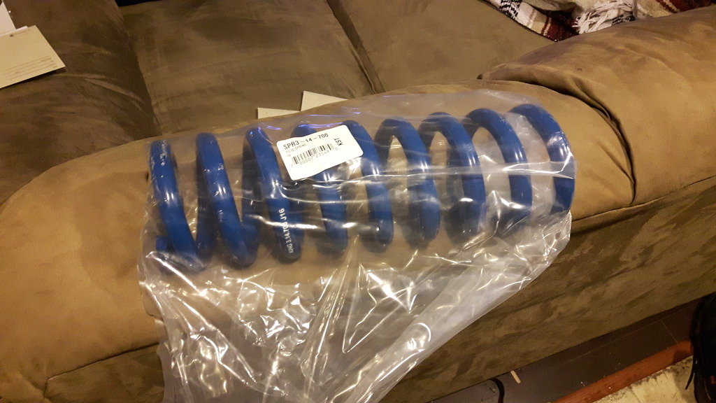

    I did a thing

    You give us 4cyl 4x4's hope lol. How does the 4.88's handle the 35's? I was thinking about going that route on my access cab
    Taka The Tacoma and ecgreen like this.
  8. Feb 16, 2017 at 8:43 PM
    #388
    TYetti
    TYetti [OP] 4cylinders of awesomeness
    Mar 8, 2014
    #124858
    2,343
    Mat
    Abbotsford, BC, Canada
    09 Tacoma AC 2.7L 5spd 4x4
    Perfectly. My truck felt like it was close to stock again. Keep in mind my truck is a fat bitch tipping the scales at 5100lbs but it still gets 22mpg on the highway. Also if you're gonna regear lock the bitch up totally worth it

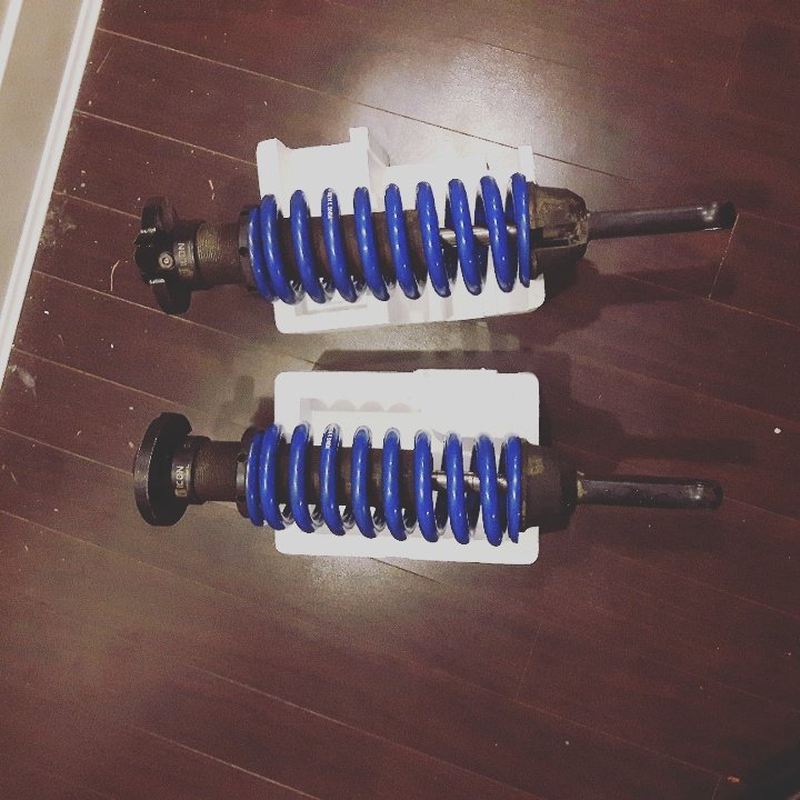

    Soo I did the hover truck conversion
    Actually it took a day of lubing and a 5lb sledge to get the bottom shock bolts out of my icons in the process the lower bearings exploded luckily I had spares from FK bearing. The shocks are at Big Country Customs right now being cleaned up and having my king 14" 700lb springs put on

    Got my shocks back. Actually more like I finally got off work early enough to go pick them up. Waiting on new hardware from toyota and I'll be messing with these most of the weekend. Gonna have to play with the preload once I get them on the truck gonna back them off to probably 1.5 " and start there
