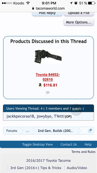

    That switch is 09 and up... some of the electrics changed in 09 so just be aware

    Your link provide the first item discussed in your thead lol!

    Lol I know.... yet I've discussed so many items just didn't post links

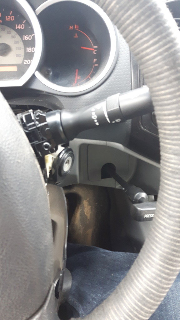

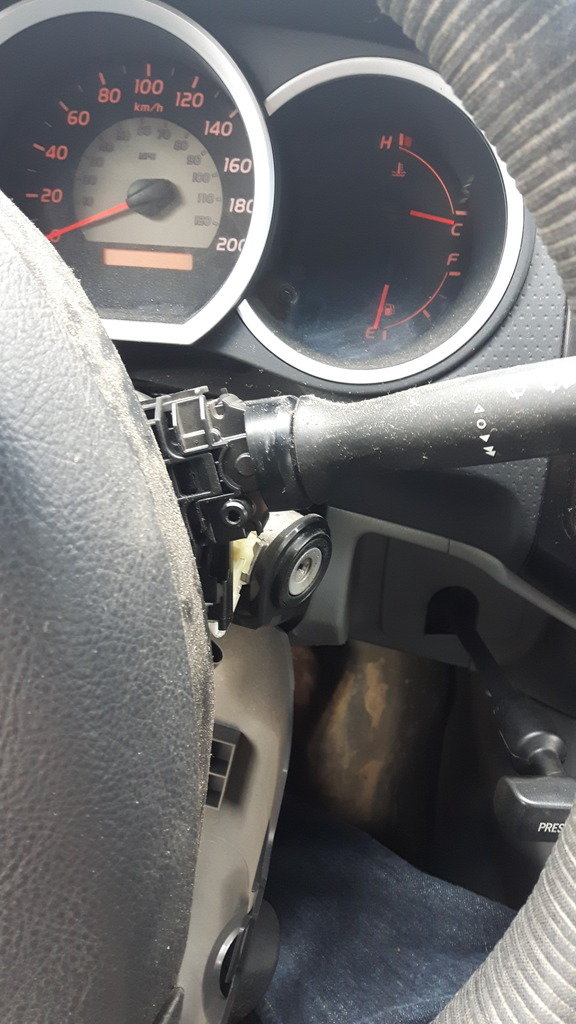

    It's the simple mods that make the biggest difference
    Before
    After
    Legitimately a 5 minute task

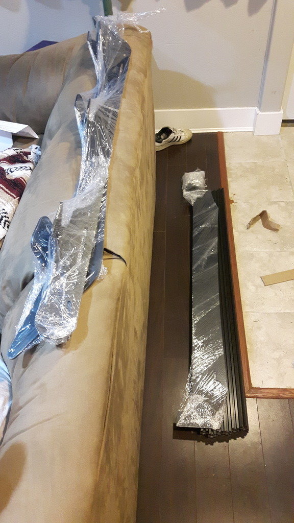

    Also this thing showed up
    Too bad it's raining and my shop is full of boats

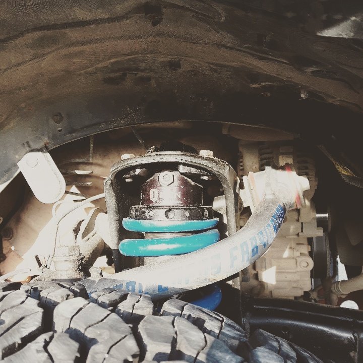

    Well I'm about to start working on my bungled shock situation.... after installing the kings it came to my attention that with the ride height set the way it is I have 0 down travel as the springs are making out the front end with 1.75" of preload. Easy fix right ? Wrong!!!! The set screws in the adjustment collars are dicked I bought am extractor kit the other weekend but I also broke two fingers at work so I've been sitting on this. Worst case scenario I'll have to send the shocks in for repair.

    Coilovers are super dicked sending them out Monday.

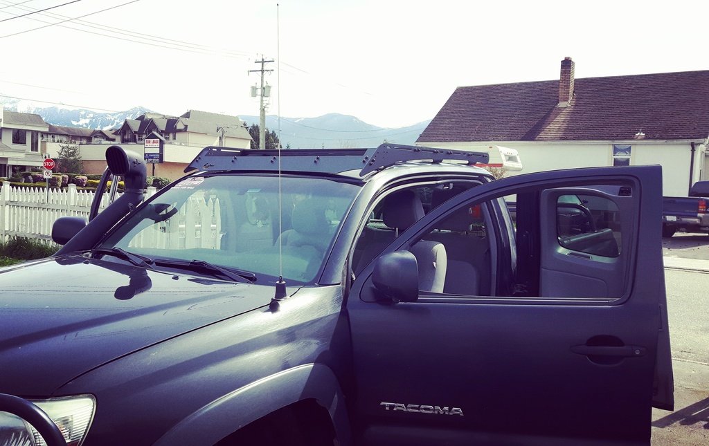

    My shocks finally came back Saturday, after two missed delivery dates, I got the call Saturday afternoon to come pick them up. They ended up charging me the absolute minimum as an apology for dropping the ball so that's always nice. Now that the shocks could be adjusted because all the adjusting hardware were replaced. I finally found a preload setting that works..... None, I have absolutely no preload and I'm sitting at 3" of lift
    So if you wanna use 14" 700lb springs on a 4cyl have no preload lol.
    Now with my truck back on the road and it being sunny and 18c (finally some warmth) I headed over to my buddies place and we got to work on the prinsu rack install. Pretty basic just gotta drink a beer and get over the fact you're gonna out 12 holes in your roof. Had to encourage some clearance on the air bag bracket near the rear hole on the back of the cab, but nothing serious.
    PRO tip: drill a pilot hole and step up to 3/8ths. If your drill has a clutch set it low so when it starts to go through the sheet metal it prevents the bit from catching and drilling through airbags and the headliner.
    It's starting to rain so I'll find out quick how sealed my roof is... I'll have more pics once I get the weather stripping drilled out and back on.

    Awesome 700# springs are definilty on my list. I feel I have too much preload with the 650's. Also I seems like you did the prinsu install without removing the headliner. That's good news to hear.

    I did manage to get it done without removing the headliner but it depends where your curtain airbags are and wires etc. I had to use some picks to move stuff around but it all worked out..... good news it rained last night and my truck is dry inside
