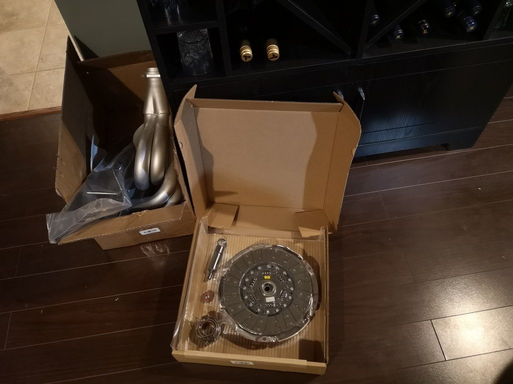

    LCE header is probably my next mod. Interested to hear your take on it

    Lots of weld splatter on the tubes near the collector. Honestly for what they charge I was expecting a little more finish to it. At the same time my truck is all function and little form so as long as it performs when it goes on the new engine thats all that really matters. The metal gasket that comes with it is a very nice touch though

    Curious why you did not choose the doug thorley headers for the 2.7? I'm often in this debate myself, LCE, or DT...
    you are going to like this clutch, I just swapped this into my truck in the summer. Took a good 2500 km's before I felt it was truly broken in.
    Also, bummer about your rings. I have 400k on my 2.7, but it was all highway before I got it
    :popcorn: Subbed for outcome, you seem to be doing things I'd like to do, and the cnd factor helps :canada:

    There's a header comparison in the 4cyl section, but also the equal length tubes are better for low end torque which rolling on 35s I need. Well that's good to know about the clutch, did you use the OEM flywheel or swap to an aftermarket one? The engine will need some break in as well so they should both be ready around the same time. This seems to be the way with the 2.7 some go forever but more and more I see them with blown rings misdiagnosed as something else.

    I too saw that old thread with dyno results in it, LCE came out a winner, no doubt. I was just wondering if you had any other reason ( besides giving all your money to LCE this Christmas :rofl:)
    For the clutch, she was done in my driveway with a friends help. We re-used the factory flywheel, just had it re-surfaced at a local Machine shop. Pics of the hotspots can be found here.
    its a nice kit, I bought the flywheel bolts from them too, If you ( or anyone else reading this ) did not know, the flywheel uses 14mm 12point bolts. That was a nice surprise since we had to run around to find one :)
    honestly it was straight forward with the removal and re-install. for install, a motorcycle jack was pretty handy. We used a sheet of plywood with a hold drilld in it to clear the bushing on the bottom of the tranny, and a 2x4 towards the front to keep it balanced/ nose up to help with the install.
    sorry if you know this already but you'll need some pretty damn long extensions to reach the top bell housing bolts. The ones we used were longer then the whole tranny.
