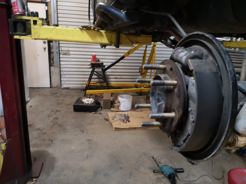

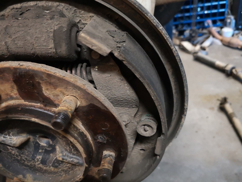

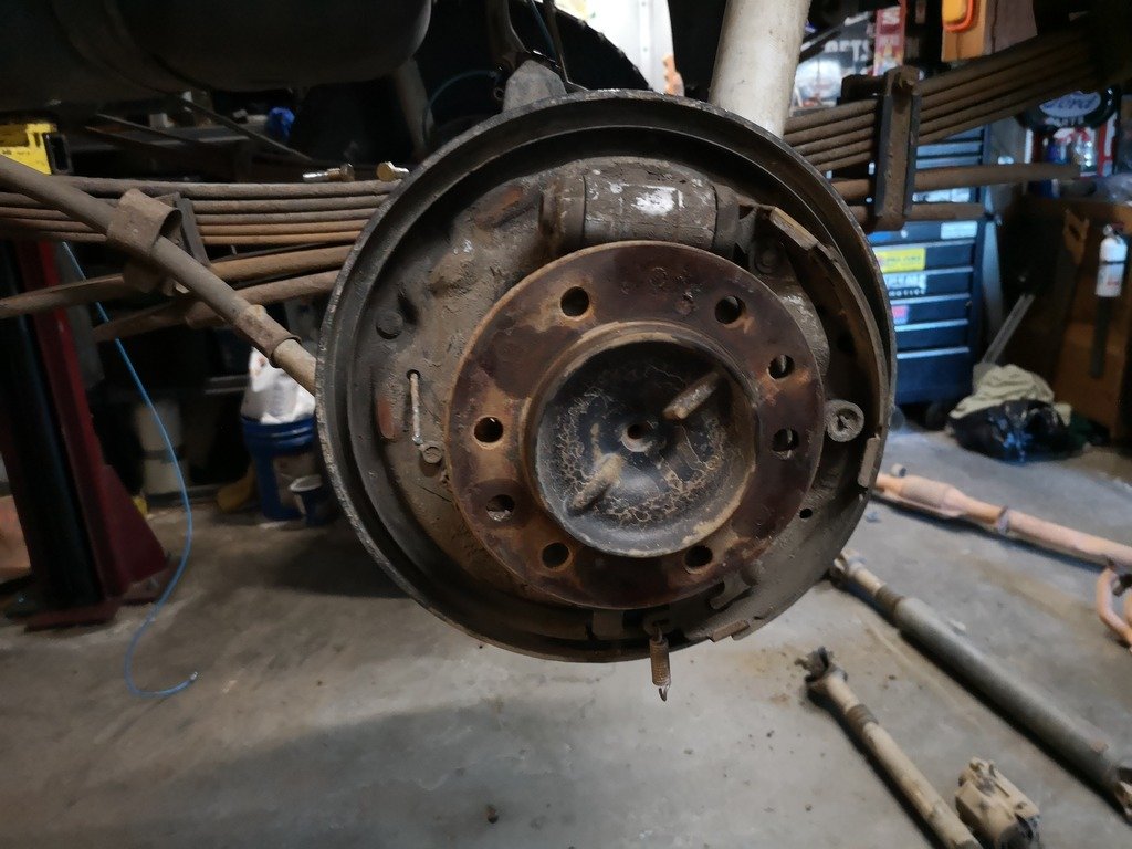

    The oe studs bash out really easy. The only problem is the arp studs don't fit between the axle flange and the backing plate. You'll need to drill a 3/4" hole to slide them in. Next you'll need to make a spacer and use an old Toyota lug to pull the studs through and seat. Now i wouldn't recommend this with anything but arp hardware. Also lube the shit out of them so they slide in nicely.
    Rinse wash repeat for the other side. The fronts are way easier just pound and seat the new ones

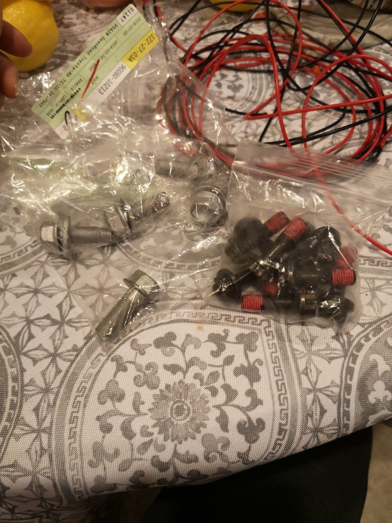

    I ordered some OEM hardware, mostly for my front skid but I also picked up two caliper bolts(the other one is on the truck) because I was still running the caliper bolt from the 85 lol that we slapped in there on the side of the interstate in Oakland. Also got some LCE flywheel bolts, nice that they come with red locktite on them already!!

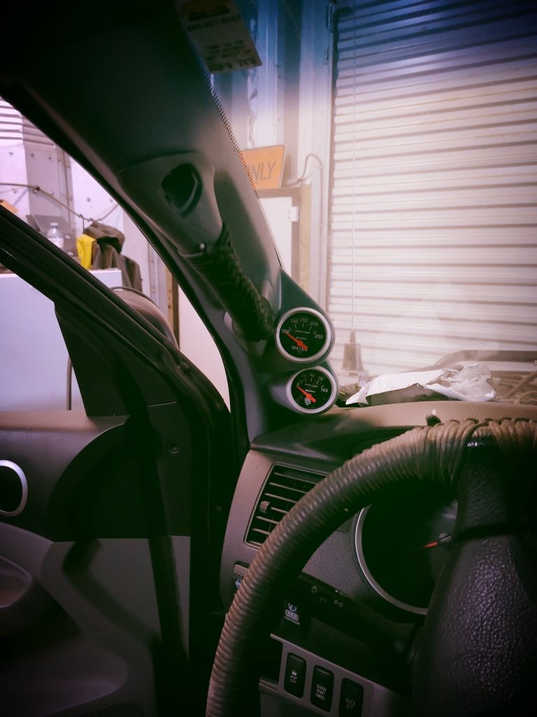

    Made myself some pretty wire harnesses and got this thing installed. Can't finish it until I get power back in the truck. I'm still not happy with this pillar pod. But I'll have to live with it for now. Even more trimming took place around the grab handles, it's still pinching it so the bolt covers won't attach which bothers me

    Thanks for the info on the pod as I am wanting one myself. Mine is '15 so I knew there would be fitting involved.
    I like the look and functionality of it but wonder if it will block your vision any?

    Not at all, I mean I could trim it more but the more i fuck with it the worse it gets, I already went slightly too far on the bottom hole. Just such a piss off, I may change it to steering wheel mount later but I liked the instant info at a glance I don't wanna be looking behind the wheel for info

    Glad it does not block your vision and I agree this is far better than a steering wheel mount.

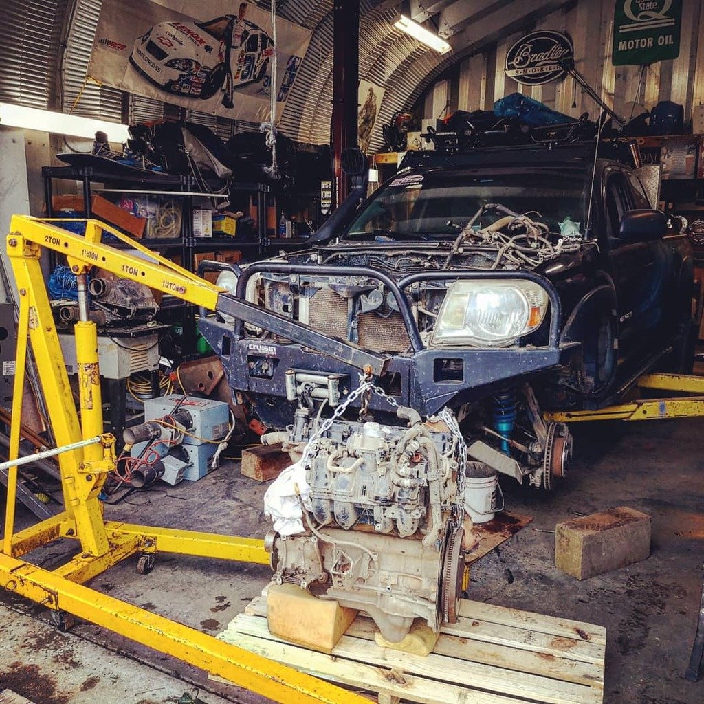

    I stopped by today, sounds like the engine should be ready for pickup late next week. Realistically I was told 10 business days. It's been 11, however can't count the day I dropped it off cause it was the middle of a 48hr snow storm, so knock two days off, a lot of the parts had to come from Toyota wearhouses stateside because 4cyl tacomas are rare here, which he told me about upfront, a lot of them came from Chicago which has had some crazy weather too. He's waiting on a couple more parts that should arrive tomorrow or Friday and then final reassembly.

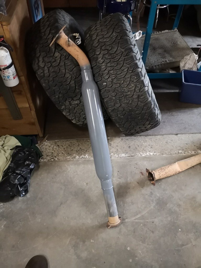

    I also got my exhaust solution sorted out. Took the cat section of the exhaust to a local shop told them I want the cats gone but I wanna keep the top bent and rear flange, but I'd like to add a resonator. 100$ + tax and boom done and done.
    Soo much braaaaapppppp will be had lol

    That’s cool at least they aren’t just putting you off.
    I am a machinist and our shop builds for our shit and lots of times outside work seems to get skipped.
    Weather has been crappy and chit is delayed all over.
    Also did you ever think about a catch can to slow the build up?
    I was looking but don’t think they are good in our below freezing temps?
    Ha the exhaust are you staying street legal?

    Ok so catch can on an NA vehicle is no bueno imo, cause all it does is catch moisture and it mixes with the tiny bit of oil that gets in there and ya it can freeze cause theres so much moisture content. On a boosted application absolutely catch can cause the boost can actually pressurize the system and the catch can will worth and little or no moisture has a chance to build up.
    My truck identifies as legalish. By removing the cats I've technically committed a crime. But the local Buford T Justice's aren't the most savy sooo I'm gonna pass my resonator off as a cat because I've retained the O2 sensor I think it'll work if I'm ever asked. We don't have emissions inspections anymore. I'm being more green cause with plugged cats my truck was inefficient now that problem can't happen again lol
