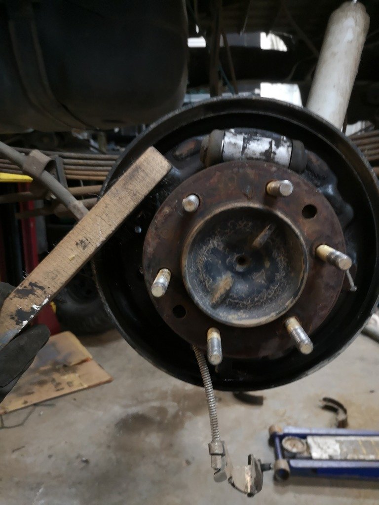

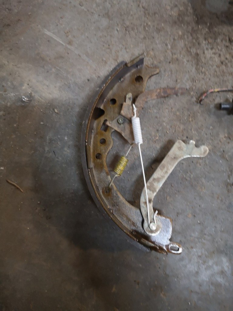

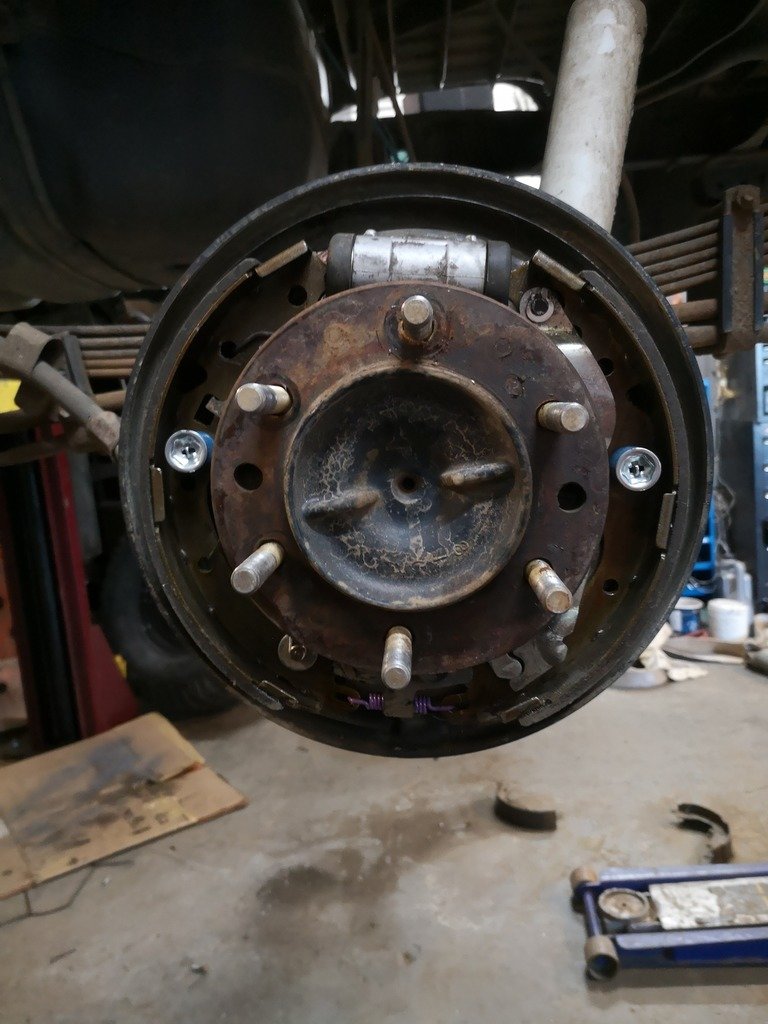

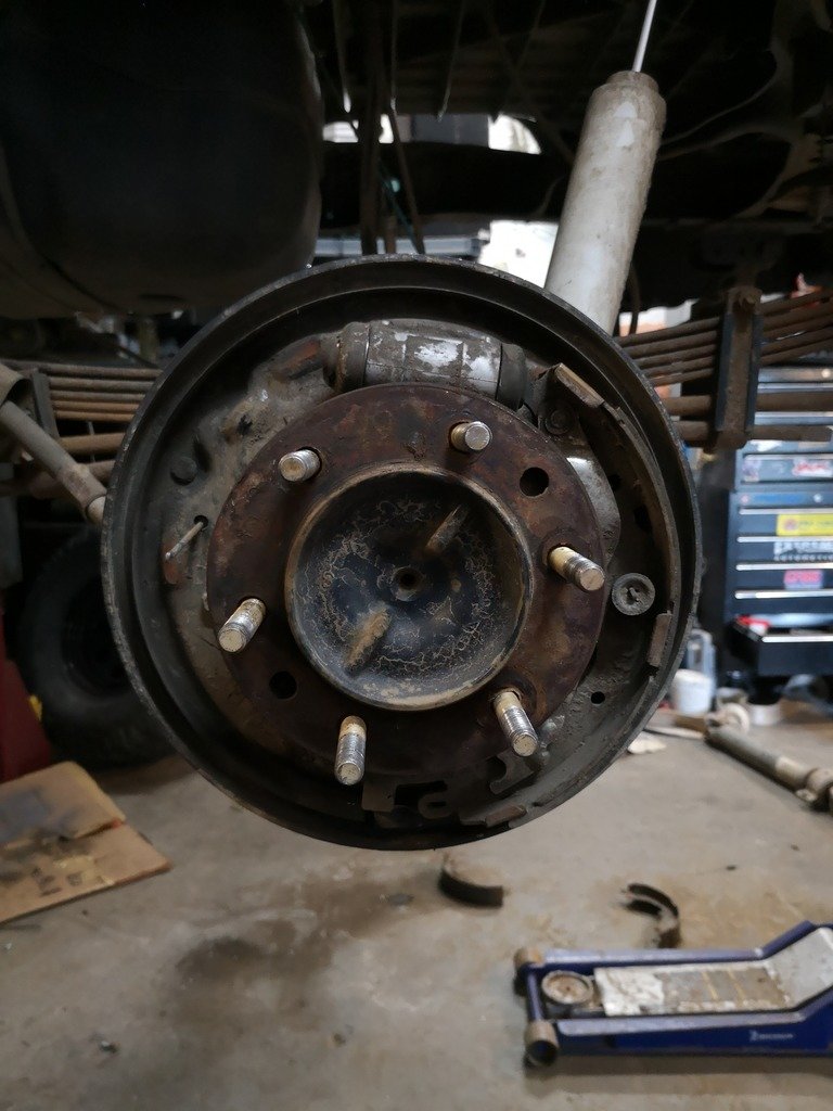

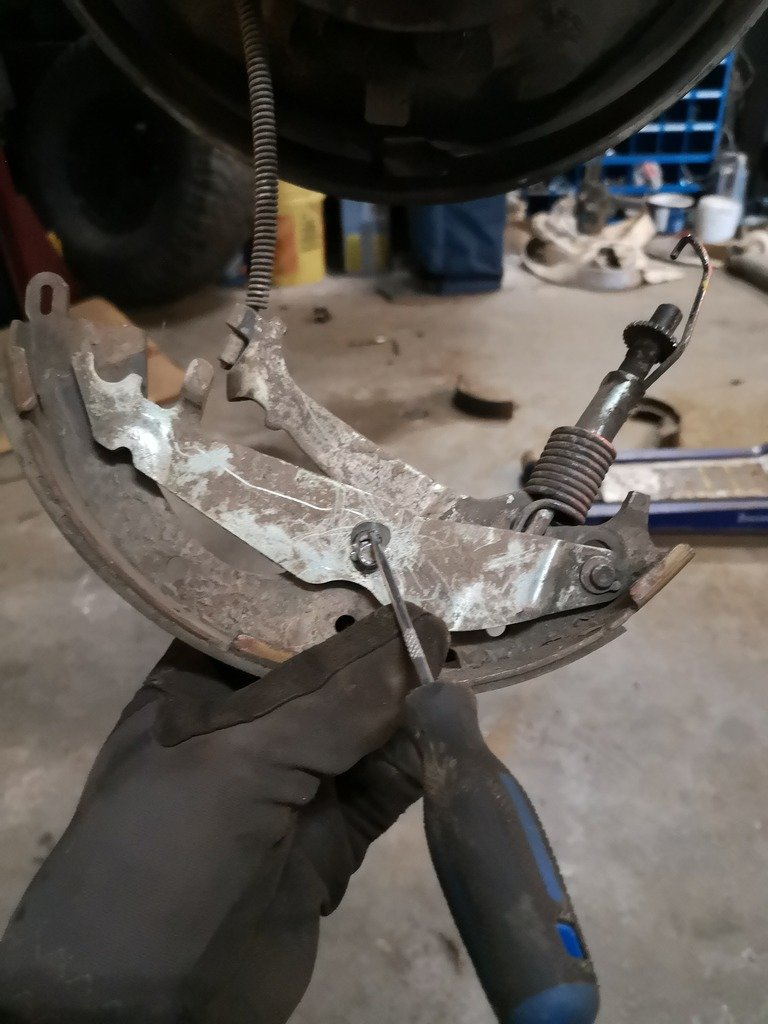

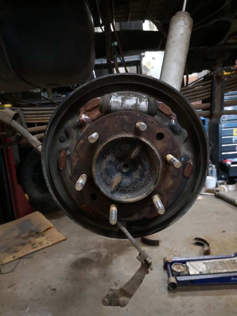

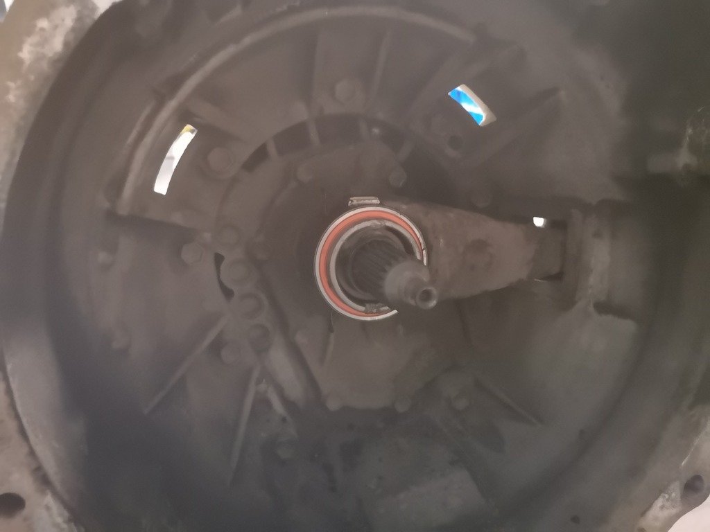

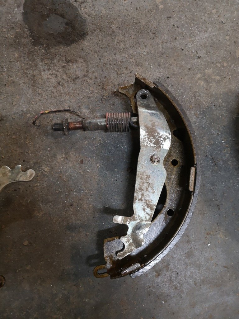

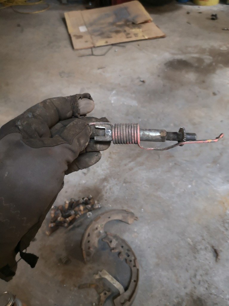

    Brake shoes showed up
    What's left from when I installed the arp studs. Take that junk off
    Now use a screwdriver or a pick to spread the clips apart don't stab yourself. It hurts
    So the adjuster I couldn't figure out how to get the spring off so I just reused it. Oh ya I got raybestos premium shoes on sale and a spring kit.
    Inspect the wheel cylinder for damage the boots will need to be replaced on this one but the rebuild kits are on backorder so it'll have to do for now. Next use a wire brush and clean up the backing plate.
    Dab some Cooper slip into the contact areas so everything moves nice
    At this time dab a bit on the adjuster threads.
    Reassemble the shoe like so
    You'll need to maneuver the bottom ebrake bracket over the riveted bracket on the bottom of the backing plate.
    Reasemble the other side you'll need to dick around to get the spring and adjuster in there and sandwich everything with the ebrake cable brackets. The pin on the side attached to the truck goes in the big hole at the top of the shoe. Mess around with it to get everything to line up nice then put the new c clips on and pinch them
    Now the fun part put the rear shoe on the backing plate then the front side. Attach the bottom spring and mess with the adjuster so you can easily lol easily is a strong word. Maneuver the top spring into place. Much swearing later it's all together
    Rinse wash repeat for the other side
    Then I tossed the new tob on the trans as well and greased the fuck out of everything
