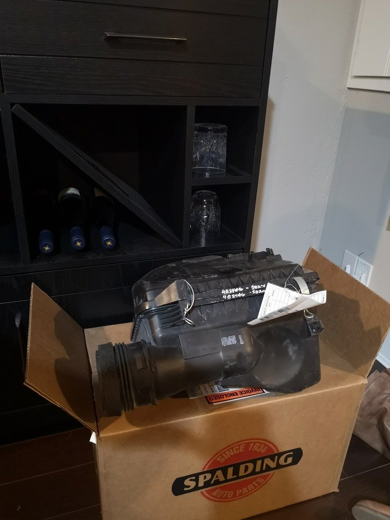

    New air box... Well it's actually used but this thing looks new lol mine broke at the rear tabs. They drilled out and removed the maf but since the lid on mine if fine I'll just use the bottom piece and keep this as a spare

    Side note the shop told me they had to run the intake through the cleaner twice to get all the dust out of the runners. Part of my hopes this is just because the original box was broken a bit. But I notice there are two areas on the rear corners(side closest to firewall) where you can see the filter. Also that stupid drain hole in the bottom. Im concerned dust is getting in there.

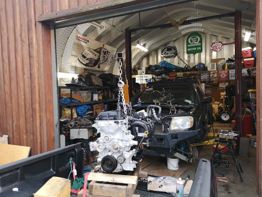

    cool it looks amazing!
    Bet you’ll be busy now!
    Hmmm hole for drainage?
    I was gonna worry but mines a a street queen.
    Engine looks really nice though.
    Seems they did ok for you.

    Without that drain hole you’re hosed if some asshole finds it funny to pour water in your snorkel

    Partly why I'm looking at adding a pre filter no hole to dump anything in. I feel like most of the issue is because the box I have was cracked at the back left side. The hinge part so it couldn't seal. Wish they put clamps on all 4 corners

    It will never be this clean again lol.. they also primed it with oil so she's pretty much turn key.

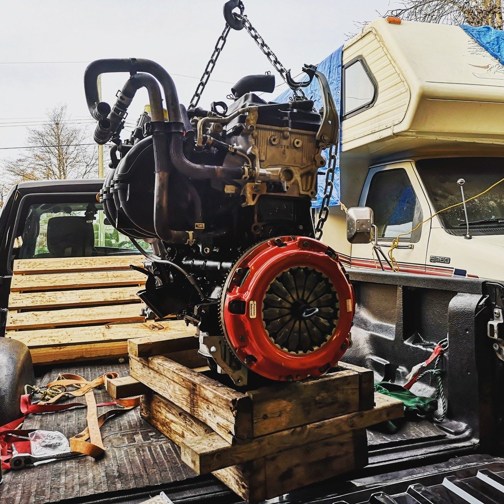

    Straight to work

    :popcorn::popcorn::popcorn: First startup is always exciting after a project like this. Also curious of your thoughts on that clutch
