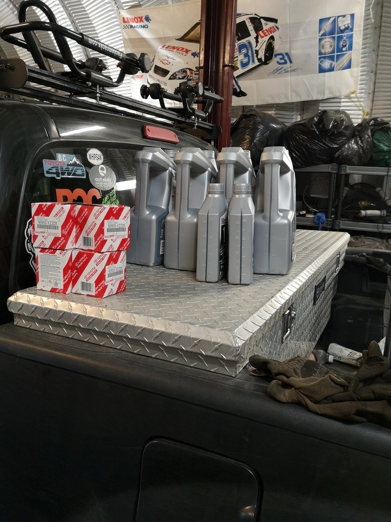

    Picked up the rest of my oil today lol
    Insuring and doing the break in on Tuesday as mentioned earlier. Then spend another few hours cleaning tools and the shop lol

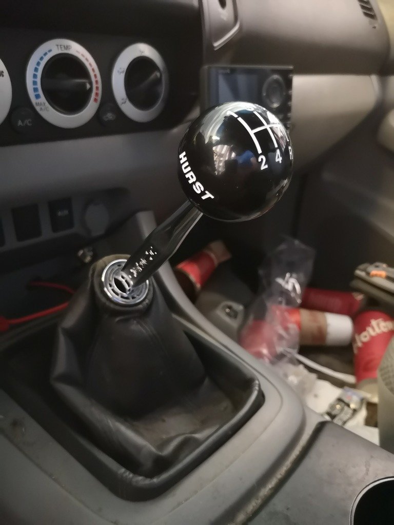

    Core/Hurst shifter
    Fuck me it's short, I mean the stock shifter has a longer throw than a Kenworth, but dayum. It's taken some getting used too, but I like it. Also my coffee is no longer trapped when I'm in 2nd or fourth. Which is the whole reason I spent money on a shifter I didn't really need lol..

    Red a few reviews saying that the hurst lets more transmission noise get inside the cab. Should be normal

    with how the core stick shift is made, do you think it can be a direct replacement for the oem stick?

    Without the base, you couldn't just use the shaft it's a two piece offset stick it bolts to the base..
