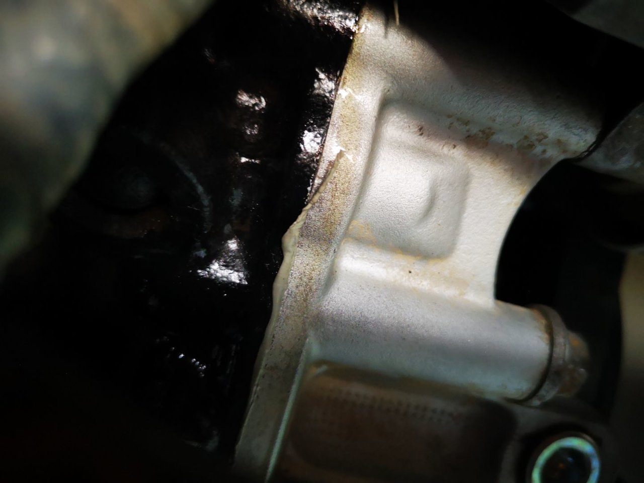

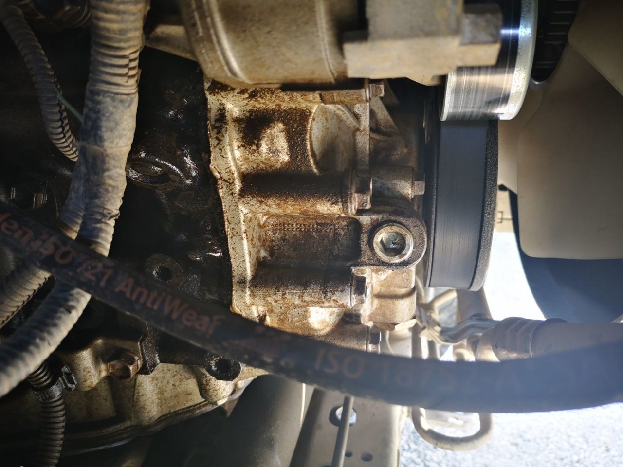

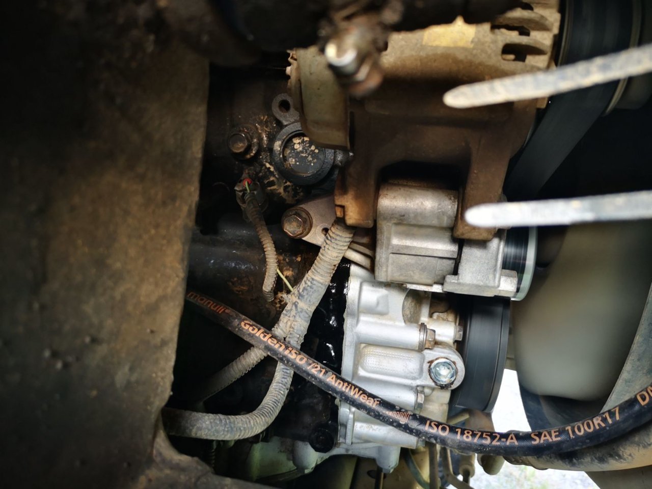

    So I cleaned the shit out the side of the engine and there's 100% a leak it seems like it's coming from one of the bolts that hold the timing cover to the block
    Clean
    Close up you can see the fresh oil after I ran the truck at 2000 rpm from about two minutes
    I'll take it back tmrw and see what can be done. The truck also goes in for frame spray on Saturday
    Kuntrykid likes this.

    Ok let's see where are we. Oh yes, so the shop admitted fault on the oil leak, and agreed to fix it. However their warranty shop, closed suddenly as the owner retired and moved to Mexico, lol you can't make this shit up, that was almost 4 weeks ago. I'm at the point now where I'm just gonna pick a shop and send them the bill.

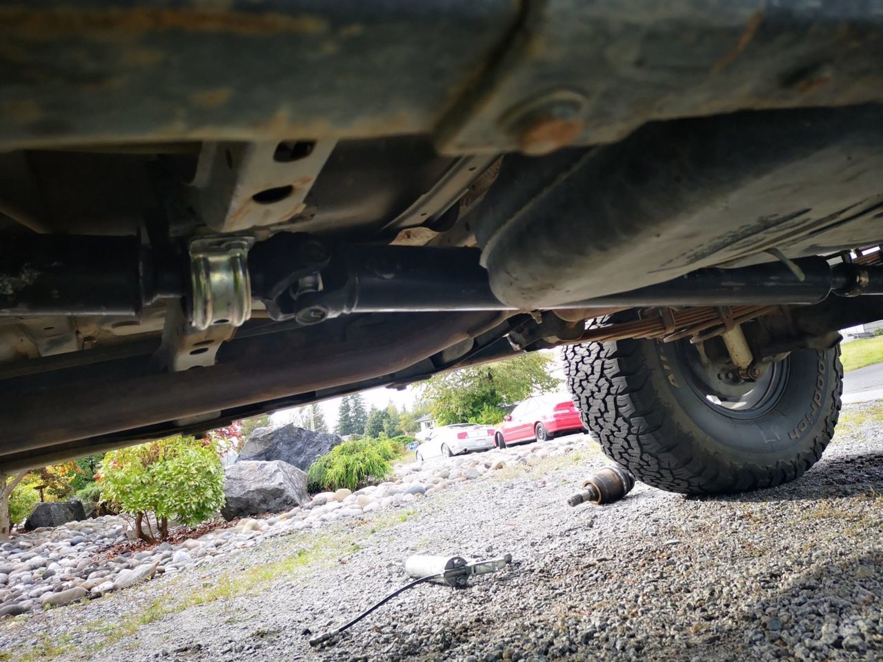

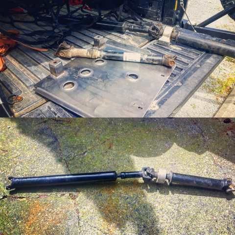

    Picless update cause its raining and I don't want crawl under the truck to take a pic. Lost the drive shaft last night. The support bearing separated from the housing it was still technically attached to the truck but I had to coast into the driveway. Anyways I broke out my spare, and threw it in. If you guys remember last year before Rubicon I bought this bad boy
    The previous owner had it sleeved with Dom tube and went with a heavy duty bearing, I switched out the heavy duty unit for a regular spicer unit. Finished it off with new spicer 1330x u joints and tossed it in the truck. For some reason the new shaft mounts slightly more forward than the OEM shaft but I made it work, however it's created more pinion angle, so I've gotta increase my amount of spacer. In the mean time I've gotta rebuild my oem shaft and get a pinion guard at some point I've hit it on something and bent the cover. Anyways I'd forgotten what it's like to drive without massive amounts of driveline slop lol

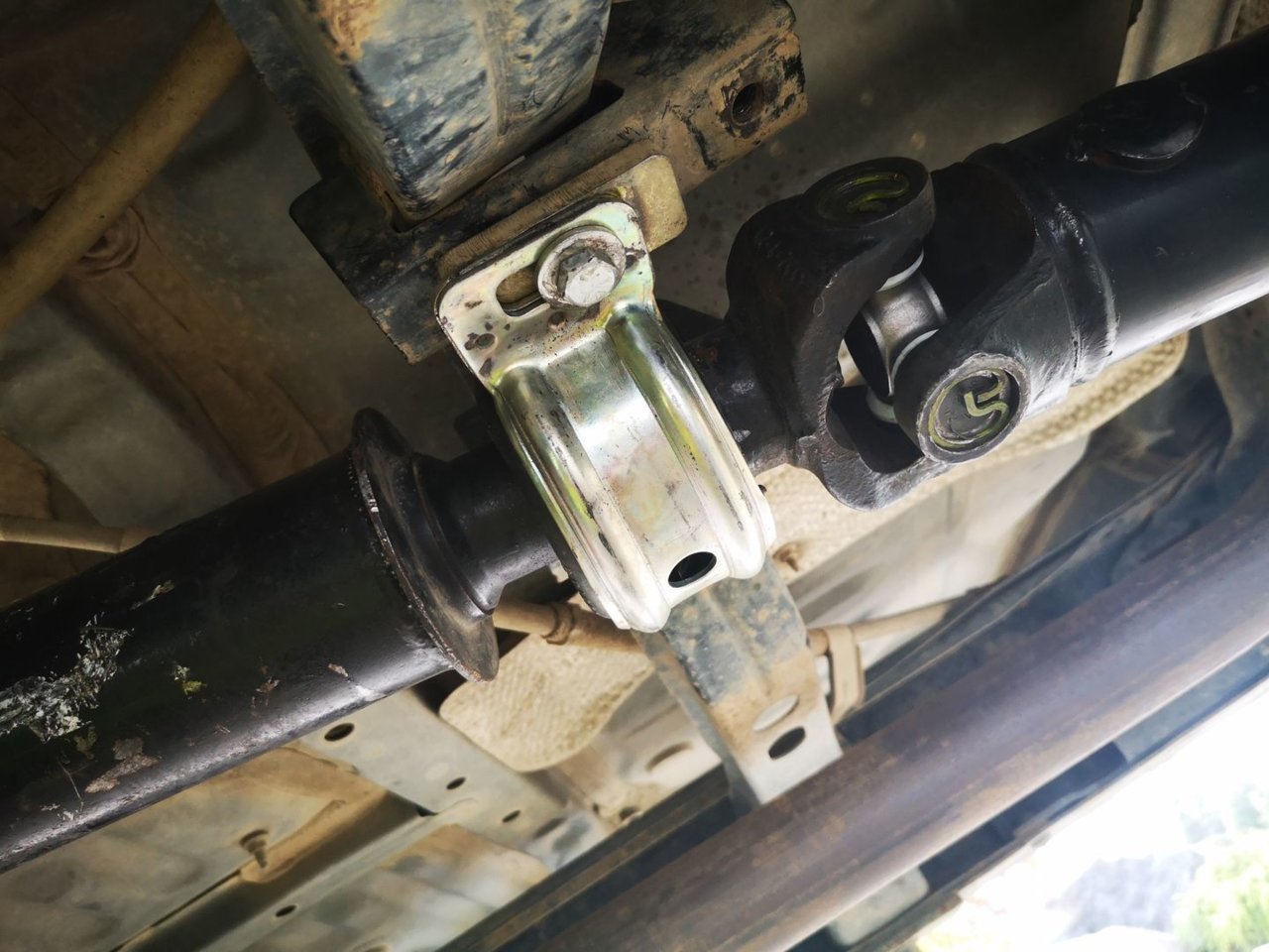

    Ok sooo. Turns out it wasn't my Pinion angle causing the clunks, the yoke ears were hitting the cross member. Keep in mind I've just sorta made this shaft work for now, and my cross members are all bent lol. Added another 1/8th to the ome spacer and turned the center bearing the right way around. I might just go with a one piece when I do duals this is to much dicking around
    Flex test is next I'd hate for this shaft to be my new limit strap lmao..

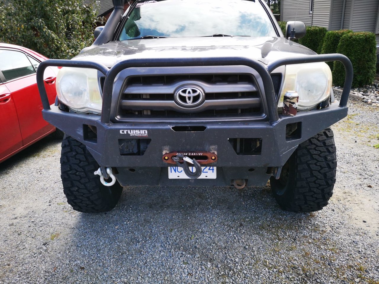

    We'll finally brought the winch into the 21st century, got my hands on a free synthetic winch rope, cause it had a knot in it. Fixed the knot and the rope wasn't damaged so I scored a fairlead for 20$ and made the switch.

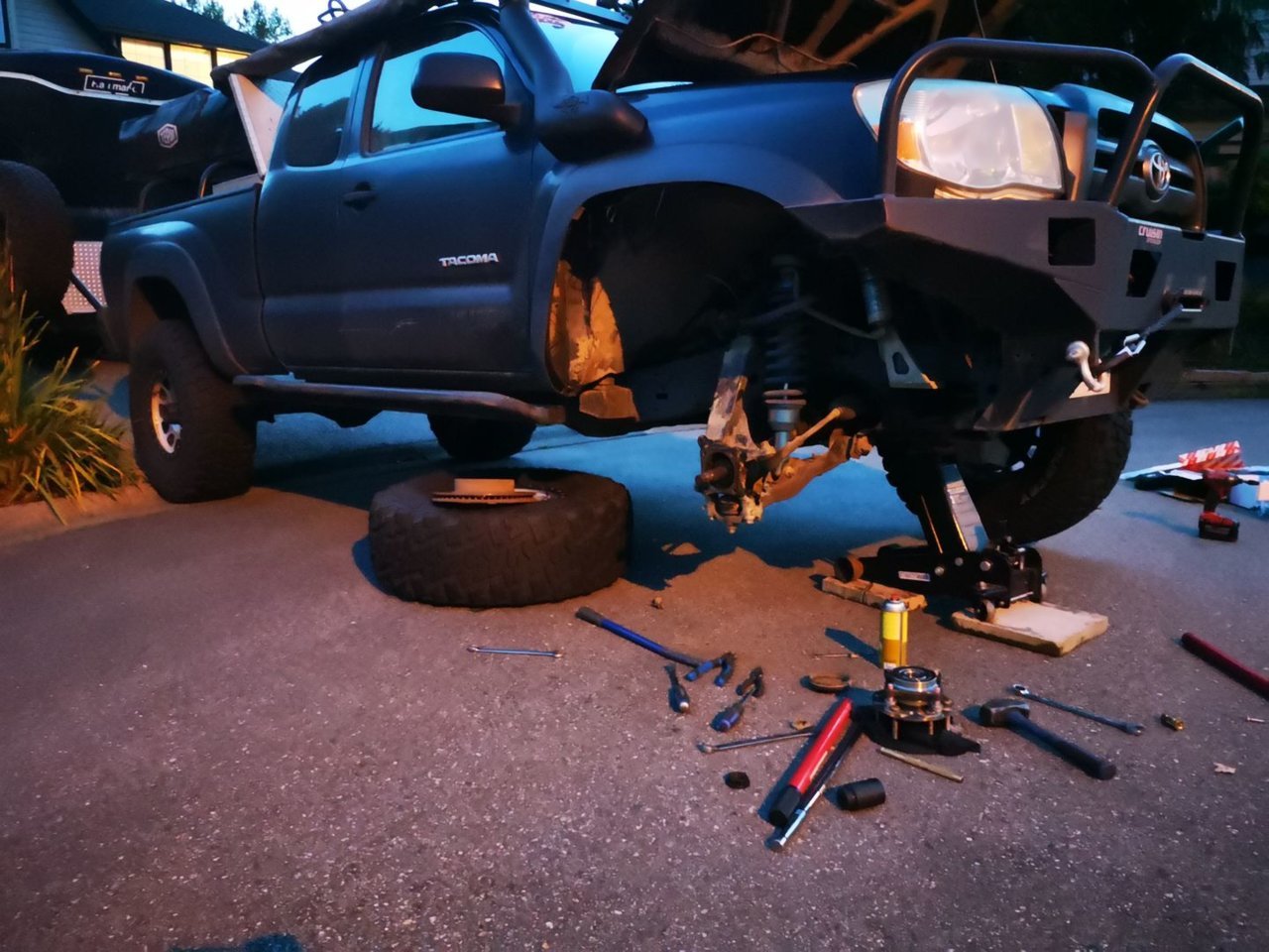

    What a shit/great day/night/day

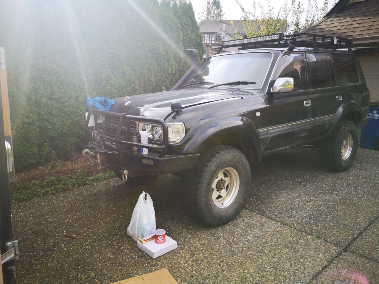

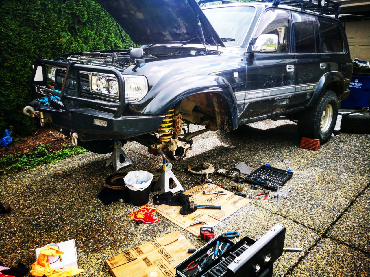

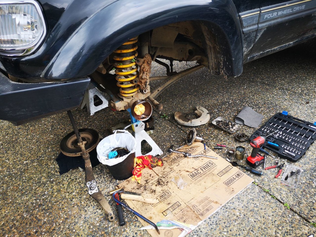

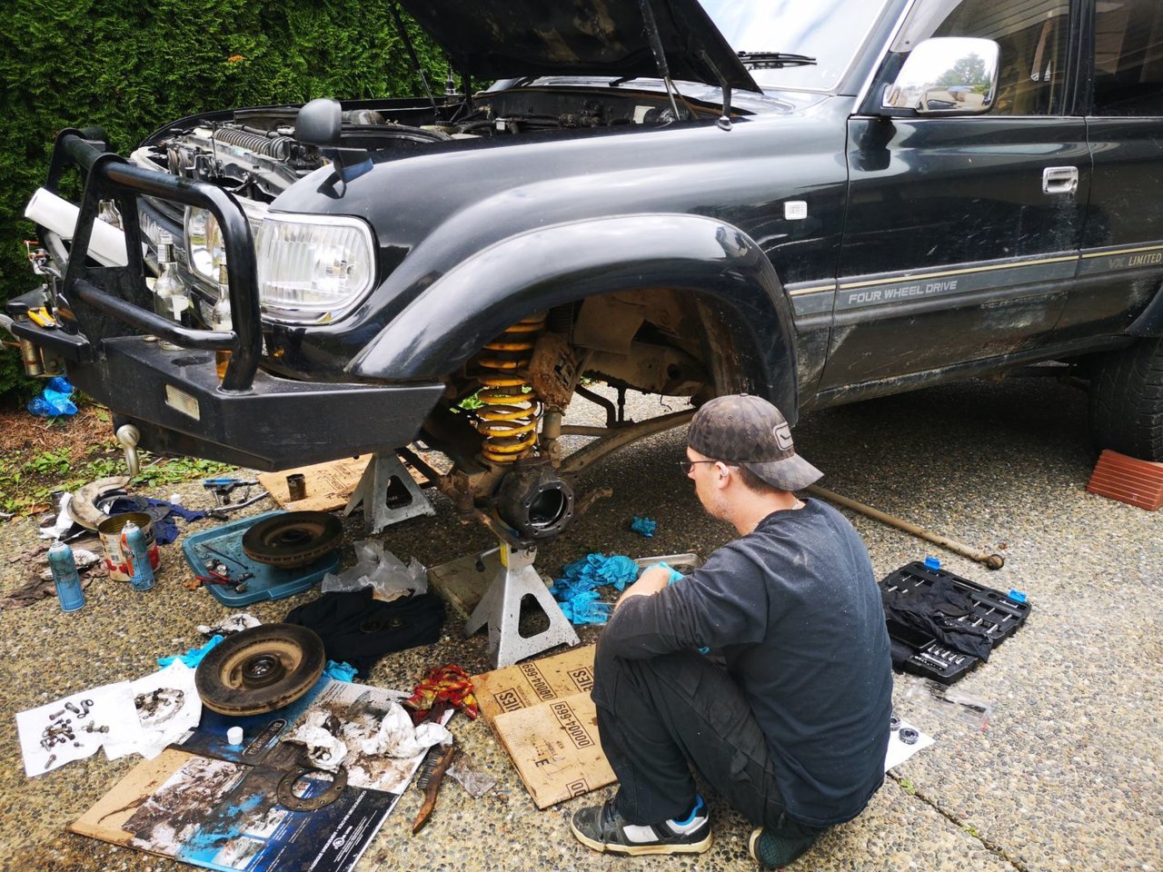

    Sooo Saturday started with me heading to my buddies place to get his 80 series ready for our annual Turkey Jam trip. The axle needed a full rebuild as it had been leaking for a while. Spent an hour looking for his wheel lock key(he just moved so understandable) never found it so I pounded a socket on and spun em off. Disassembled the axle and began the cleaning process. This is when we learned the passenger side(RHD truck) had a blown outer seal and had been letting water in for some time. Lots of wire wheel action to try and clean it up. A metric ton of degreaser and nertile gloves. We needed up painting the ball ends to try and fill in the low spots.
    He went with Marlin Crawler axle seals, and a TG rebuild kit.

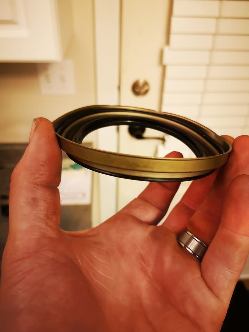

    We got everything assembled and sealed up. Except for the the hub bearings and seals, we discovered too late to order new bearings that the hub inner and outters had significant wear. We buttoned it up as much as possible and left the hubs till he can new bearings.
    Moving onto my truck we tried to get the hub done quick and dirty running low on light and beers only to discover the axle seal I ordered with the hub was destroyed in shipping thanks Amazon!!!!
    We packed up and ordered a couple pizzas and made a beer run and spent the rest of the night watching 4wd action.
    Next day ran to the parts store and luckily they had a new seal in stock. Took a wire wheel to the spindle as water had done a number on it. Which is what probably killed the bearing definitely not 4years of running 35s. Pro tip get a buddy to help and use the backside of the old hub to help drive the new seal in evenly. Anyways buttoned it all up, did an oil change and mounted my skids. Well all except the ifs skid I was short a couple bolts.
    Drove it home and it was smooth sailing again.
