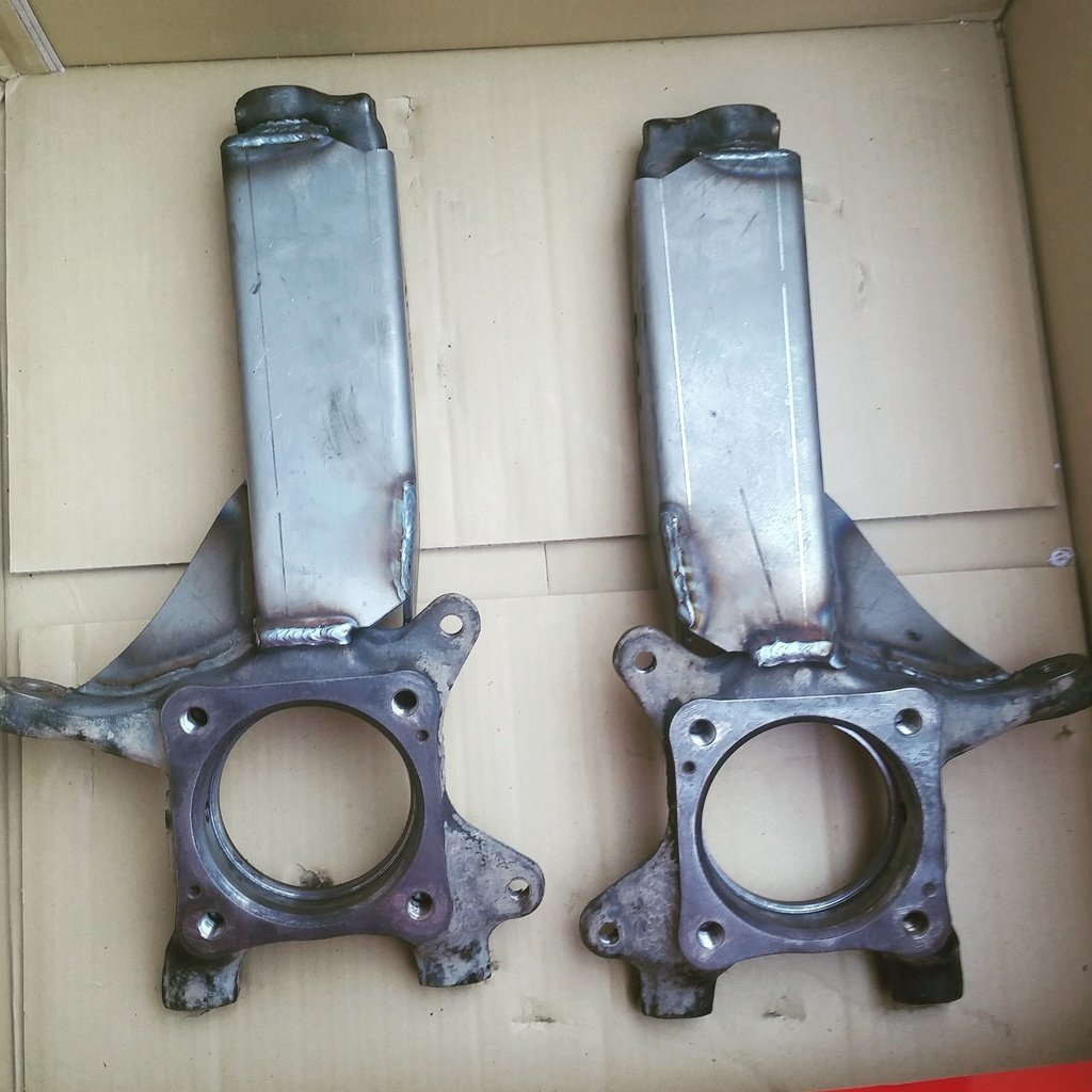

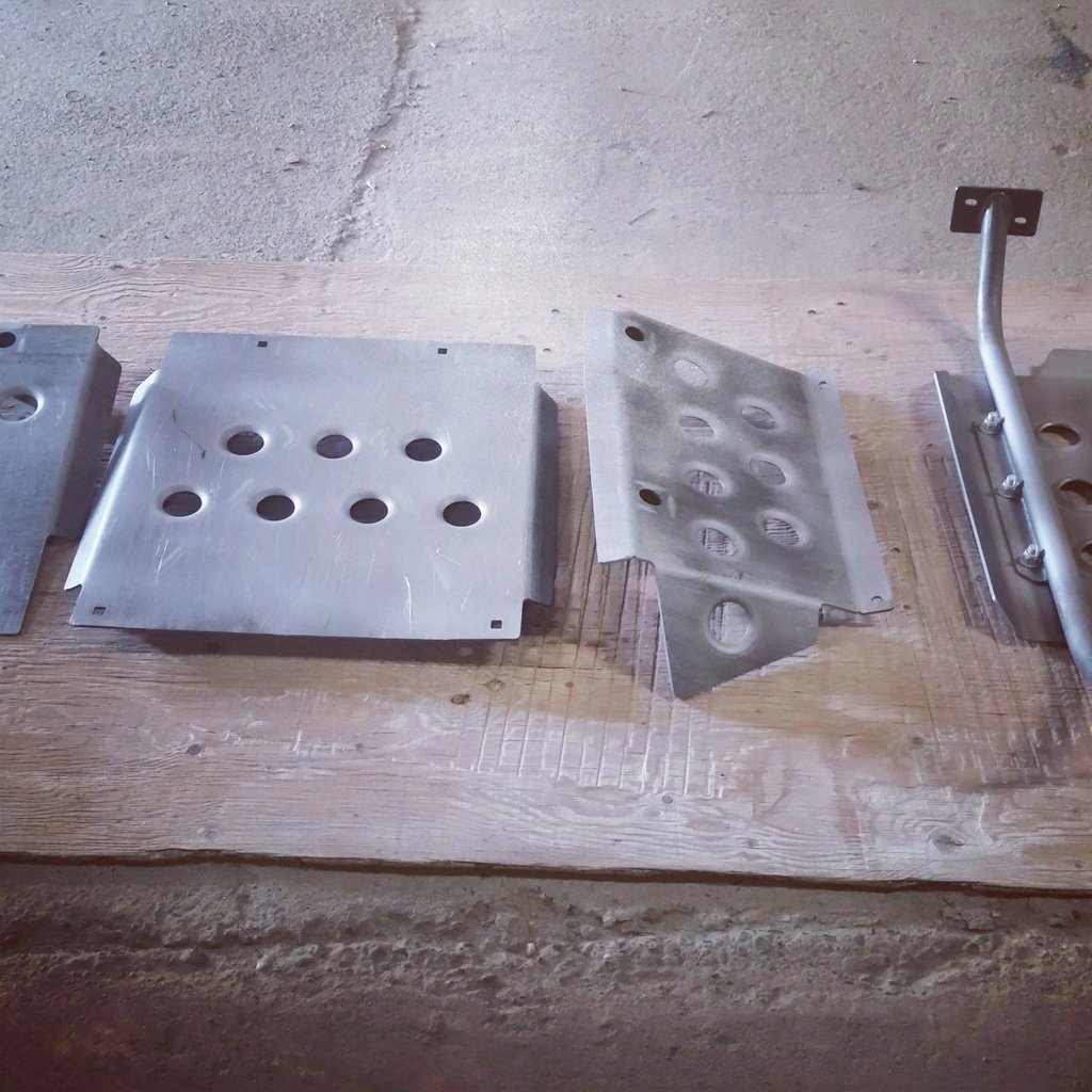

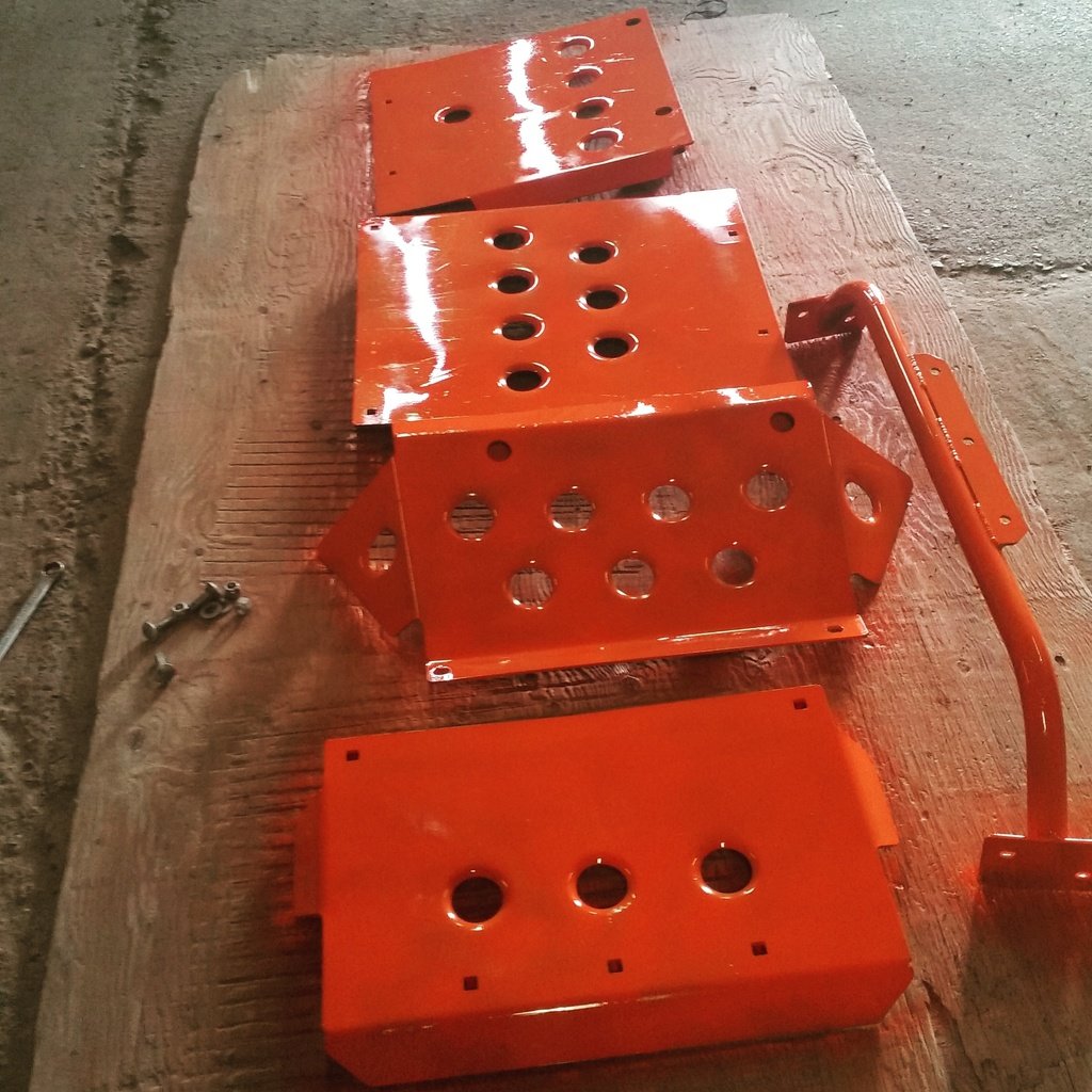

    took my skids off yesterday and got them painted up. the ifs skid took some good punishment last weekend lol
    Sandblasted
    Painted
    Also got these from one of the guys that was with us last weekend

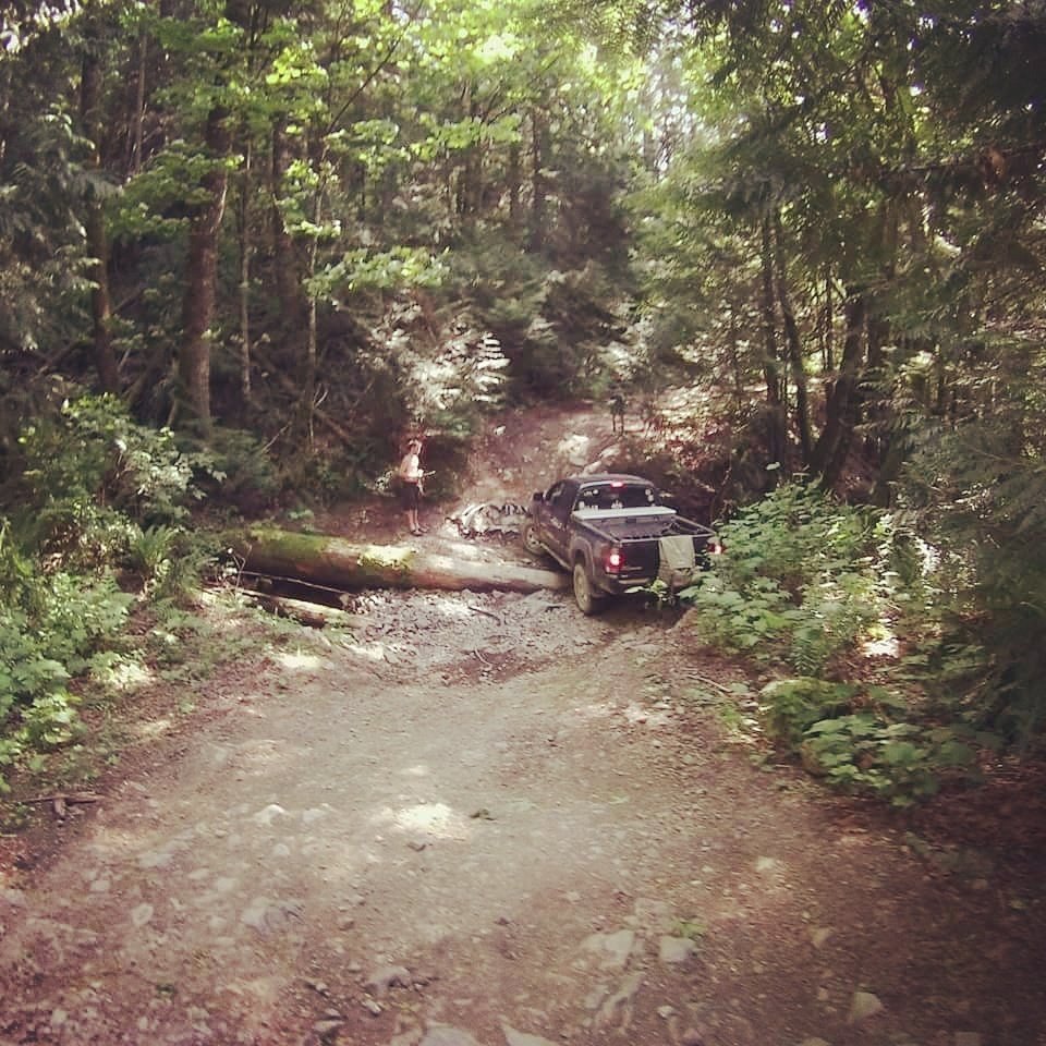

    Watching some idiot jeep guys get stuck on some driftwood

    Lookin good man! I am jelly, really need to get the truck out.
    Is your IFS a 2 piece design? Never seen that before, but sure would be nice for the install

    It's nice getting out I try and get out as much as money will allow me too during the summer lol yes the ifs skid is two parts it uses the factory holes from the cookie sheet and also you remove those two brace things and that's where the oil pan skid attaches. I use a jack to put the plates into place but the dimple die holes Line up so with a funnel contraption I won't have to take them off to do oil changes. They do sit low because they go below the cross members but I prefer it that way those x members have enough dents in them

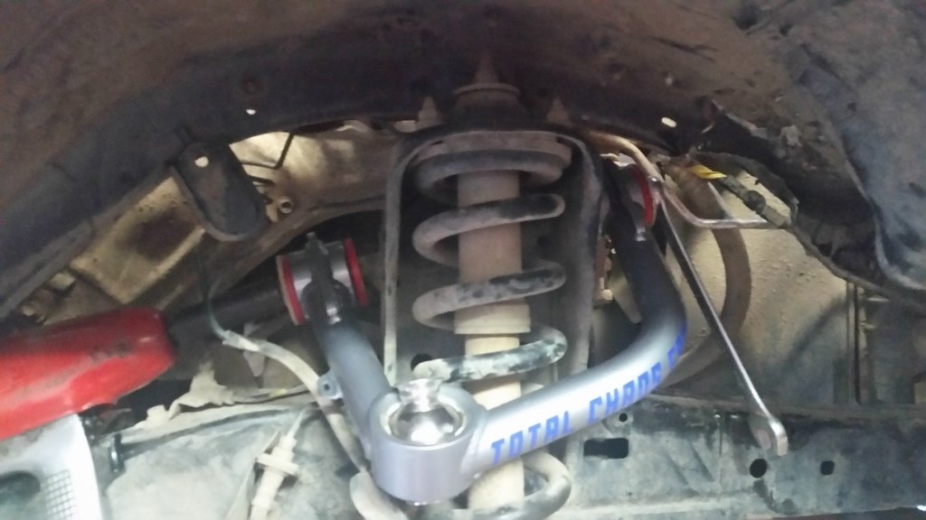

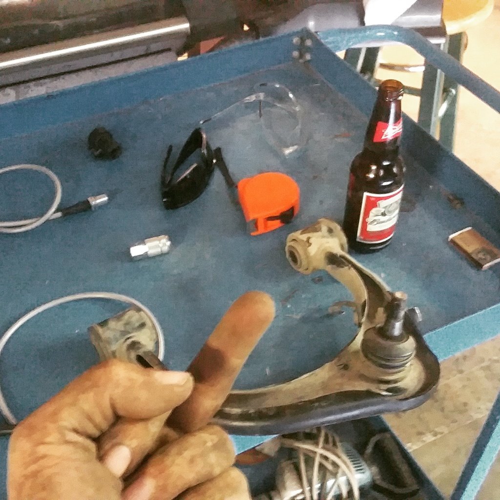

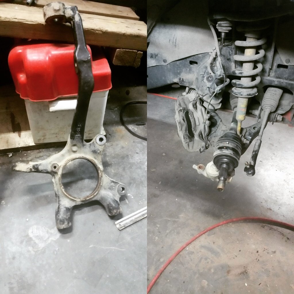

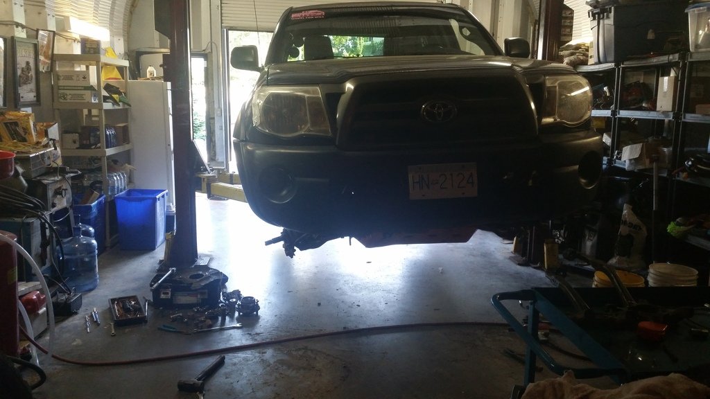

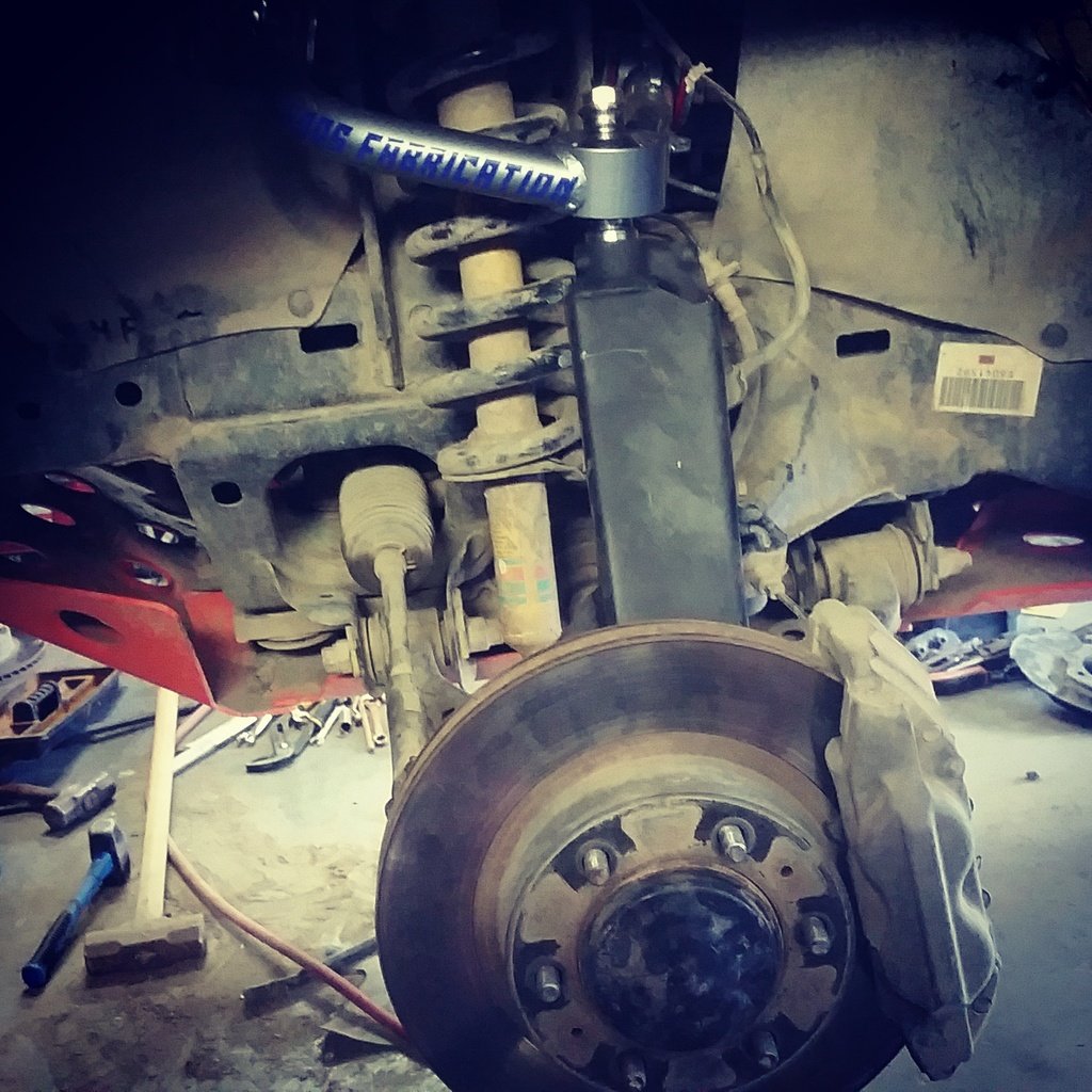

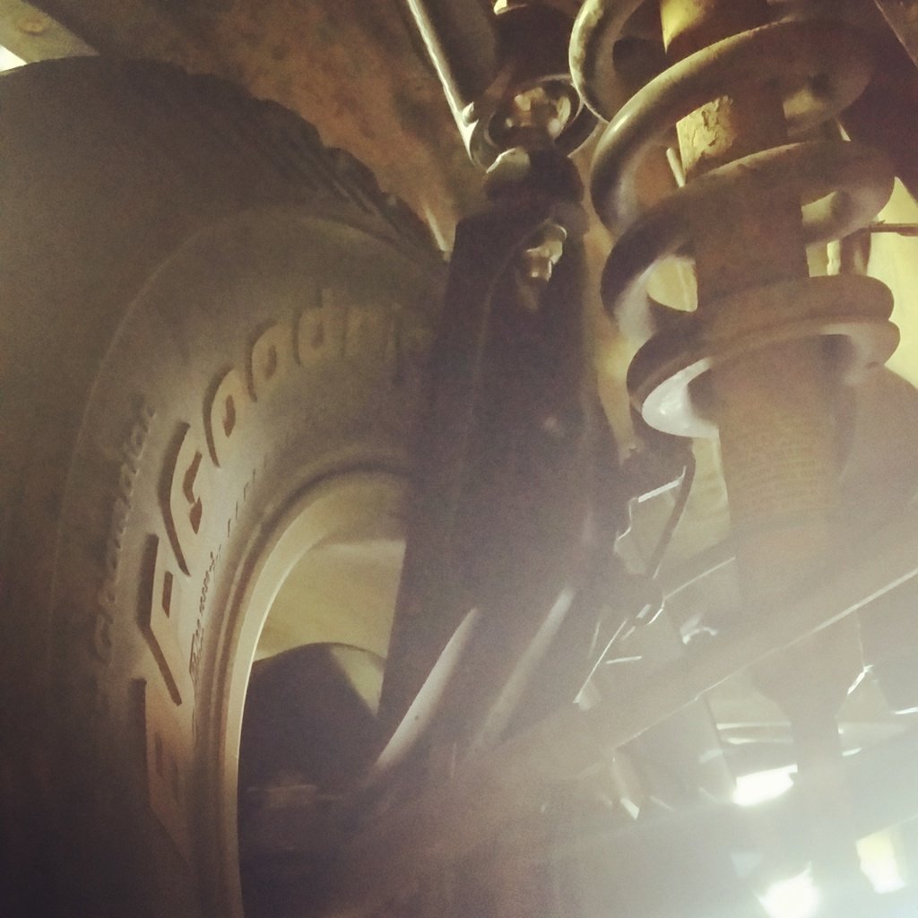

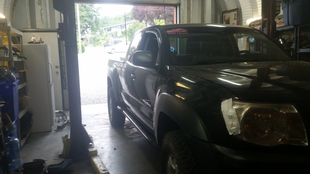

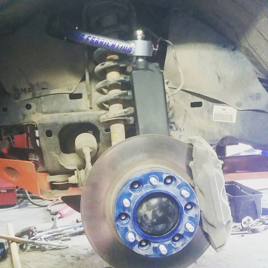

    So this weekend since work is slow and I had a lot of free time I decided to get cracking on the difficult part of my lift. Everything except the coilovers since they wouldn't be ready till Thursday... it's been a struggle and I've hit a wall I didn't anticipate on needing wheel spacers to clear the tc gussets so that's a pretty expensive unforseen cost mainly cause the canadian dollar is awful
    Got the hoist fixed in the shop which has been a godsend for this project
    I didn't start till like 930 pm on Friday night so I only got the one side stripped
    Got up early Sat and headed over to thekernels place as he offered to weld up the gussets for me
    Never in my life have I seen a stupider design for upper control arms
    Then I realized I forgot a couple washers on the passenger side for the tc unit and I'm guessing the bolt is both bent and the nut ran past the threads anyways it has to be cut out and I'll have to pick up another ft long bolt
    I kept going as it was really late and the bolt issue was minor till I ran into a tire clearance issue
    soo nice
    Gonna make rolling hard
    So that's where I'm at a lot of messing around and some unforseen issues.... heading out to the parts store to see if they have any spacers in stock if not I'll carry on with the rear and deal with the truck Monday after work

    I posted up on the local forum and had spacers an hour after posting this. Got spidertraxx 1.25 spacers

    ASK and ye shall receive. Asked if anyone had spacers on BCTOYOTA4WD. Had spidertraxx 1.25 spacers within an hour can't argue with that !!!

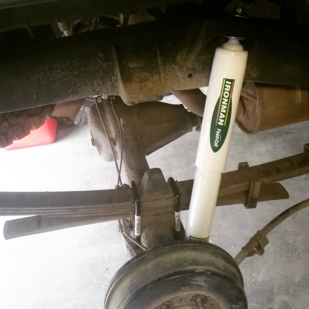

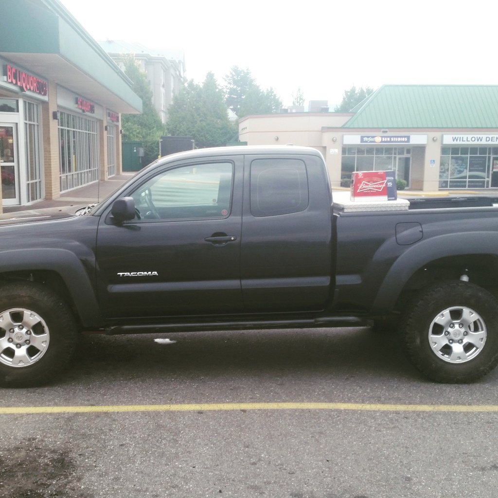

    Got to work on the rear end. So beefy ironman 4x4 foam cell shocks, ome u bolts and a leaf pack with an aal
    Sitting on 4 again
    Test drive to the beer store

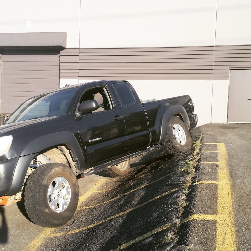

    Flex test today also picked up another trasharoo. Support your local 4wd association! !!!
    She's got a lot more flex in the rear end now should help me out on some of the flexy trails !!
