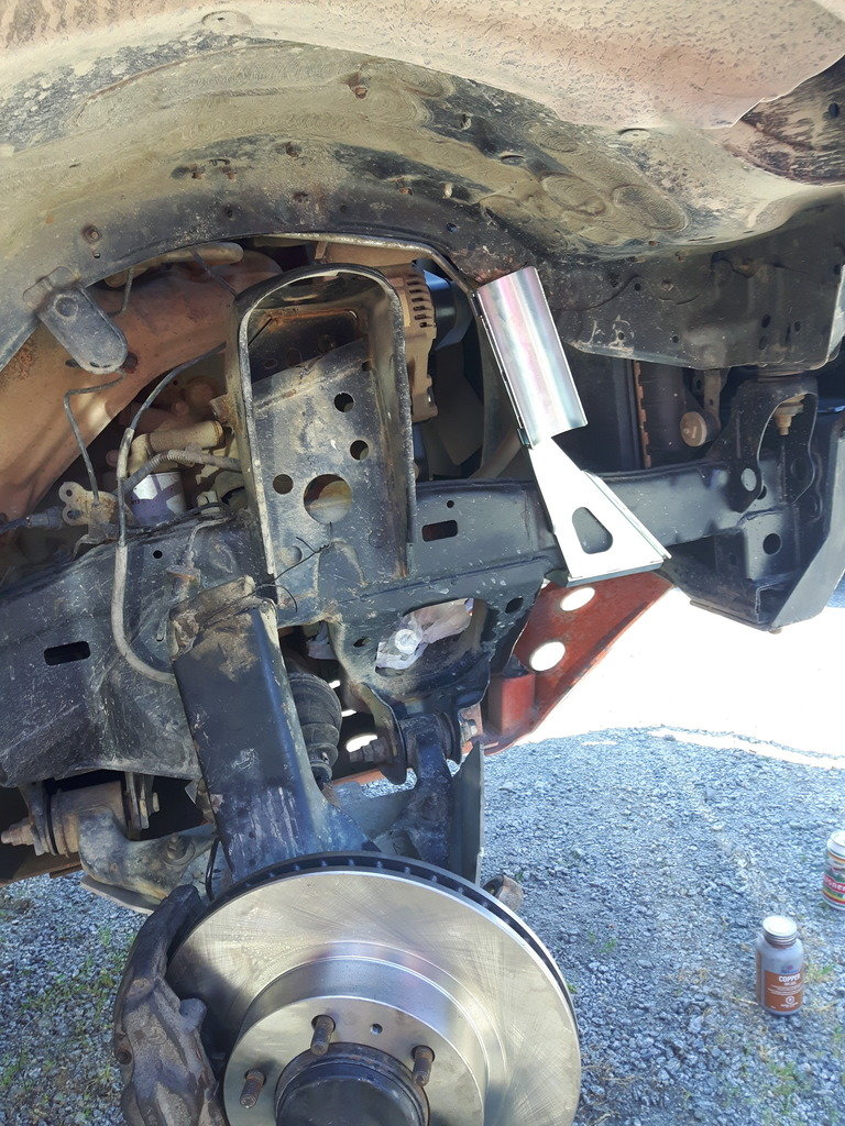

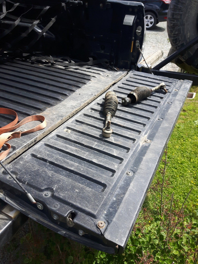

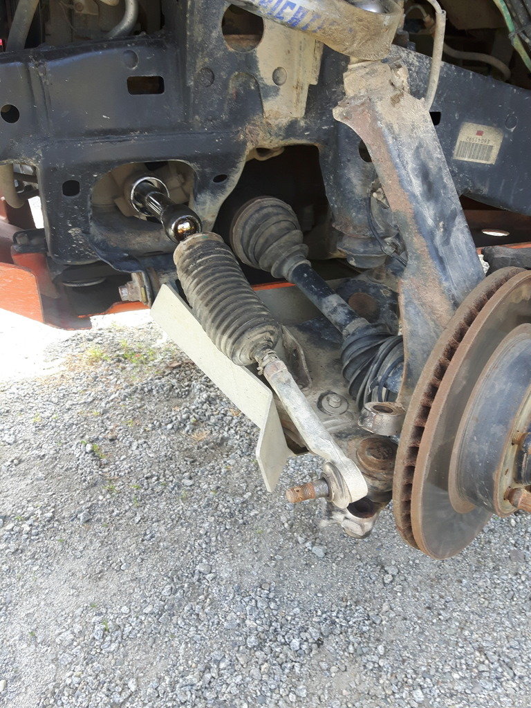

    Soo starter working on everything today it's pretty much done just waiting on my inner tie rods. I've also gotta take the Ucas to the shop to get new uniballs pressed in. I got the the heavy springs put on yesterday as well.
    Since the shocks had already been removed it was all super easy. Remove the claps for the inner boot and slide it off. I used a pipe wrench and they spun off no problem
    I took them off as an assembly so I can match up the new ones and hopefully get the alignment close enough to drive to my alignment guy and not have the truck wondering.
    I covered the exposed steering shafts with plastic and used zip ties to secure them in case it rains. I ended up going with Raybestos rotors and stop tech heavy duty pads. Nothing exciting there we all know how to do a brake job. I pulled the Ucas and installed the resi towers
