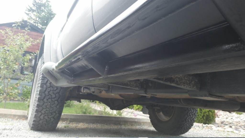

    Nothing major just went out for a burn with some local toyota guys explored some spots couple fun trails I'd been waiting to try, fossil beach and sunrise lake
    Did a bit of a loop, fossil is an offshoot of hale creek anyways pics

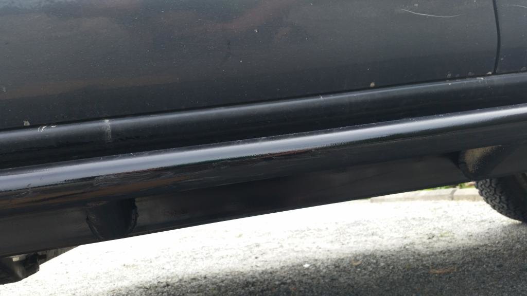

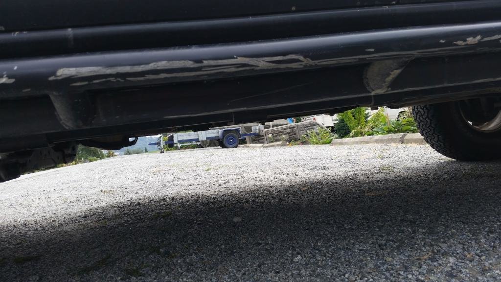

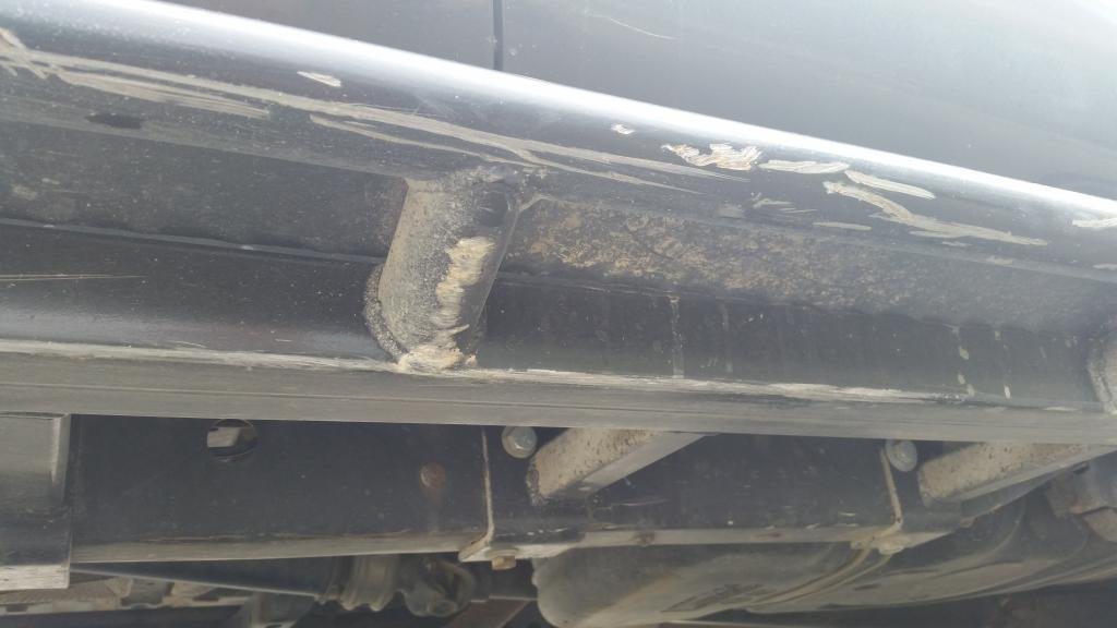

    Vrock did a number on my sliders but they held up as I expected them to do I actually got stuck for a sec on one of the support bars, painted up the scrapes don't want rusty bars. Didn't get any pics from this part of the trail the land cruiser broke a shackle so we did the rock then got to repairs
    Painted

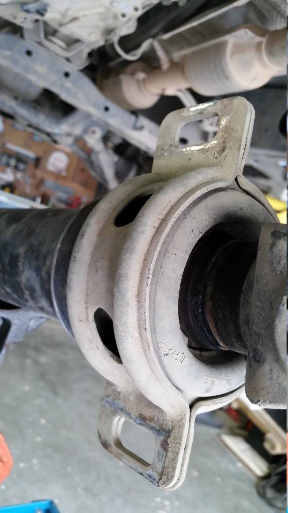

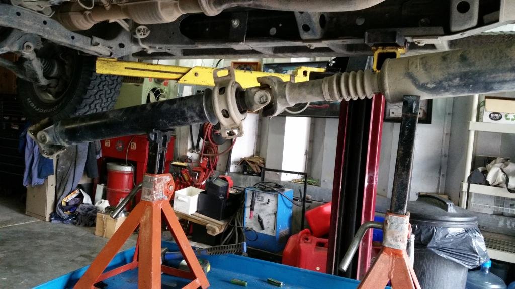

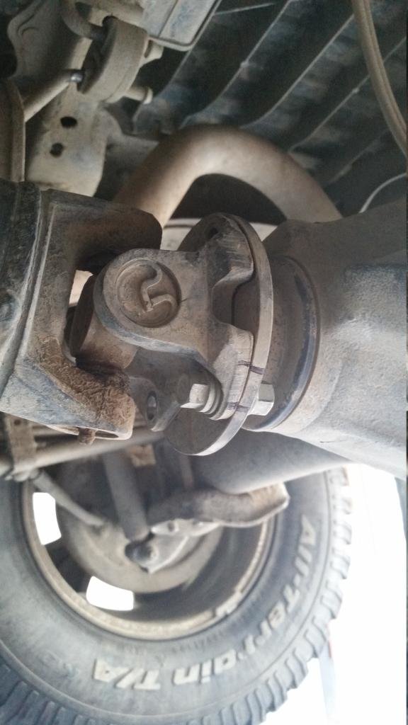

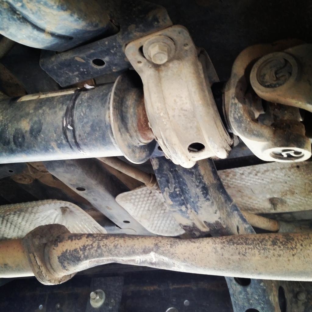

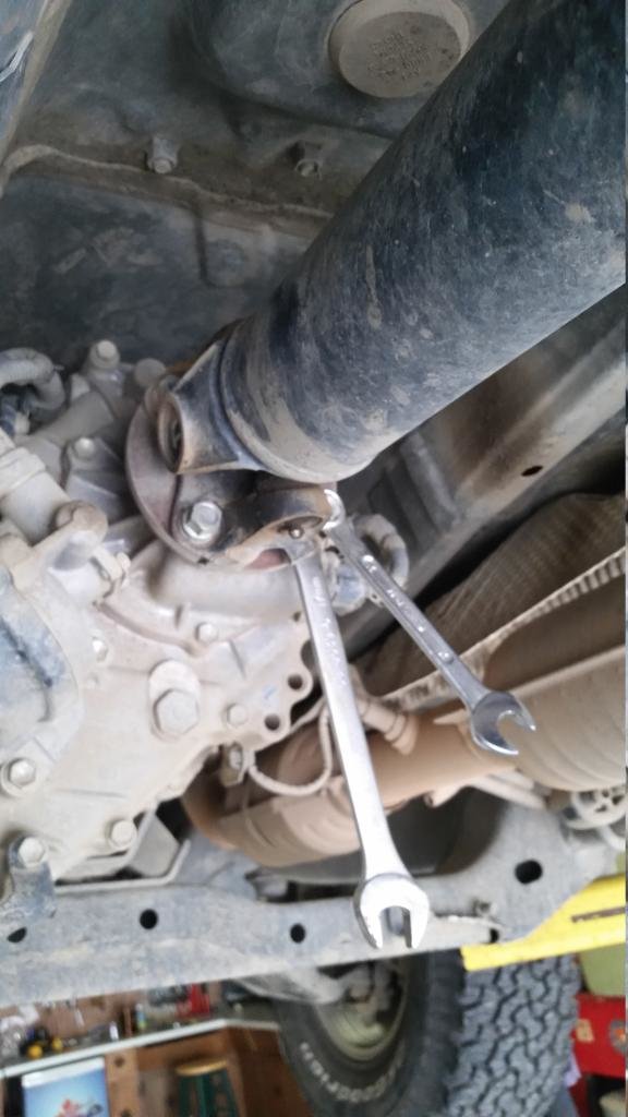

    Ya so this weekend got really interesting fast!!! Sunday I went out with a couple guys and we did the cell tower trail at Vedder mountain in chilliwack bc, this trail is one I'd done a few times, nothing terribly exciting except Sunday there was a bit of rain which was nice cause it's been drought like dry here for months, so here we are at the end of trail trying to navigate the rock and I pose for pic real quick
    Right after this I cranked her over hard driver admittedly I was a little off the line I wanted but it was totally saveable, suddenly my back tires slide right off the rock and I come to rest on my sliders and frame, but I was sideways and in a precarious spot to say that least, we threw a winch line on the back to try and pull her back straight but to no avail, we then hooked up to the front, with a snatch block, and using a combination of high lift and clutch kicking we were able to get her to pivot on the high lift and inch me forward eventually we got her to swing around and awkwardly get off the rock. Now I was happy as fuck that there was no body damage and that the truck didn't roll but getting back on the pavement I noticed a squeak sound I pulled into a gas station and found this
    So now I'm like fuck, there were no vibes just a squeak, so being tired and hungry I went to the pub, and decided to start fresh today, pulled her into the shop and got her up on the hoist to inspect everything, I had also picked up a spare carrier bearing and some oil since she was due for a change anyways
    The carnage
    So I marked off the shaft on the diff and transfer case side so I could put it back right
    Then I took the front shaft off and loosend the rear, and finally dropping the carrier bearing after getting a couple of jack stands to support it
    Next I inspected the bearing
    It still spun freely with little play, so instead of replacing I went with plan b, I grabbed my breaker bar and used all of my 215 lbs to torque on the member to get it as straight as possible
    Once satisfied I buttoned everything up did my oil change and took her for a drive, load tested the truck at various speeds and rpm ranges, no squeaks no vibes, so time will tell buy for now I'm happy things could have been a lot worse, I'm looking at developing a carrier skid but I need to do more research, the c member will need to be beefed up for it to be effective I think, I really need to get on getting my truck lifted and some proper skid plates my fuel tank has a few scars in it too so ya lots to be done

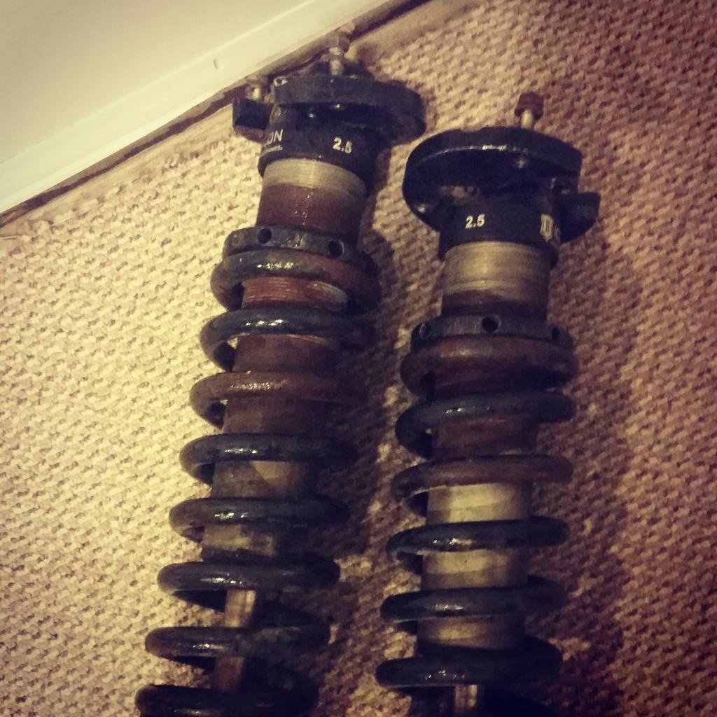

    Picked up some icon 2.5 coilovers today from one of the local bctoyota4wd guys!!! One of those too good to pass up deals!!! Gonna send them out to be rebuilt so they're nice and fresh!!

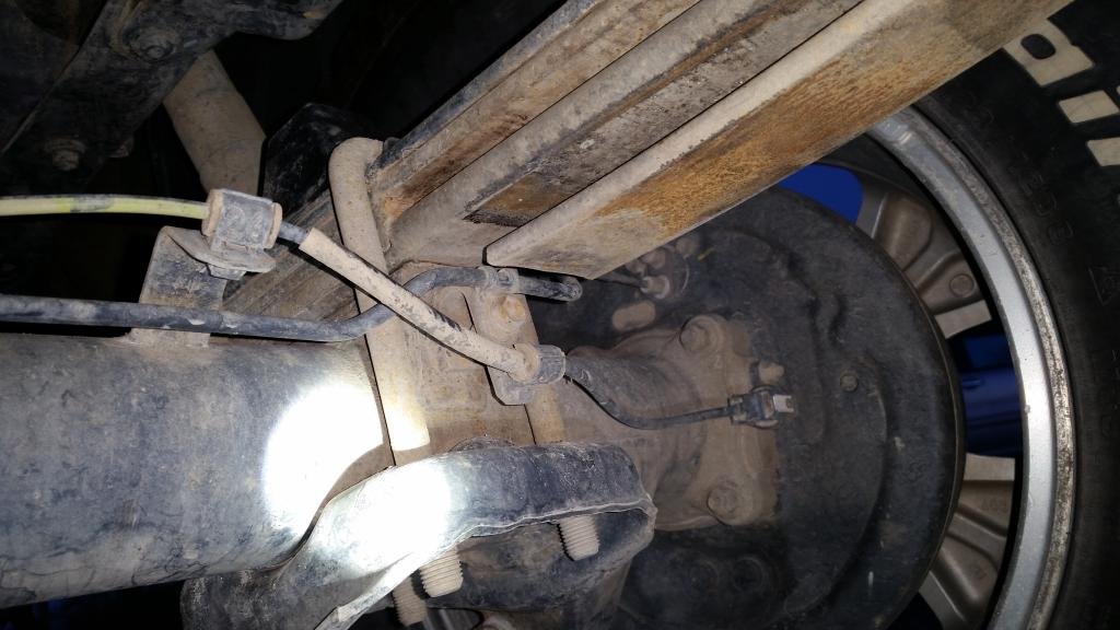

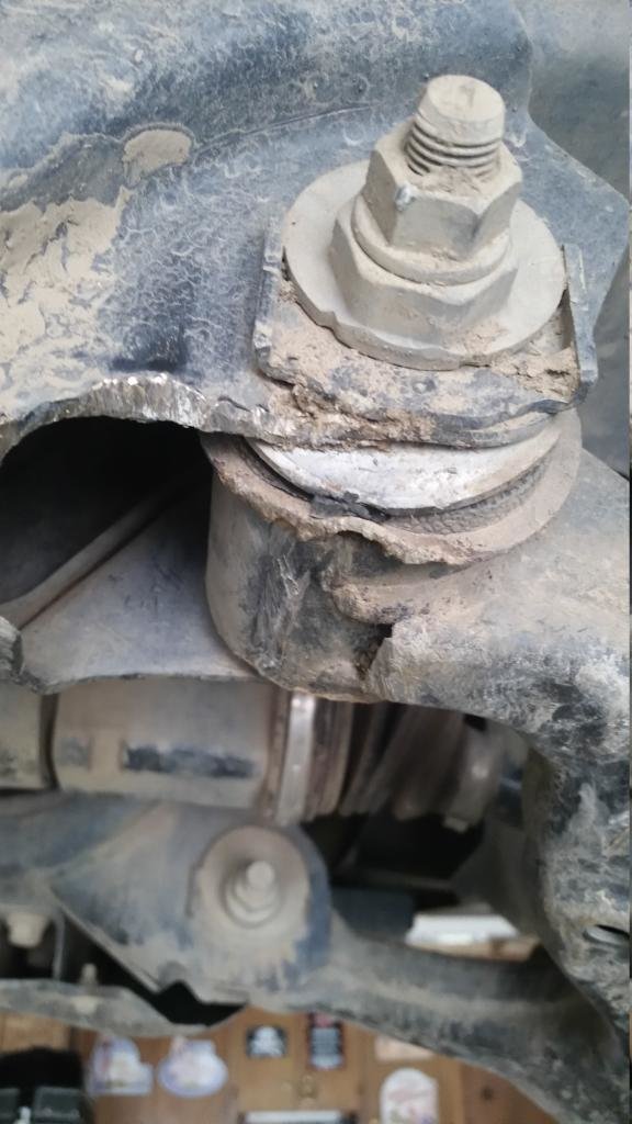

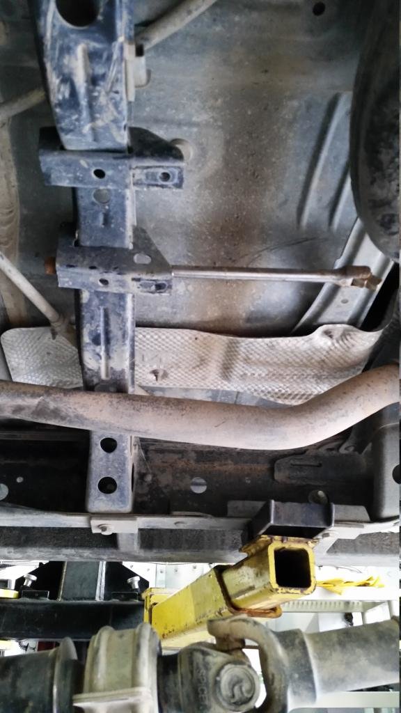

    And then I got a leaf recall letter in the mail so I was like hmm maybe I should check my leafs
    yup they're broken toyota Canada is working on a solution till then I'm just gonna drive my wor truck

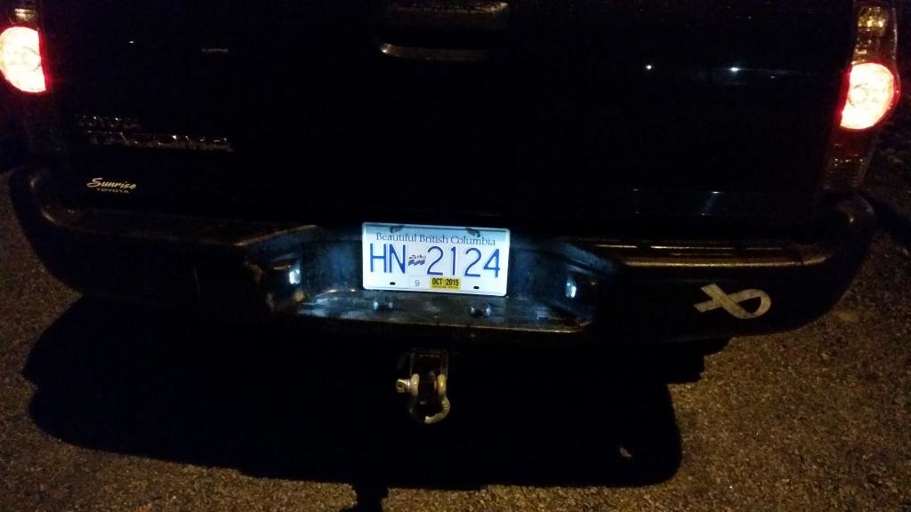

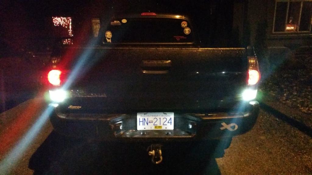

    I also had a few lights out which I replaced with led's
    Plate lights
    Reverse lights

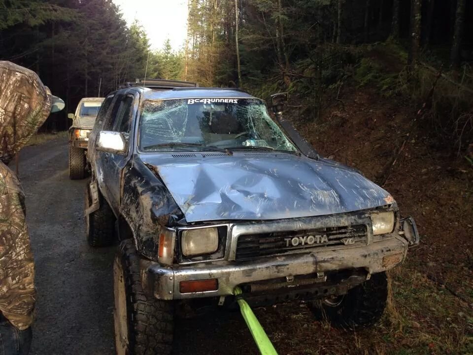

    Last weekend I also went out for a coffee meet up Vedder mountain, the cell tower trail left me with some damage last time so I wanted to redeem myself unfortunately Jesse who was with me on the last whipsaw run had his brakes fail at a bad spot which uultimately lead to him rolling
    We towed him off the mountain and decided to do another trail while we were at it
    Everyone in the 4runner was ok and he's already got it swapped into another shell and back up running !!!
