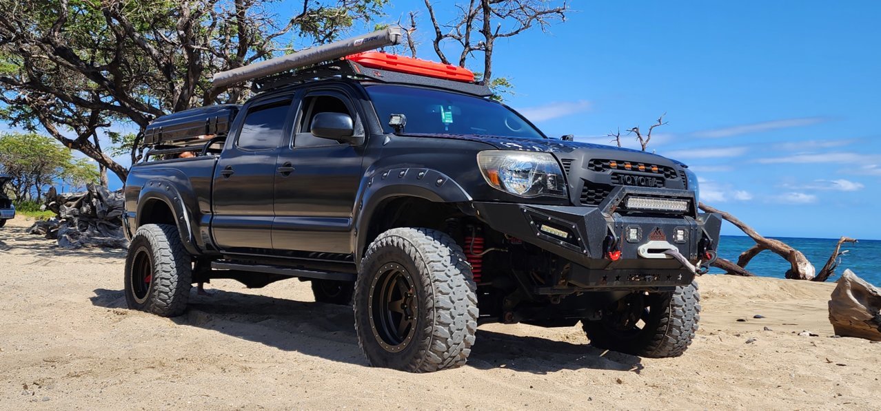

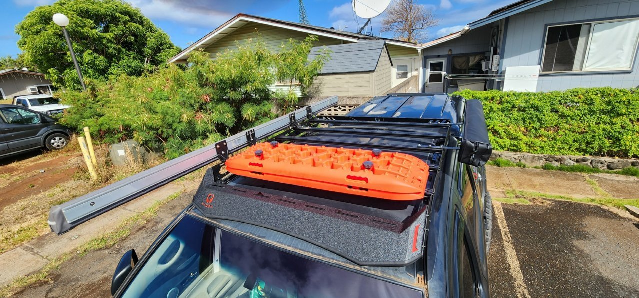

    Finally installed my rack and a few things on it.

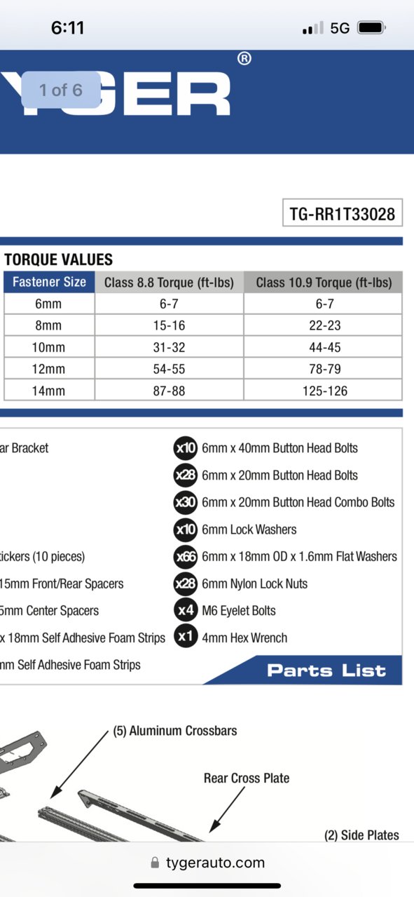

    You remember the torque specs? If not it's all good you guys been a great help already. I can look it up. Lol

  15. Jul 4, 2023 at 9:14 AM
