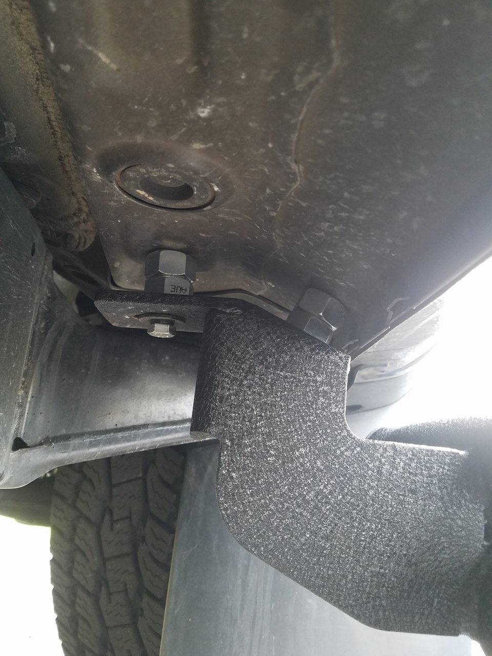

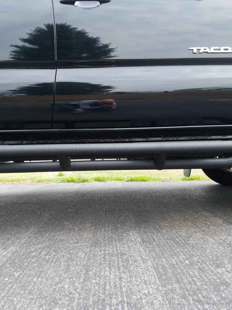

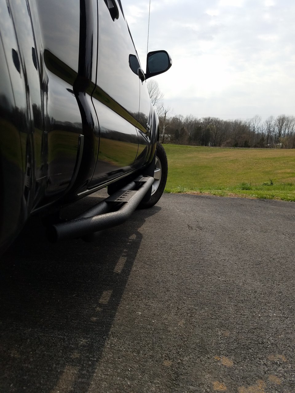

    Alright I got some pics of how mine sit
    Theres the gap between the useless bottom of the step and the frame.
    As you can see this gives us about 6 inches between the step and floorboard.20180323_142220.jpg
    These here bolts were the only thing that made it a pain, but it looks like you could keep dropping... But I know how yall like your ground clearance.

    Thanks for the pics. Very good idea. You de Man
