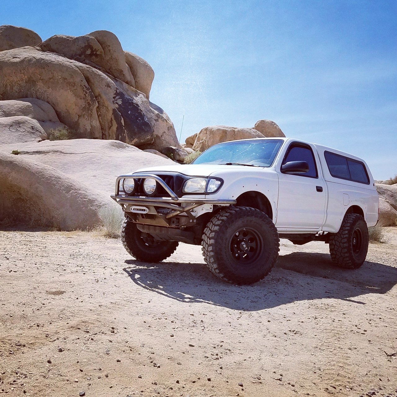

    Engine:
    • LCE Supercharger
    • 2.2 Supercharger Pulley *Around 10lbs of boost*
    • AEM Methanol Injection
    • Volant Intake
    • LCE Headers
    • 3" Full Exhaust w/Cherry Bomb turbo style muffler
    Transmission:
    • Factory W59
    • Inchworm Crawl Box
    • Factory transfer case
    • RAD Triple Stick
    • LCE Short Shift kit
    Front 12" overall wheel travel:
    • MCM 3.5" long travel
    • King 8" 2.5 remote reservoir coilovers
    • OEM Toyota Lower Ball Joint base converted to Uniball
    • OEM Toyota tie rod ends
    • Total Chaos coil bucket gussets
    • Total Chaos cam tabs
    • Total Chaos spindle gussets
    • ARB air locker w/5.29s gears
    Rear ~12" overall travel:
    • All Pro Expo leaf pack with Dakar leaf added
    • 2.5 X 16" King piggyback shocks (oversized, but found for a good deal)
    • 2.5 X 2.5 King hydro bumps
    • '04 Tundra axle with Trail Gear truss
    • Total Chaos shackles welded above frame
    • ARB air locker w/5.29 gears
    COMING SOON
    ***Giant Motorsports 64" leaf pack along with their Solid Shock Co Bypass shocks to push around 20" of rear travel***
    Body:
    • 1 Inch 4crawler body lift with poly bushings, larger pucks, and upgraded hardware.
    Tires & Rims:
    • 38X13.50X17 Patagonia Milestar M/T
    • 17" Trail Ready Beadlocks
    Lighting Up Front:
    • Osram Night-Breakers w/upgraded headlight harness
    • LED switchback corner lights.
    • Two Hella Rallye 4000 with euro driving beams
    • Two Rigid fogs in probably not the most ideal place
    • Ebay 42" curved light bar
    • Green/white dust strobes
    Lighting In The Rear:
    • Taillights are all over-sized LED
    • Amber/white dust strobe lights
    Armor:
    • Trail Gear front bumper
    • Skid-Row Offroad front skid plate
    • Marlin Crawler rear bumper
    • Bash Fab sliders
    • Trail Gear crossmember
    Recovery:
    • Warn VR8 winch
    • Traction boards from Amazon
    • Safe Jack hydraulic bottle
    • Crosby Shackles
    • Foldable Shovel
    • Ready Welder II
    Electronics:
    • 12V Guy switches
    • Autozone AGM batter under the bed
    • High output alternator
    • Two Viair Compressors
    Some great people to work with-
    Robert Otwell Fabricator of Otwell Welding and Fabrication.
    Otwellfab@gmail.com
    Chad Gardner Fabricator of BashFab.
    Bashfabrication@hotmail.com
    Trail Gear Vendor for going above and beyond on help with specialty parts.
    sales@trail-gear.com
    Paul James for Tundra and other Toyota swap parts located in Irwindale area
    rpauljames.rpj@gmail.com
    For Builder Parts Check out:
    Ruffstuff Specialties
    https://www.ruffstuffspecialties.com
    Poly Performance
    https://www.polyperformance.com

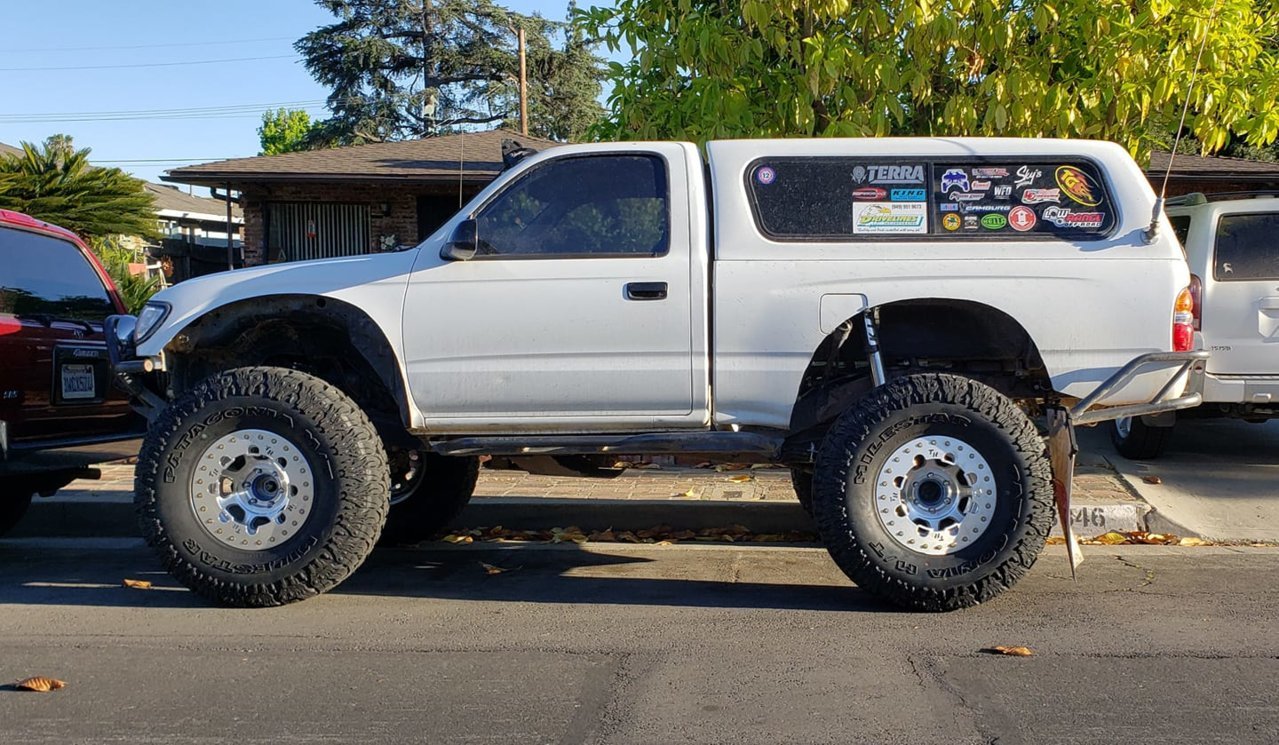

    Front end parts are still in the works for the 4X4 Swap.
    But got a shell yesterday! Needs paint for sure, but I'm happy about it. Will be nice having the extra secured space on the regular cab.

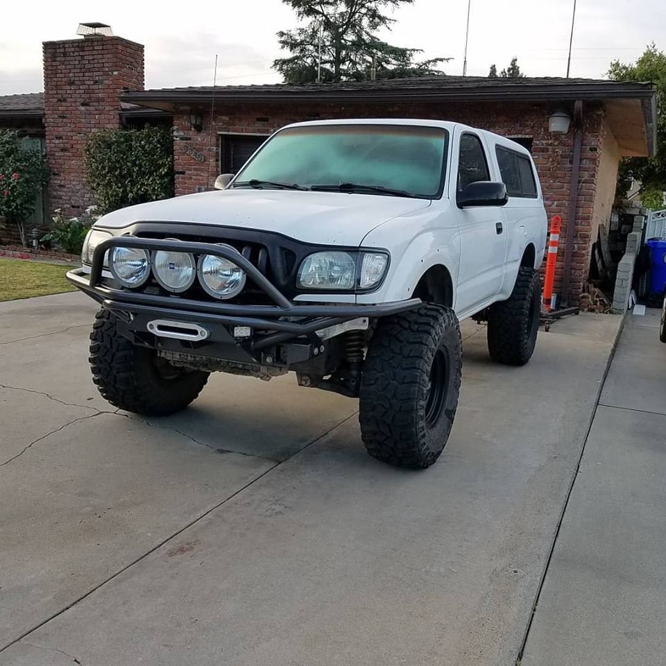

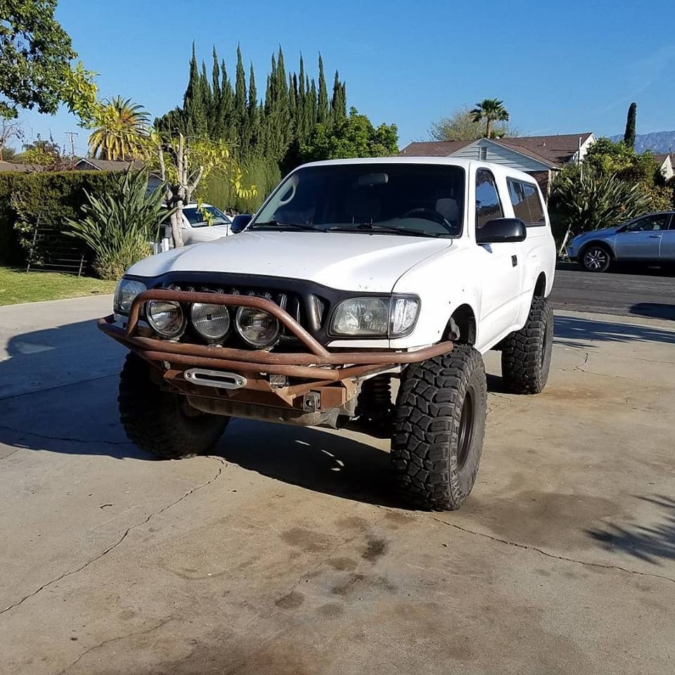

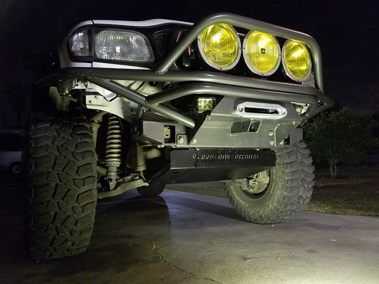

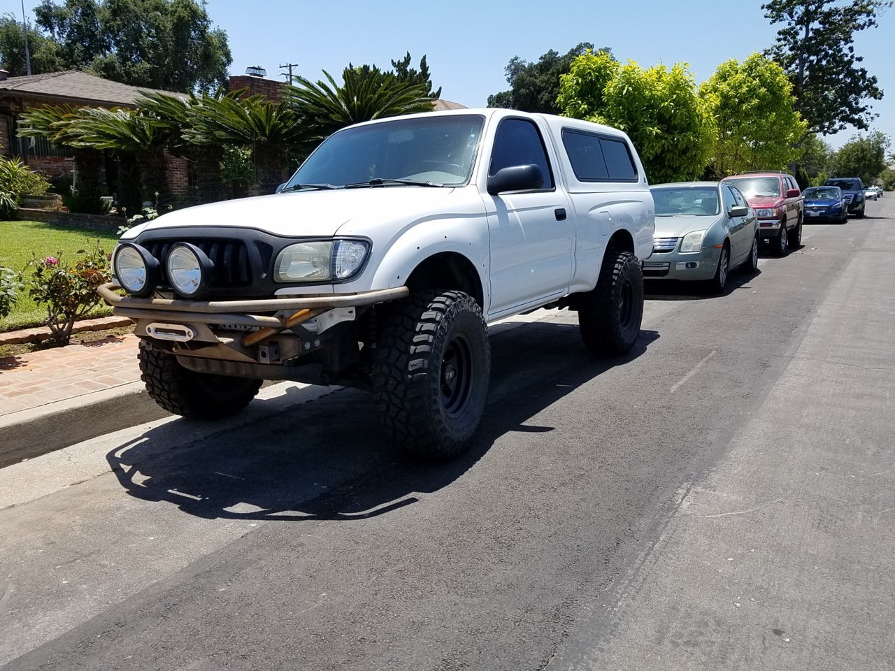

    Evolution of the front bumper. It is finished now! I am most likely going with a skid-row skid plate soon because my stock one is kinda trashed. Since I am bit armored up now, I am have finally decided to regear to 5.29s. Going with ARB air-locker in the rear. Will share the details of the onboard air setup in a couple weeks! I think she's finally ready for a proper beating!

    Great looking little truck. Good call with the 5.29s. They really give the 3rz some much needed guts.
    Subscribed!
    Ritchie likes this.

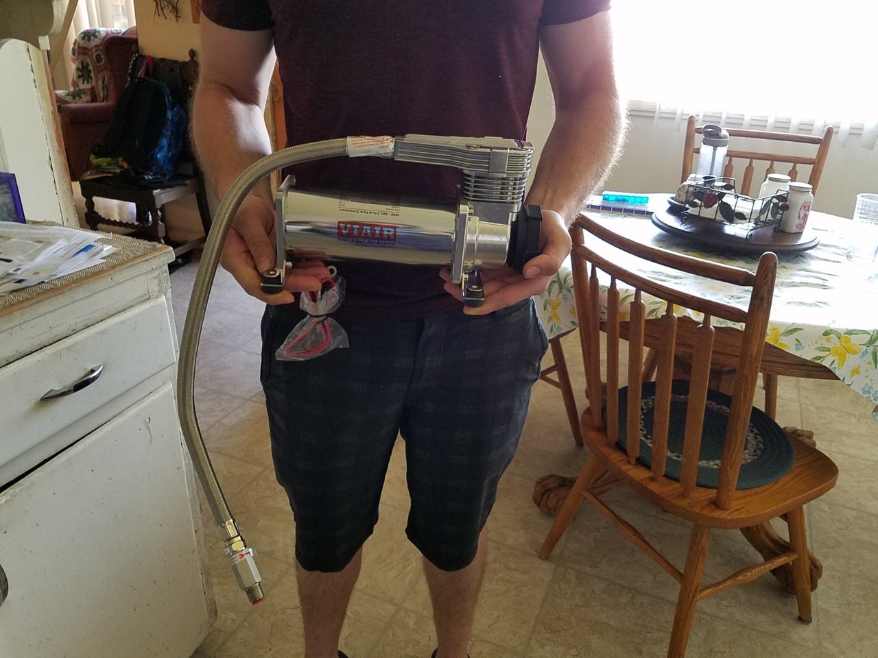

    Just arrived in the mail yesterday...it is HUGE!! Viair 485C Gen II

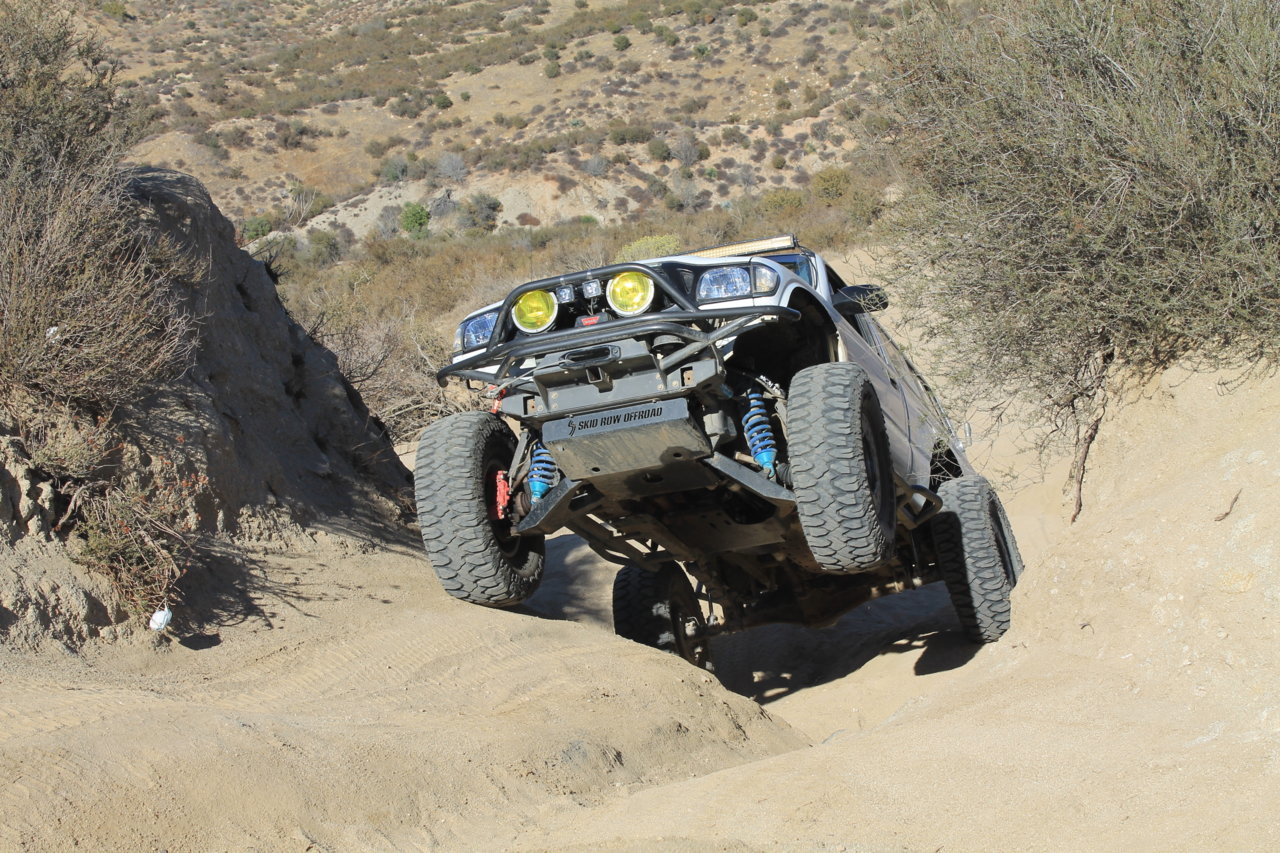

    Mmm... Parts! Skid Row Offroad Skid Plate arrived and put it on at midnight when I got home. My stock mud guard/skid was a bit tacoed from high centering and hitting rocks. This should do the trick. The weight of this skid inspires confidents to just send it up something now and not worry about my radiator.

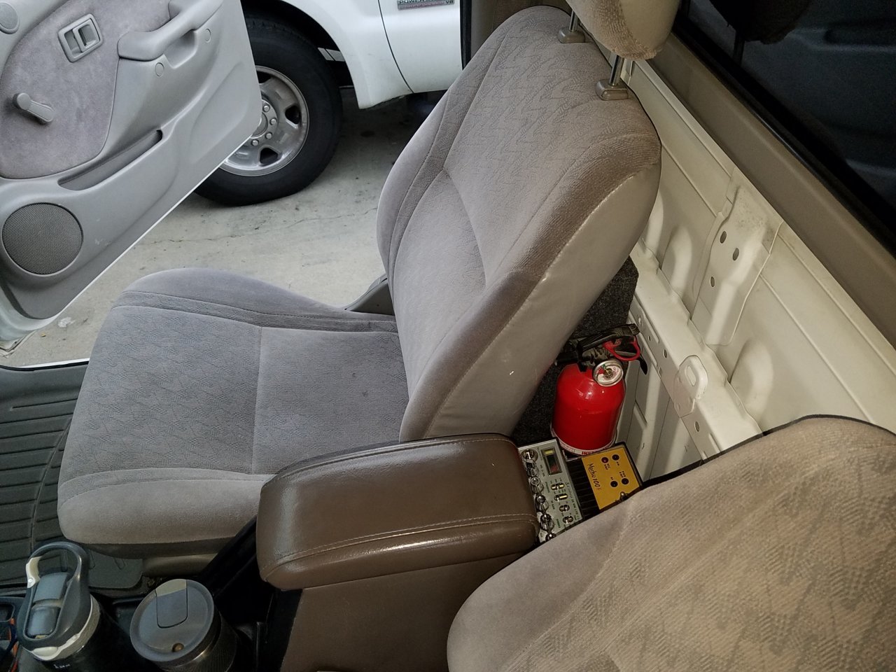

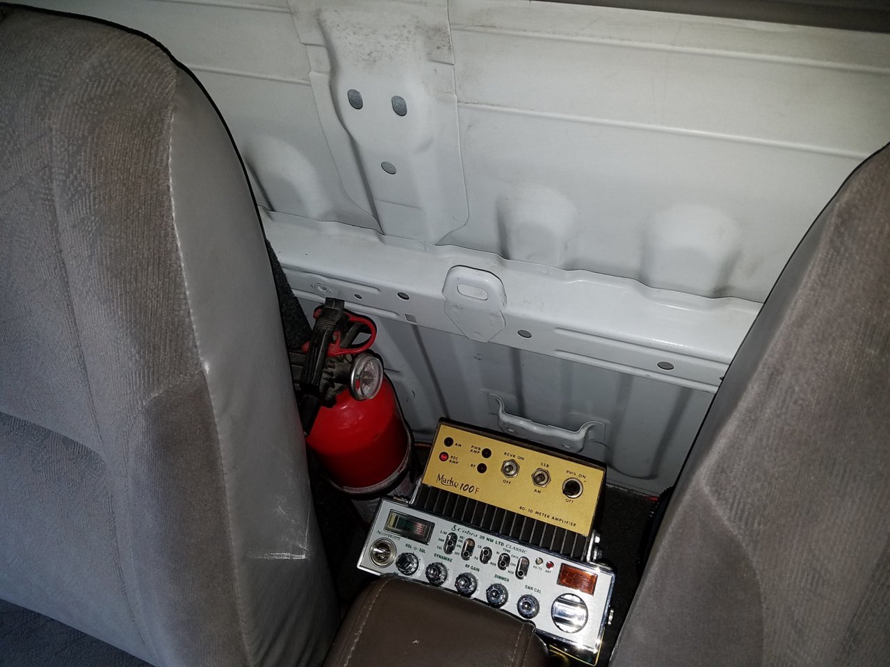

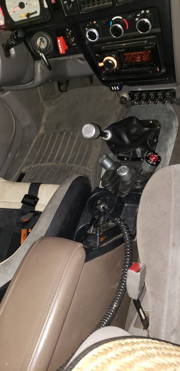

    CB and amp install came out pretty clean! Since the console is from a 4runner with the parking brake in it, I'm going to stick a HAM in there since it is an empty slot on a Tacoma.

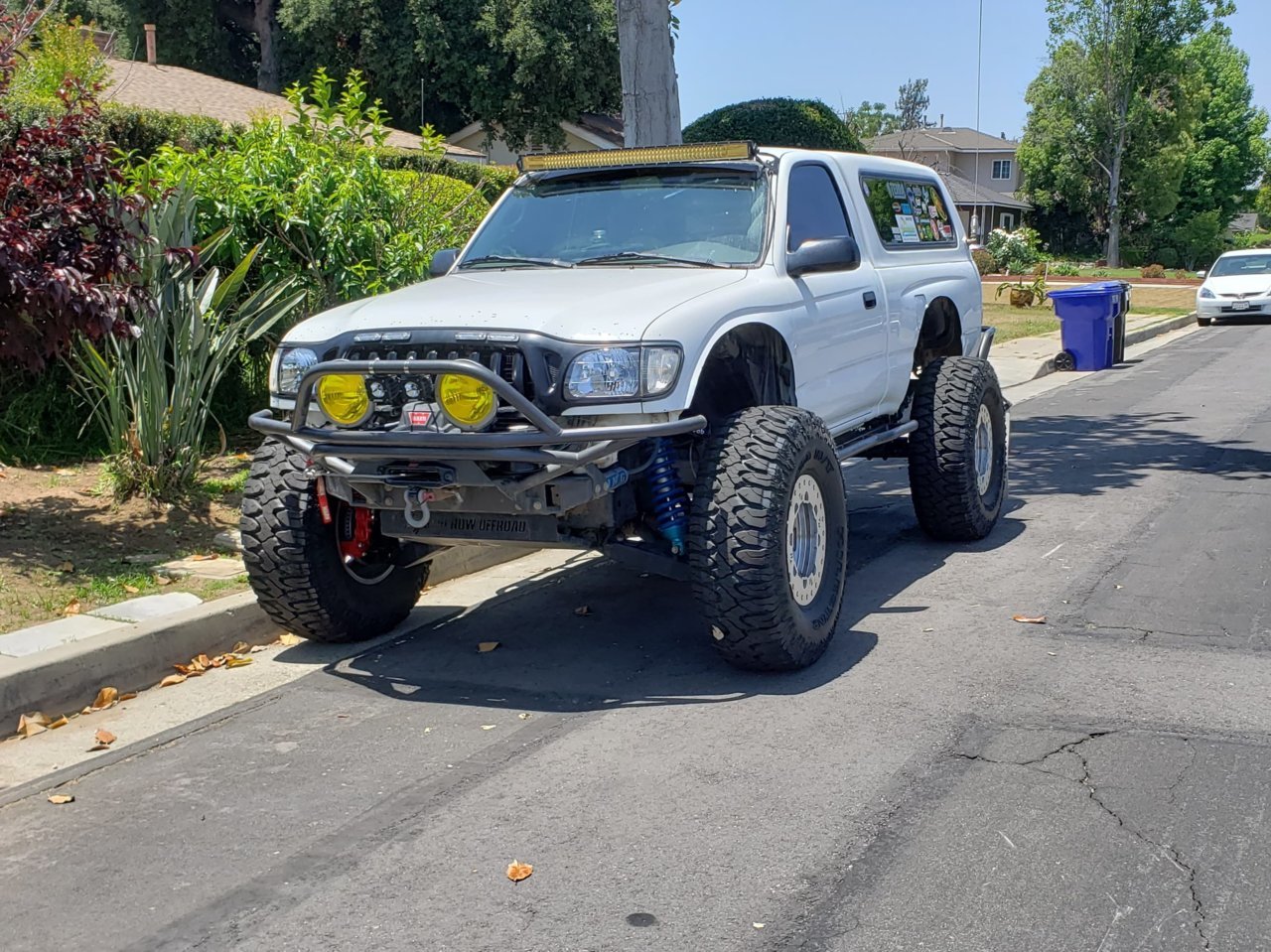

    2002 Regular Cab

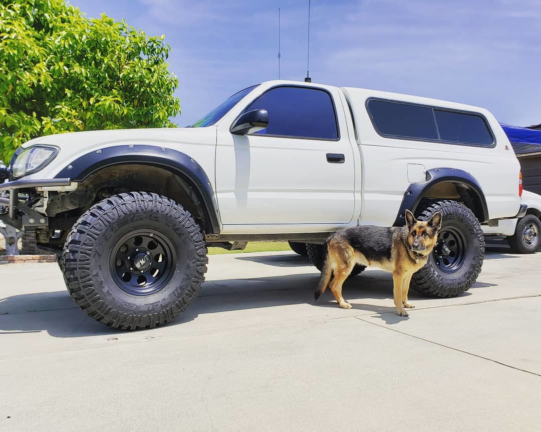

    Soooo uhm... 35s just happened :p

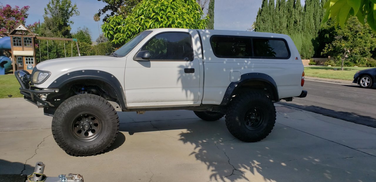

    Hahahaha I am catching up on throwing parts at her that I've had for a while and finally getting to do. I hope you've made progress on your tranny!
    Recently did 1.25 Spidertrax spacers and I completely clear the frame at lock. It also put the wheels at a much better spot for tubbing the firewall when the time comes.
    Did a 1" 4crawler body lift with poly bushings and the truck feels amazing and gave me better clearance for the tires.
    Moved the rear axle back 3/4" centering the tires in the wells (less trimming to come).
    Just rebuilt my coilovers and got my springrate dialed in at 550lb coils with 7.5wt oil. No more body roll and she rides amazing.
    I have been keeping my eyes out for a used 5.29 gear-set but not feeling too optimistic. Soon though....soon...whatever happens.
    The 2jz truck is about ready to roll out of the garage too. You'll probably see it at the next Fiesta Island meet. Someone also gave me a cool boat. So the projects are rolling strong.
