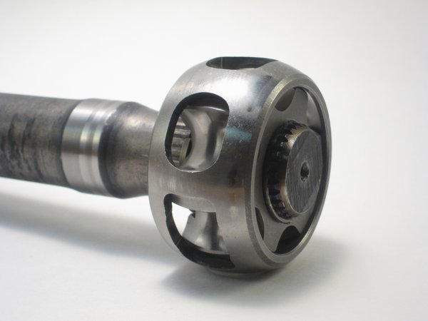

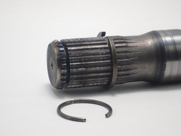

    Sorry... I forgot to attach photos of what I am going to do.
    LukeCC[QUOTED] likes this.

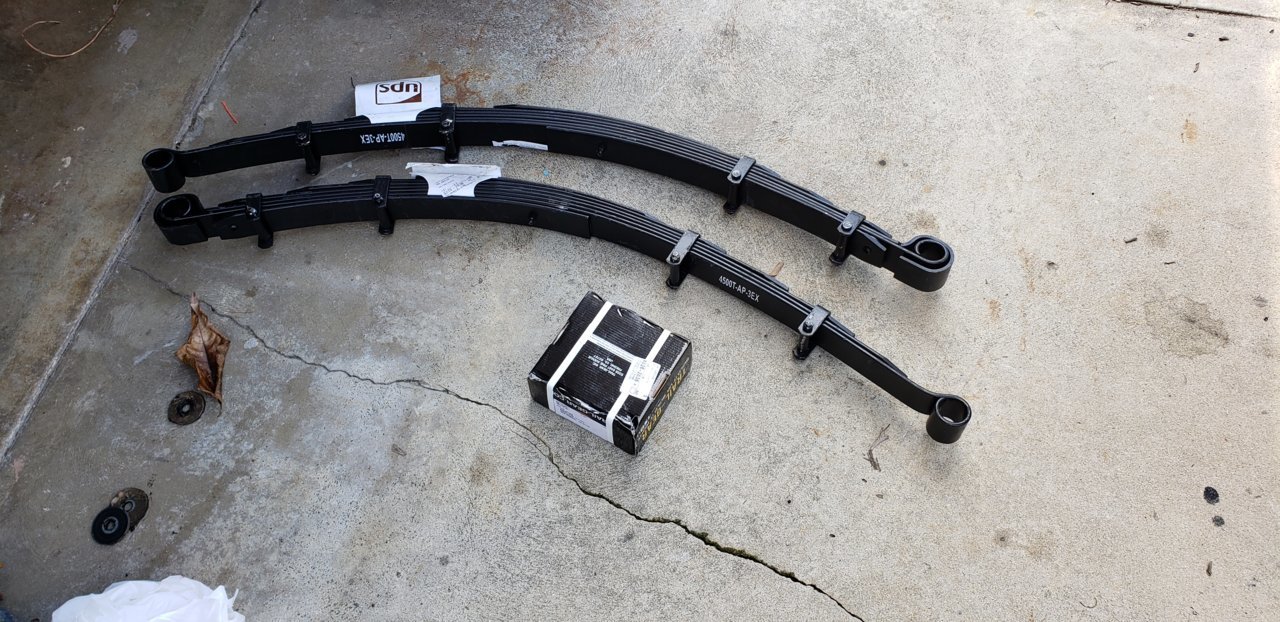

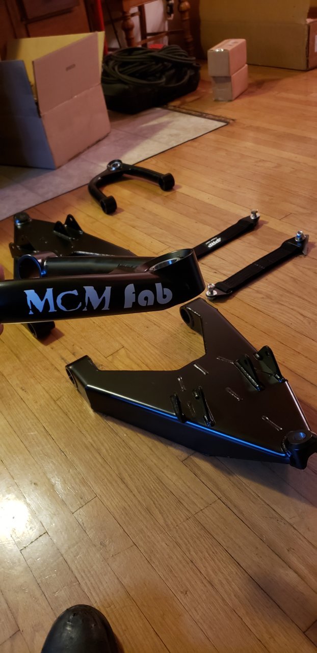

    They're here!!!frame box kit came the other day too. Bunch more still on the way!
    eccracer104 likes this.

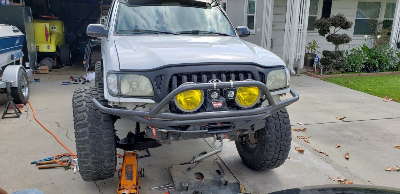

    San Gabriel
    2002 Regular Cab
  20. Apr 11, 2020 at 4:45 PM
    #200
    Tyler Lacasse
    Tyler Lacasse [OP] Well-Known Member
    Apr 3, 2013
    #101237
    795
    Tyler
    San Gabriel
    2002 Regular Cab
    Wow hello there too!
